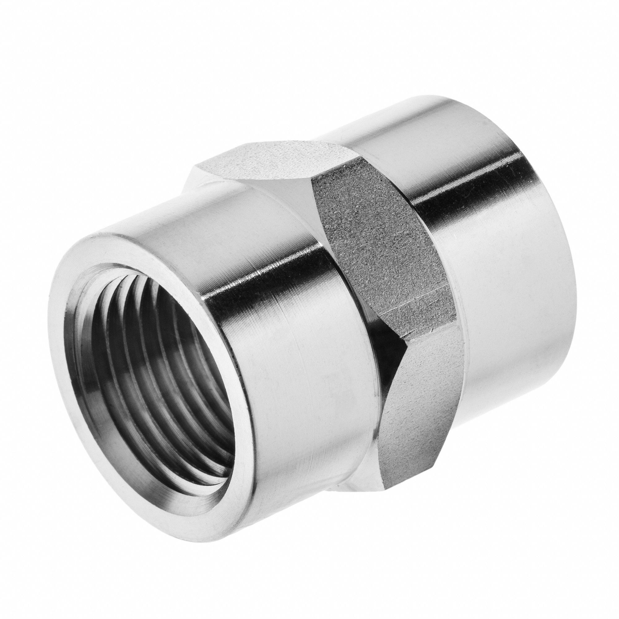

Google search 3/8" FNPT Hex Coupling broski
Thanks Dez! My Google fu is weak I guess because I was googling 3/8" double female coupler and was definitely not getting those results.
Also, $18 for a SS coupler seems like highway robbery.
