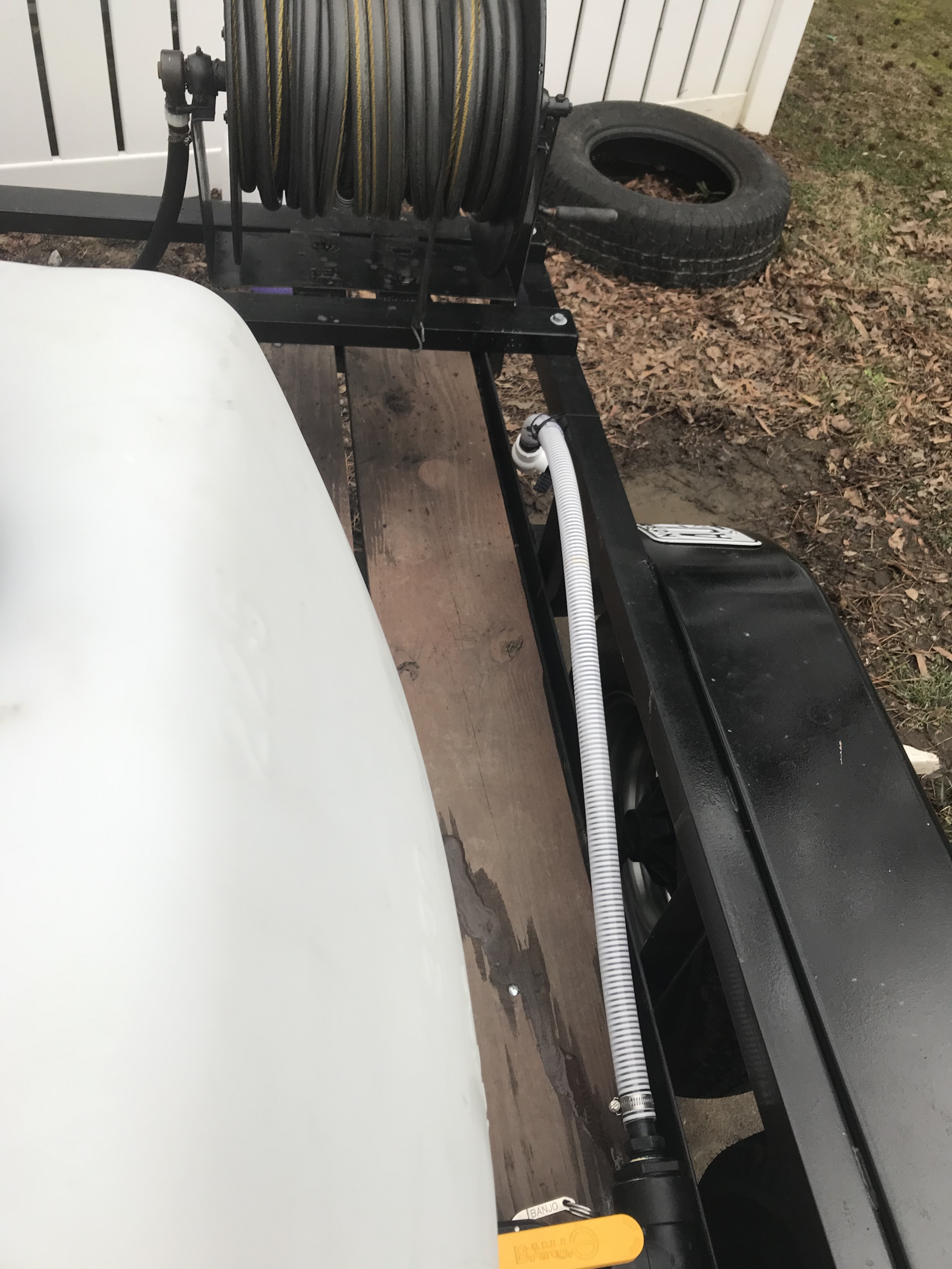

Uploading: 317DA346-A31F-46A5-8720-0E5CE7BC21BB.jpeg…
Here is my setup. It’s still new and I’m not sure how it’s gonna work long term, but I like it. The 2 inch banjo valve off the tank has a quick connect so I can dump lots of water fast. And I have a hose running out the back for bucket filling, hand washing or whatever. I also use the ball valve at the back with an adaptor I made for pulling antifreeze in my pump.
The other way (front of trailer) runs into the filter then machine. I used 1inch ntp with barbs to connect them.
Where did you get that T? looks like exactly what I need
I bought all of the fittings from an agricultural supply company. Any large ag supplier should have all the fittings you could need. Tractor supply may have them but i doubt it.
What is that fitting called that camlocks to the bulkhead fitting and comes out to a T? See If i can search for it and find it, or If you have a link that would be cool.
I’m not exactly sure what it’s specifically called other than a quick connect coupler.
Here is an example. However I suggest find a store and put them together so you can get exactly what you need. Also get some spare plugs, barbed fittings and pipe dope.
