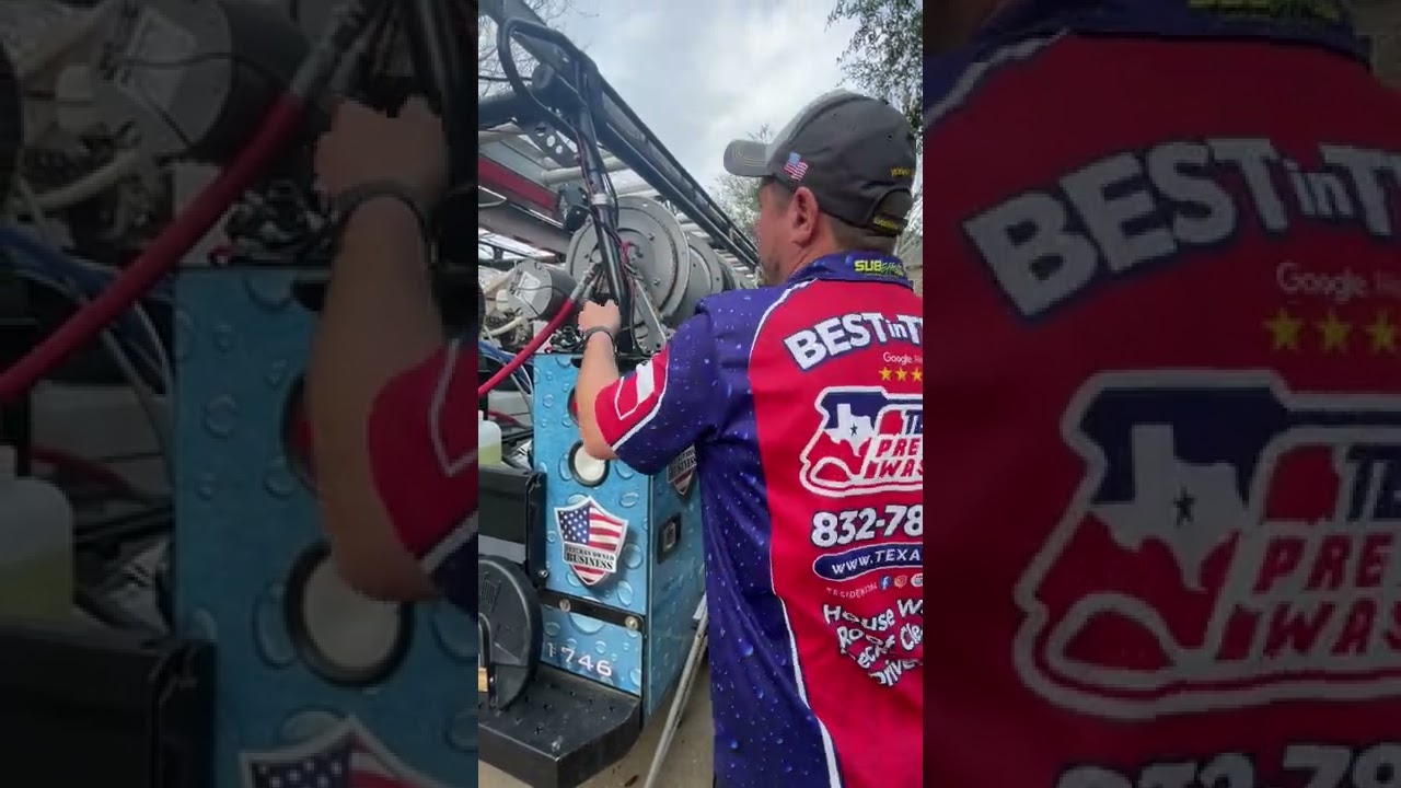

It’s a called a Hub Assembly. $90 1/2" Hub Assembly (1520 Model) – Sprayer Depot
Video walkthrough on how to replace.
@Clean_Blue don’t get to excited. That’s a video of swapping a drum, not the pipe and riser
But still a good video if someone needs to swap drums
Watch the video. You’re wrong.
The pipe and riser are called “Hub Assembly” by Hannay. We’ve replaced a few.
I agree Hannay does have good service. @Clean_Blue contact them. They’ll want the info off the reel plate. Warranty is typically 12 months. I’ve had them warranty a hub assembly and then also not replace one.
Lol, but were it that easy. I guess Hannay has slipped in quality if the Texas guy has had to replace several drums in only a couple years of being in business. The video doesn’t show taking the drum apart and replacing hub pipe and riser, but if he’s got a secret contact that is selling the whole drum for $95 then I’m all in.
