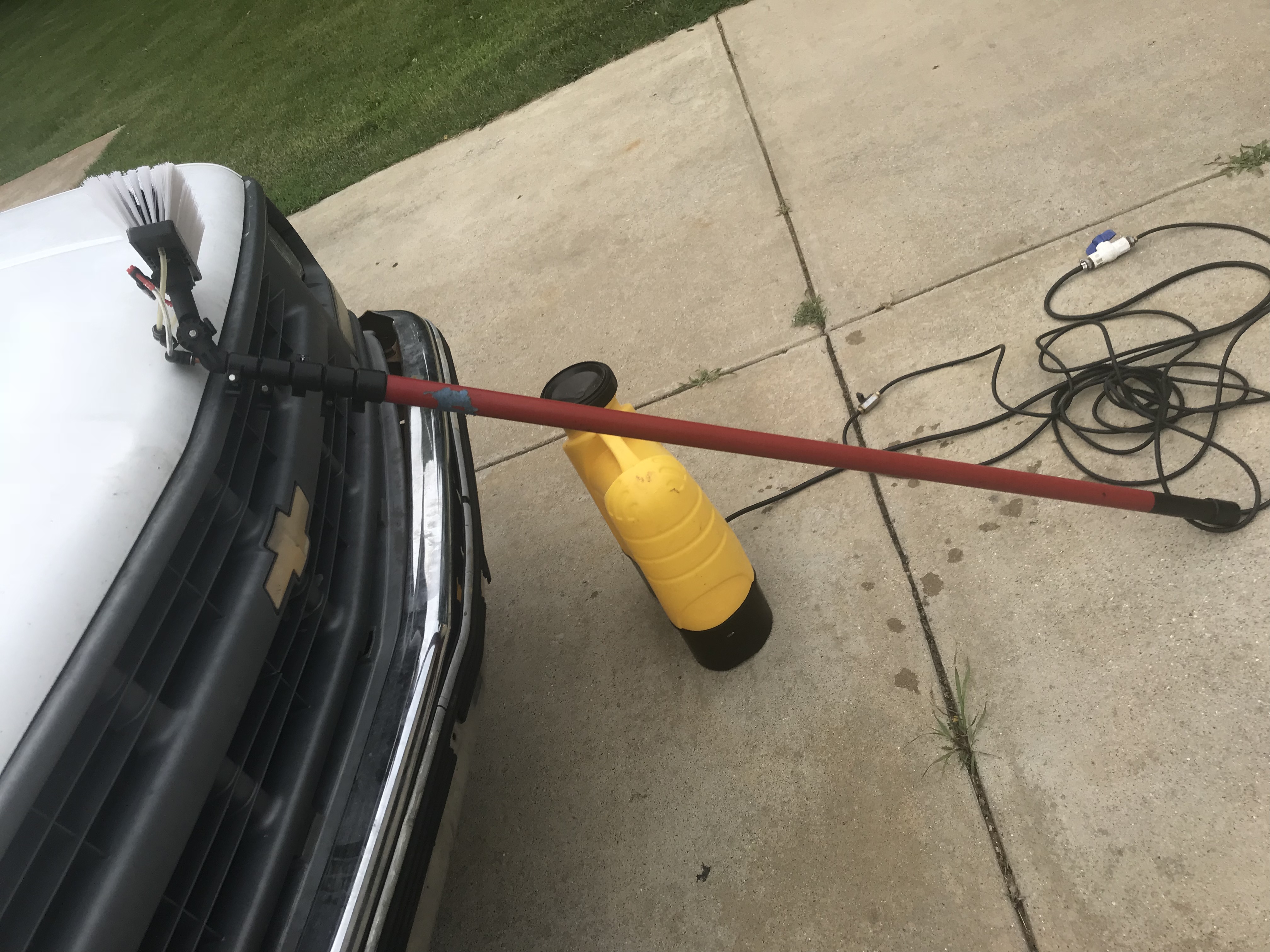

Hudson 4 gallon electric back sprayer off amazon $120. (Some bad reviews, I’ve used the crap out of myne for 2 years with zero issues)

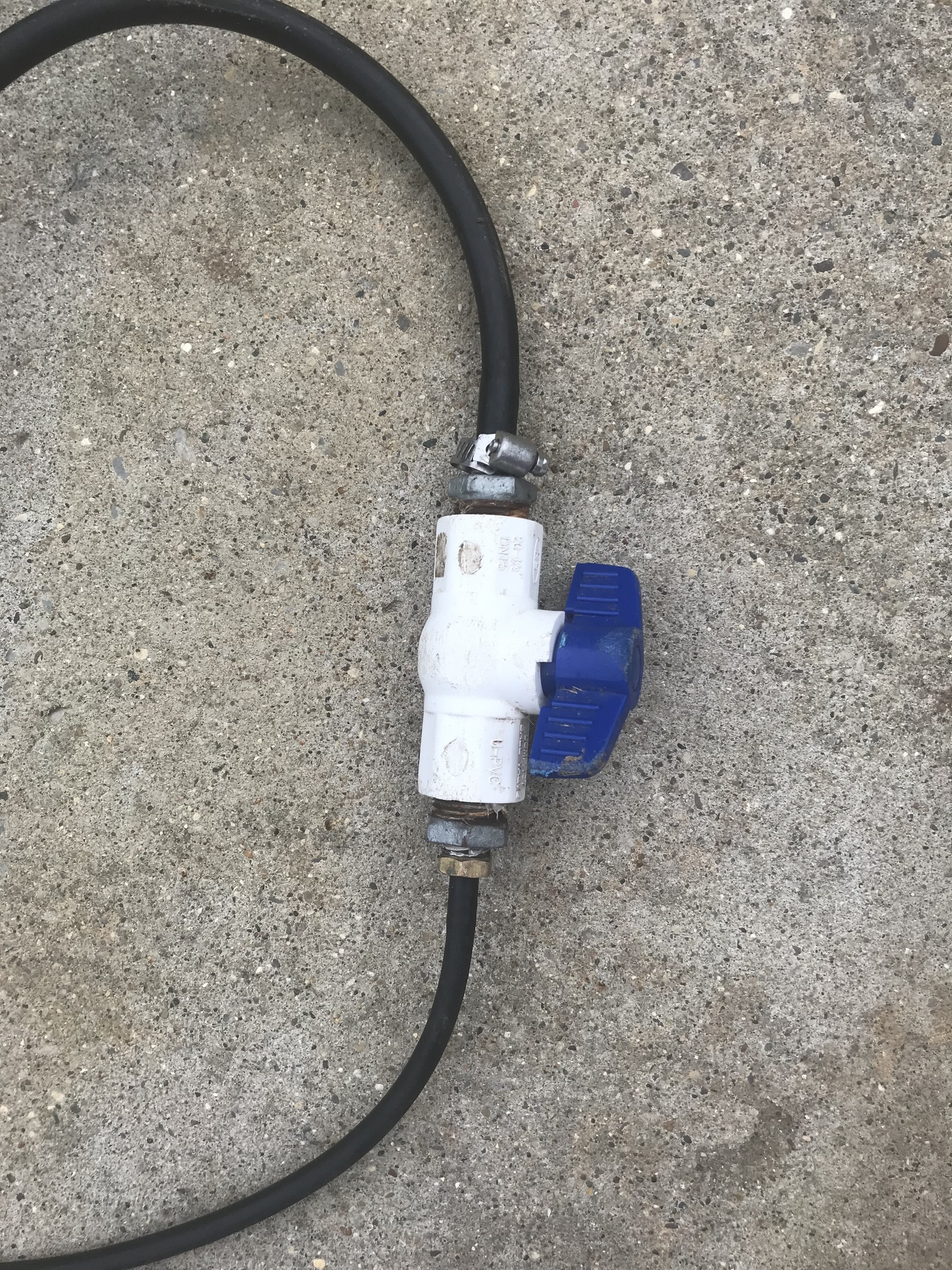

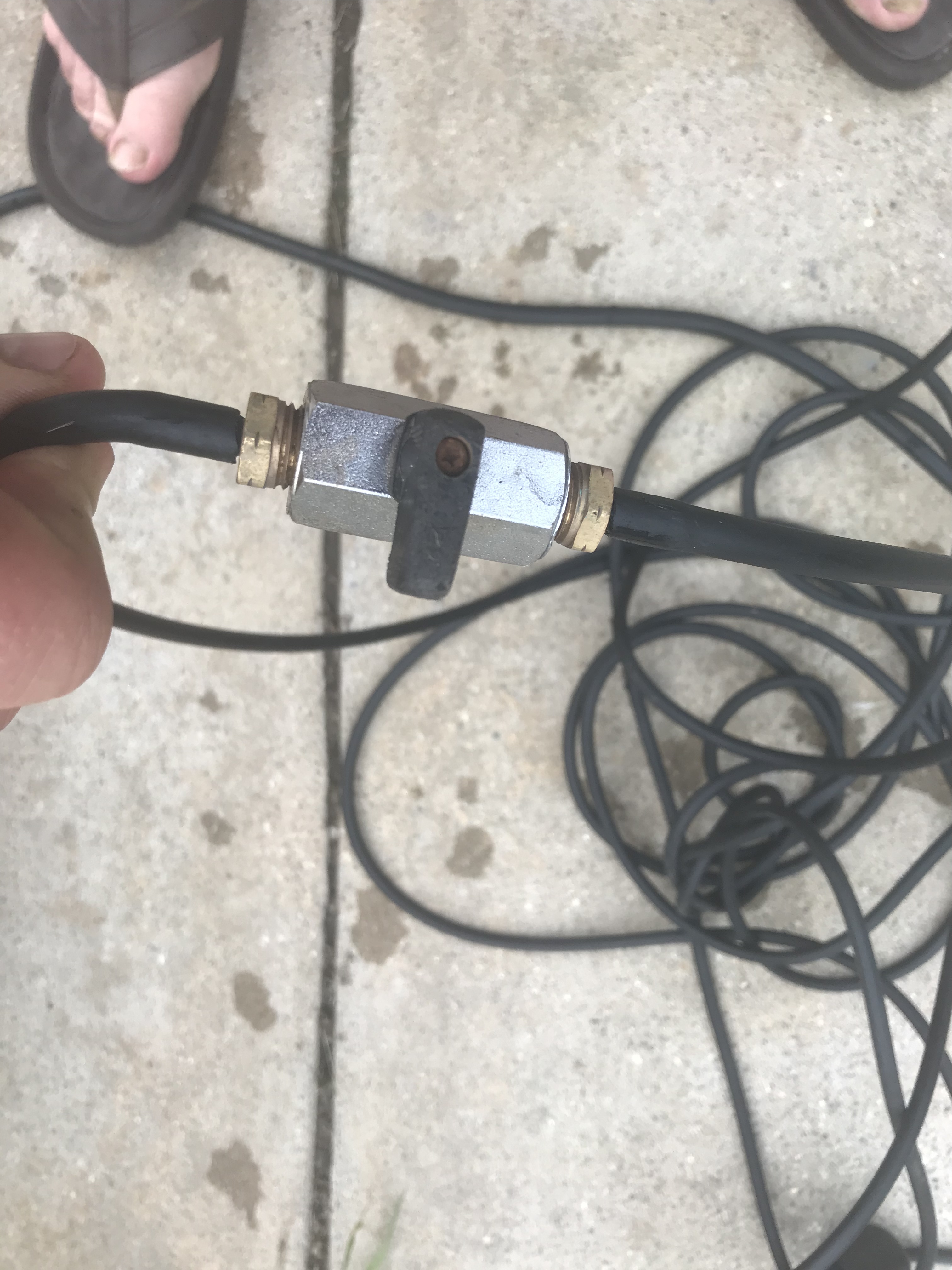

Call J Racenstein and tell them you are using a Hudson backpack and they will know exactly what fittings you need. Also get the small silver ball valve from them…order two (Instead of the big white one I have that connects the wfp hose to the back pack sprayer hose)
The Hudson hose and WFP hose are different size… I can’t remember off the top of my head but if you call them they will know exactly what barbs you need.
DI water can be achieved different ways…one way is distillation. You can literally buy distilled water from a store and use it in your WFP. Distilled water has a TDS of zero. On an average home I’ll use 10-14 gallons of water.
I also use the Gardner CLX 22. You can clean 99% of windows at the third level.
The small silver ball valve I have positioned in my line to be at the bottom of the pole when fully extended…I use that to control the on off
Hold on a sec… am I seeing this right? Are you rigging a backpack sprayer for a wfp? No disrespect, please explain. WFP setups are very expensive, if you have a better solution let us know.
I definitely didn’t invent it…people have been doing it for years. Yes, it works great for me… If I went into Window Cleaning full scale I would definitely go with a better set up. But for a few houses a week as an upsell its not to bad.
