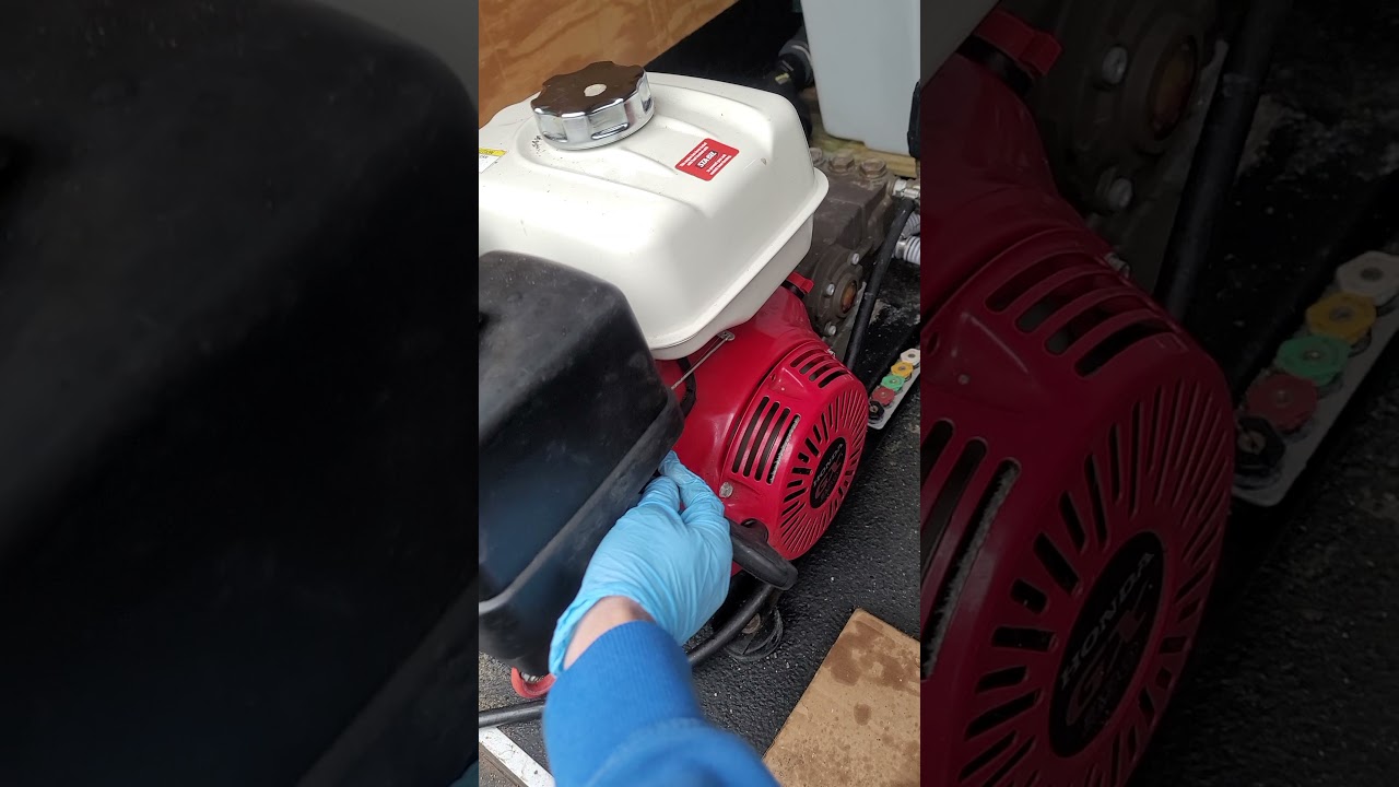

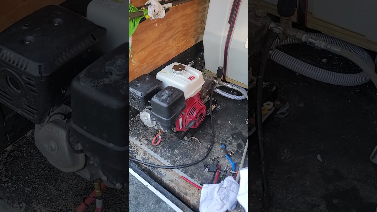

I have a gx390 2500 psi 5.5 gpm, sat all winter with antifreeze in pump, ran machine till it died out and used siphon pump to remove gas, did not get all off it out. Now as I’m getting ready to start up again I changed oil, pump oil, new spark plug, new filter. Machine would not crank over. Cleaned out carb, and she ran but really rough. Replaced with new oem carb, she sounds better and runs smoother but not like it use too run, but once I close ball valve to create pressure it dies out, and also get some back firing. I’m stump any suggestions please, I have video I’m trying to up load, I have been searching day and night for answers to this problem.
After I cleaned carb out
New carb, sounds better but not there yet,
If I close ball valve for pressure dies out, I did get high pressure for a good minute she back fired, and wanted to die out, open ball valve and it stayed on.
