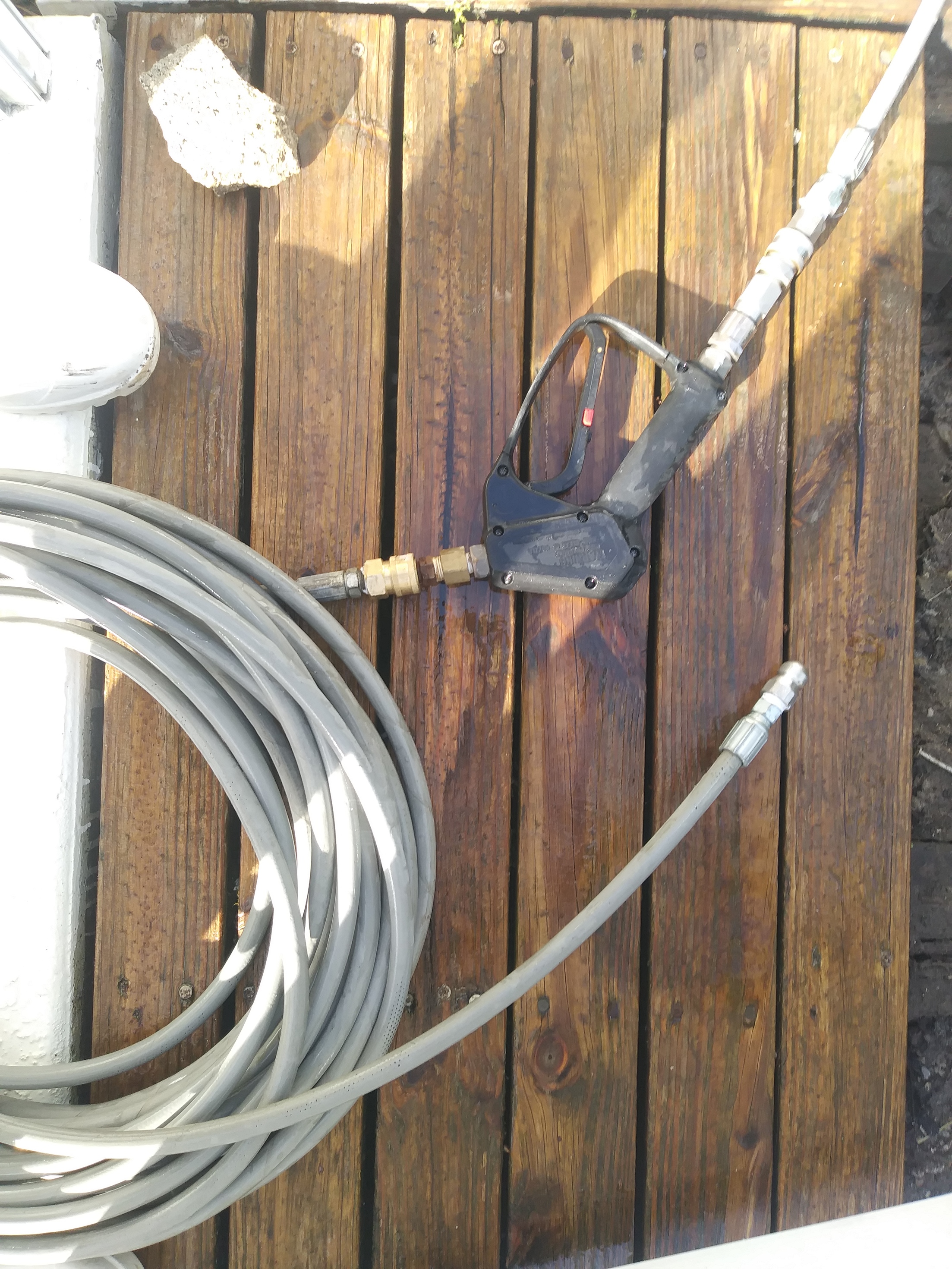

Is that 1/4 hose or did you use a reducer to use 3/8 on the nozzle of the gun?
That’s 3/8 hose
Looks good. That’s what I was thinking of doing. I’m adding it to my shopping cart now.
this fitting then 3/8 QC with the 3/8 sewer jet nozzle on the end.
