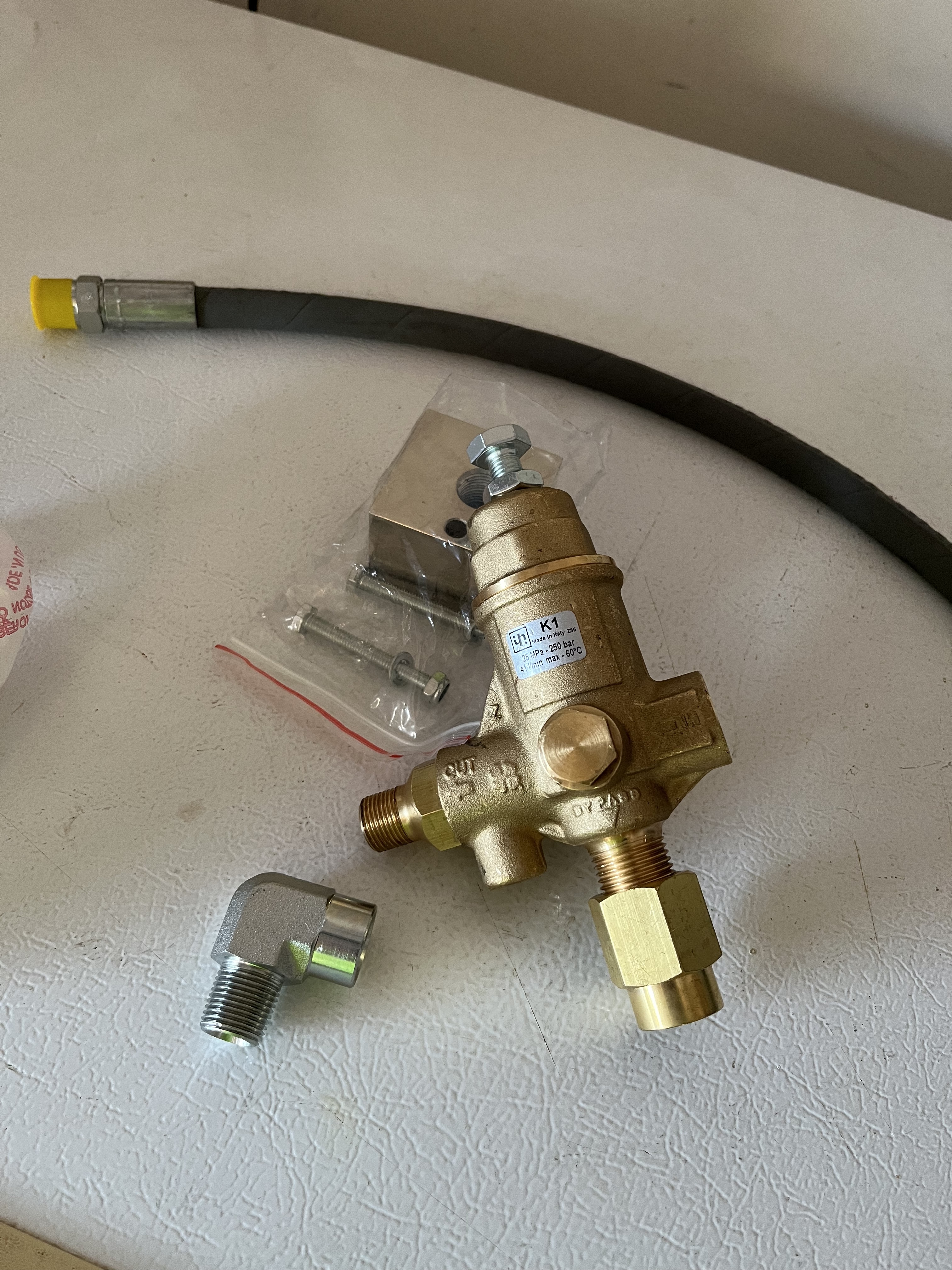

Thought I’d go ahead and start a new topic.
Finally got over to Southside and Russ hooked me up with this.
I noticed it says ‘K1’ and asked him if he had the ZK1, he said it’s the same thing. Is this what I need?

It’s the same, when I was looking at them I think I read the difference was between US/Europe using “Z” or not but virtually identical for every other spec. The only thing I wish I would have realized/thought about is that you can get them with 1/2 or 3/8 outlet which would have reduced the number of adapters and potential leak points but it’s been fine so far.

The correct model names are ZK1, ZK5 etc. It’s often abbreviated to K1, K5 etc. The 3/8 ZK1 is model ZK138
Not a peep on my end. You can be the first ![]()
I’m not saying you’re wrong… but Interpump the maker of the unloader calls it the K1. Stateside GP brands them as the ZK1… but if you look at the embossing on any of them, regardless of what it was called from the seller when you bought it, it says “Interpump made in Italy” (mine even has a sticker that says “K1” on it) but yes, they are both the same apart from the option for 1/2" or 3/8" outlet which is available in either naming. Are the two companies tied together, GP a subsidiary of Interpump Group? Would make sense, but they are branded and marketed to different regions under different names. Which is where a lot of the confusion comes in when trying to figure out which one to buy and why.
