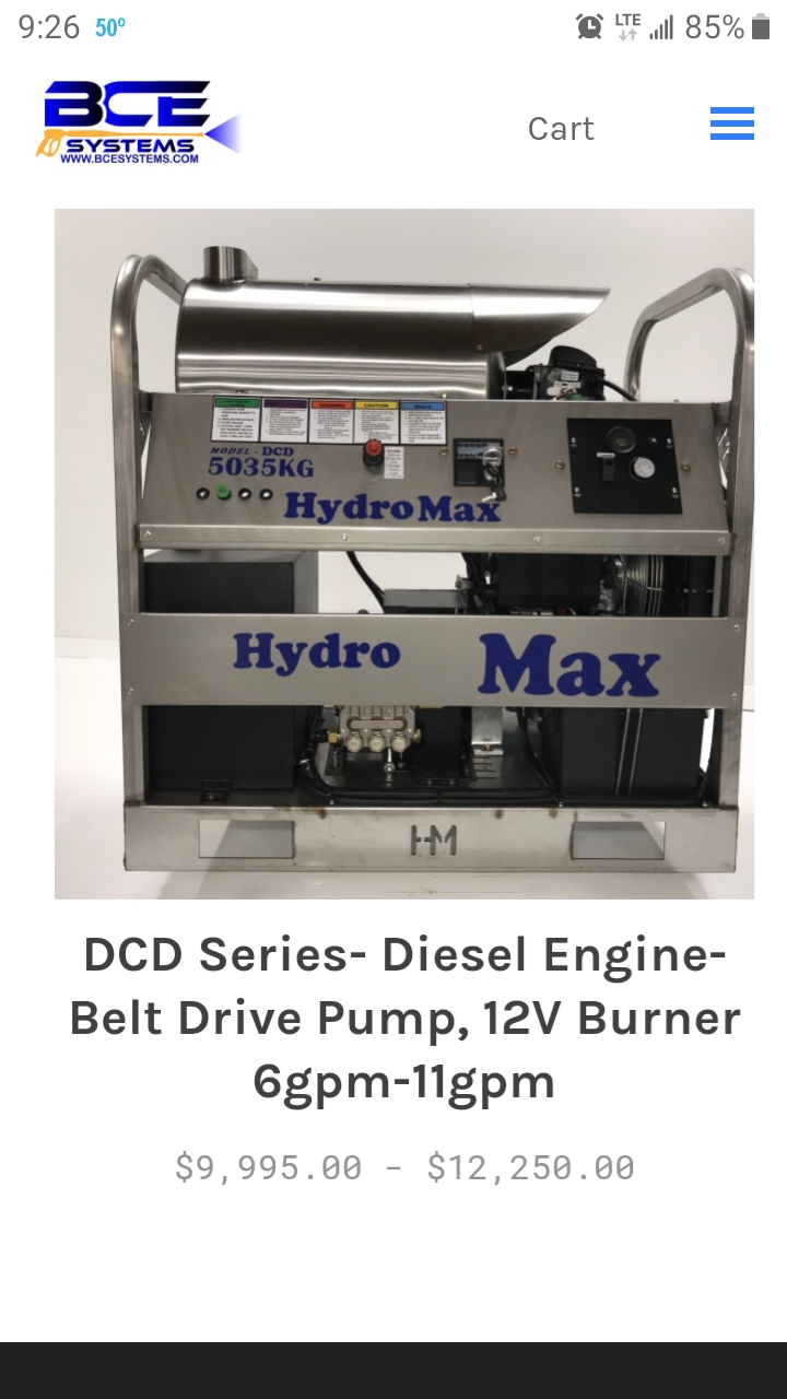

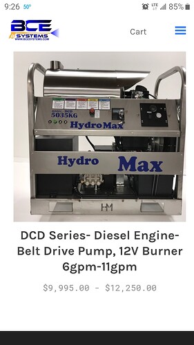

I’m not greedy, So I’ll order just one set up but can I get it fitted with this please @MuscleMyHustle ? Thanks, you the man.
