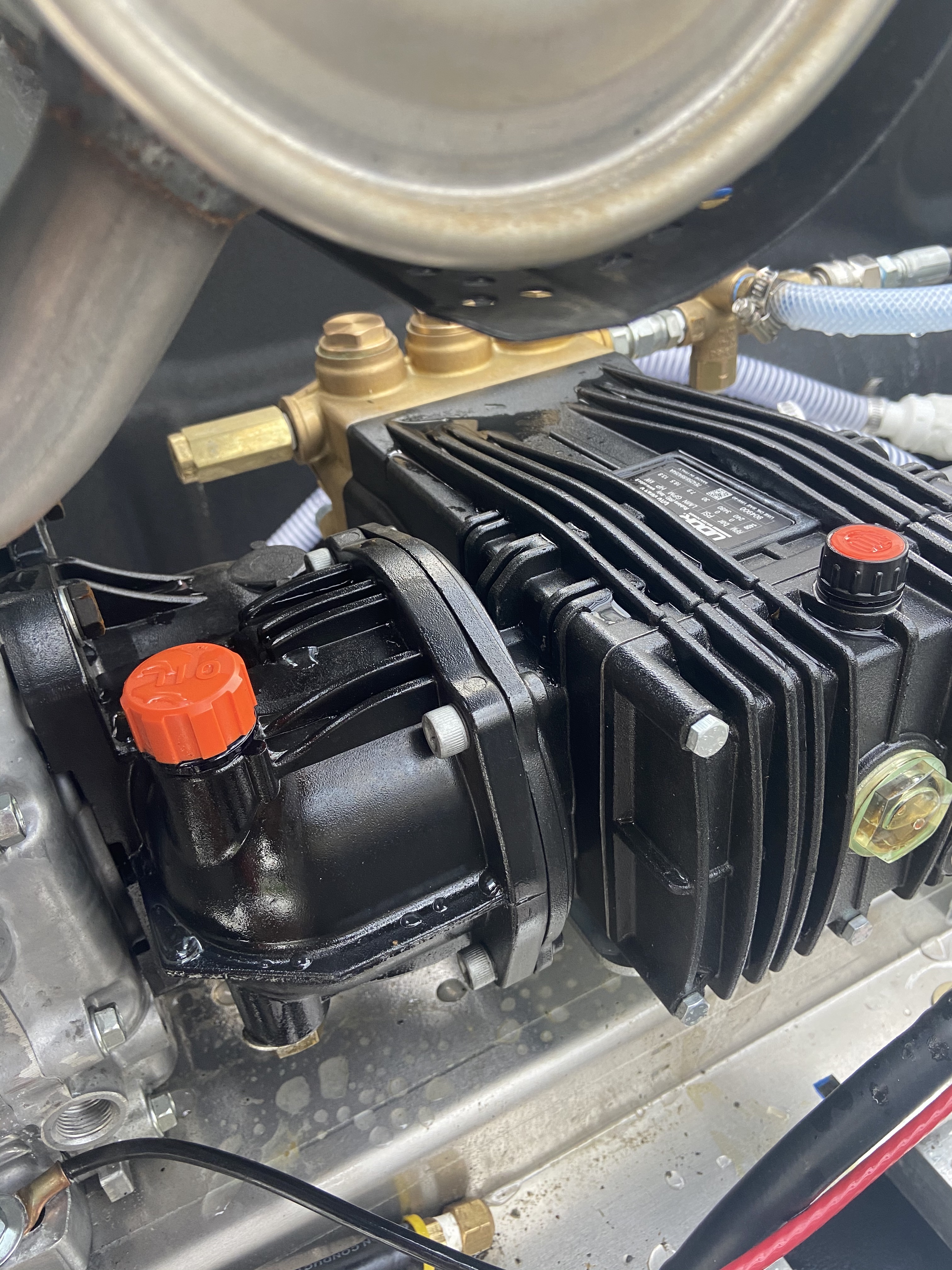

I saw somewhere that red caps are meant to be replaced… Should I replace these or are they good? Oil has been leaking from the cap of my gear box but I just tightened it as much as possible, hope that solves it.
The red caps, at least on mine, are for shipping only. You need the yellow vented ones.
Yours looks to be a different manufacturer so the other guys know better.
Anyone know where to buy the yellow ones that are correct size for my unit? Udor 8 gpm, water dragon from power wash store
Call the company you bought it from. They should have given you the correct cap too. I have red ones and yellow ones. Color is necessarily an indicator.
