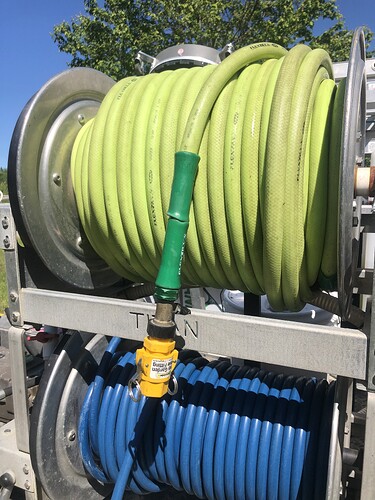

The other solution to the flattened hose is this:
Garden hose ball valve on the end of the hose, to keep some pressure in the line when you reel it up.
It also really comes in handy to eleminate a drippy hose when I need to hook up inside a garage/basement, or even a a washing machine tap.

Sounds good. Thanks for that tip.
