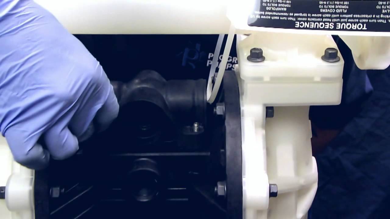

I plan on having a video of my 1" AODD pump and air compressor dedicated roof pump system on here soon. This system is capable of over 30 gpm but can be throttled down to a fine mist with no negative impact on the pump.
Can’t wait to see that! I was just researching that exact pump last night! What size (cfm & hp) compressor are you using?

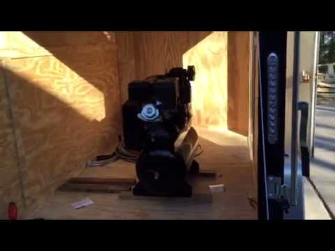

This first video is the compressor. The second video is the pump. The ac is the large Harbor Freight model. Believe it or not this unit is pretty highly rated on another forum and the price is fantastic even after buying 2 year extended replacement warranty. It is 14 hp, 30 gallon tank and about 19 cfm at 90. This thing is a beast! It puts out more air than you can imagine and with my huge 1" pump I can literally pump a 53 gallon drum dry in less than 2 minutes. Will I need this capability on most jobs? Certainly not, but when I need it I will have it and virtually nothing is out of my reach from a ladder or the ground for that matter.

It is easy to make your own drop sticks… Take some pvc pipe with a dremel tool and cut some small cuts so no trash can get to your pump. I added some 1 1/2 pac pipe over my hose to hold the drop stick down in my tank. I run a 1" AODD pump as well and i love it. It can spray about 50’ all day with out any problems
What size air compressor and tank are you using? How many cfm at 90 psi?
[MENTION=12635]ClaytonK[/MENTION] I have a Ingersoll Rand 13 HP 30 gallon @ 90 psi I have 24 cfm. I only got this one because it was a great deal otherwise I was going to get the Harbor Freight air compressor. I know a lot of roof cleaners that use them and swear by them. I run a Yamada 1" Kynar AODD pump for the last year and haven’t had one problem yet. At the end of each day i run fresh water through the whole system to flush it out even though it is a Kynar pump. Any question on setting it up feel free to ask, glad to help…
