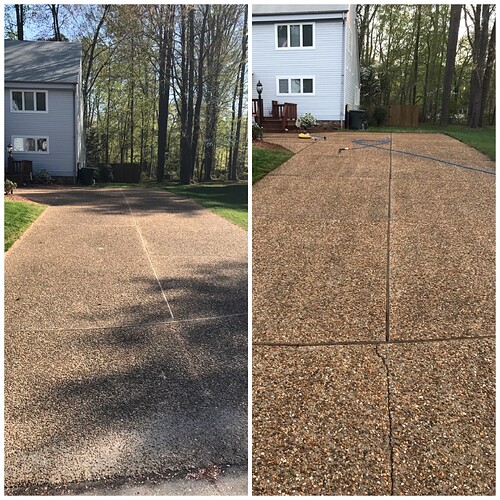

First time with surface cleaner!
Did this driveway didn’t think it came out to good look like black streaks still in the driveway … first time using my surface cleaner can u guys give
many any pointers??? Felt like I just keep moving the dirt around and the dirt would not run down the driveway

Stripes are most likely from overlap. I tend to get them if I just go in a straight line pattern too. I have found if I go in like a side to side half moon pattern I don’t get the stripes.
Post treat with roof mix and you’re good to go. With those pebble drives have to rinse pretty often while you’re cleaning, otherwise dirt just gets trapped a lot

Try to apply a foaming agent to help lift the dirt from the porous concrete. Also rinse driveway directly after surface cleaning, otherwise the dirt/debri will settle right back in the pore’s of the concrete. This will help you to save time and money.
I found from here going in full circles will cut down on the streaking,

and you clean side ways you don’t see the streaks less you standing that way…
