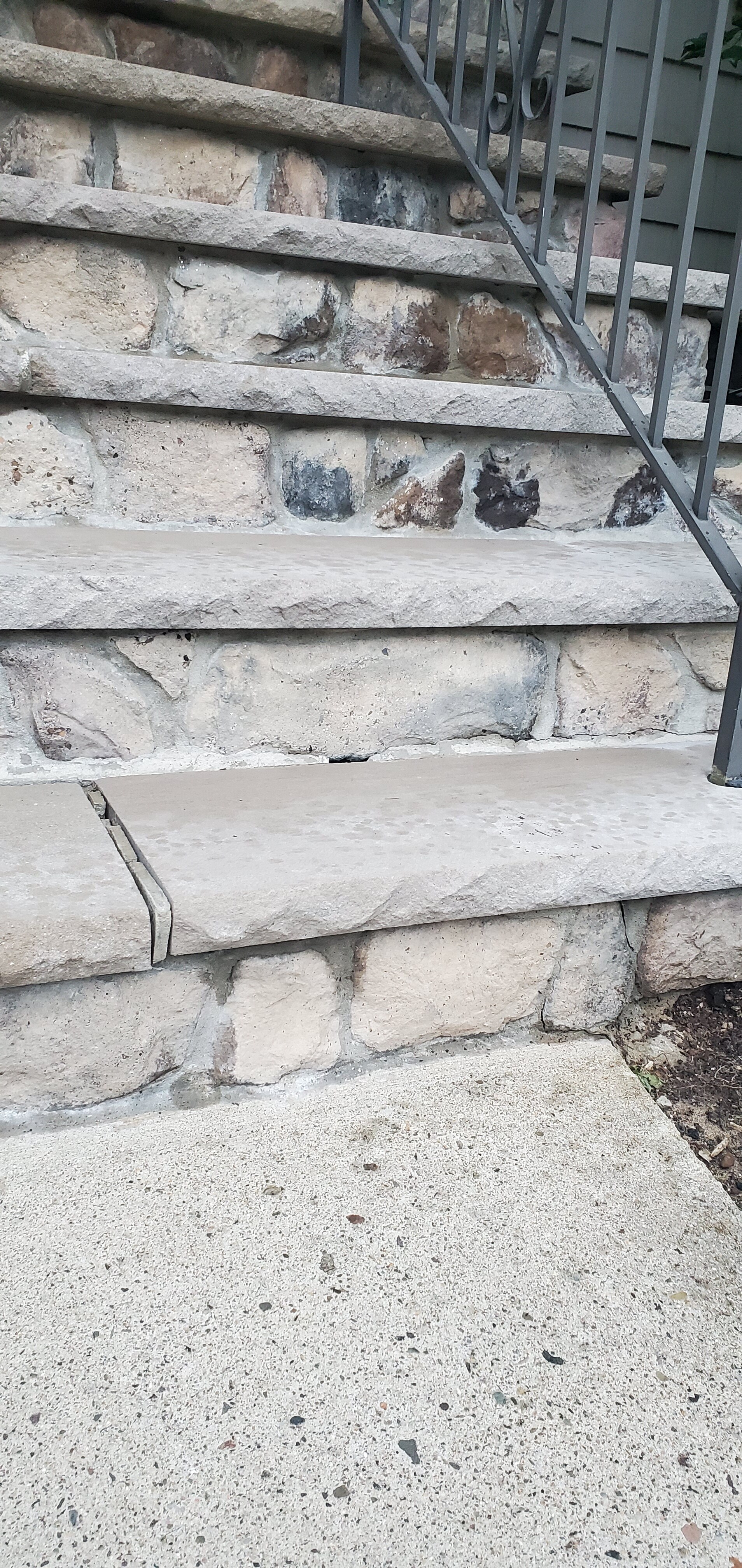

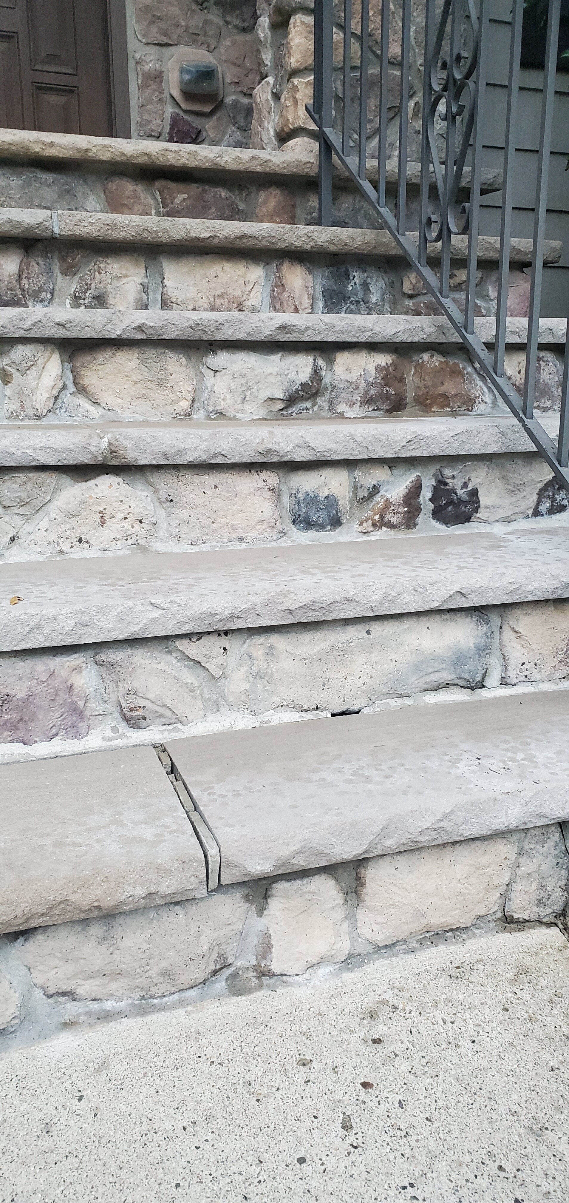

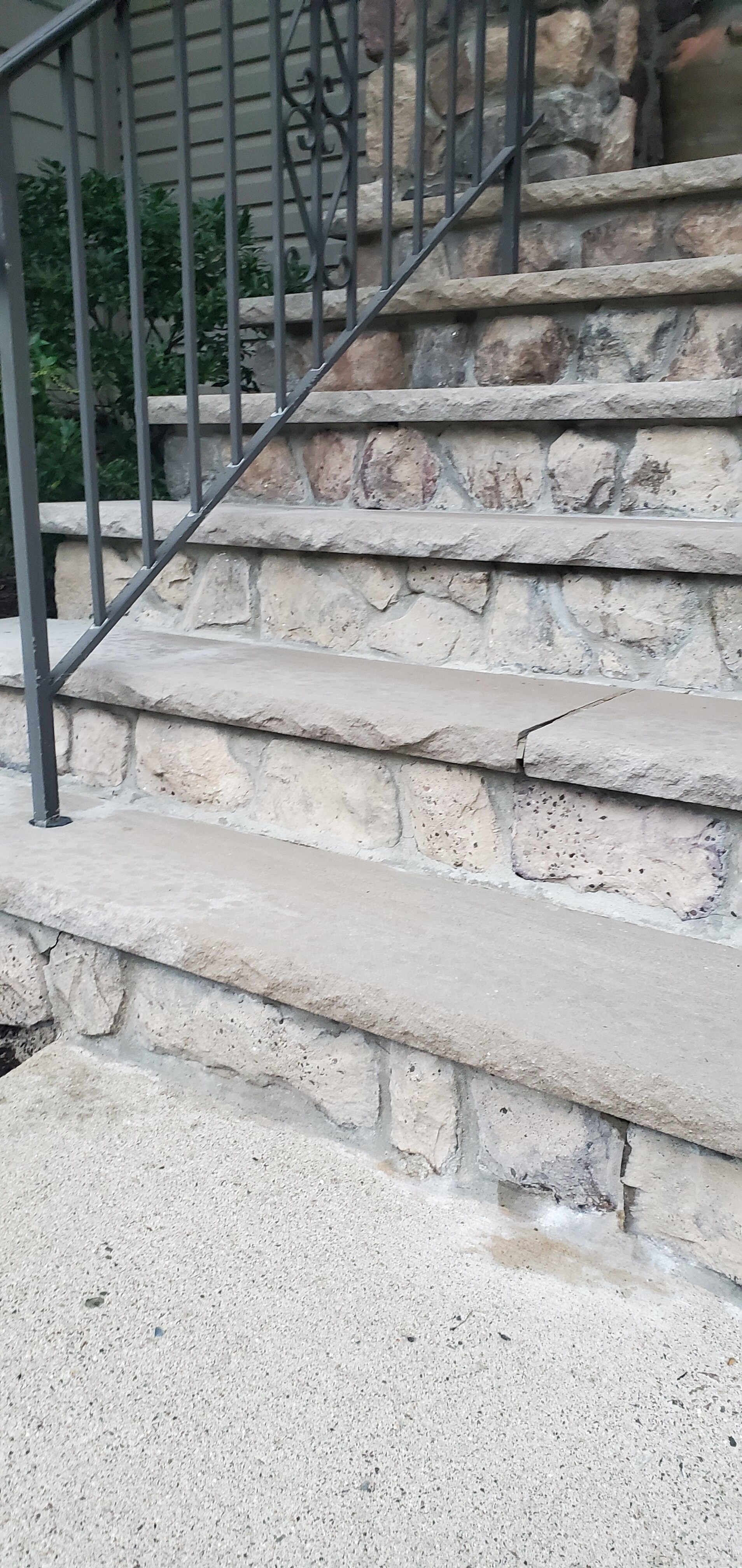

This house has this large stone enterance with the stones wrapping the house foundation and two large steps,one in the front and one in the back. I was able to take pics of the front because i did it yesterday and it’s dry now. I used a 5% mix in a pump sprayer and did the whole steps and sides. The treads are limestome. I was trying to get all the green and black out of the treads and mortar joints which it did but also whiting of the face. I have to see what the back looks like tomorrow and other parts of the foundation but the stone was very porous and I’m not sure if it’s real or fake but I’m leaning towards fake because i thought i saw some shiny specks and it just doesn’t look natural. Seems like its more of a decorative fascisa than structural but thats neither here nor there. Any testing i can do? Any ideas?

You said you sprayed 5% on the entire front steps. I’m curious why the lightened area isn’t the entire front steps area, instead of just the first few steps. It makes me wonder if something else may have contributed to the lighter color. More exposure to sunlight or weather? Just a thought.
it happened in the back steps too

I 'm just guessing here, but they seem to get lighter as you go down, thinking the excess on the higher steps may have just kept running down so they in essence got hit more than once. That was my first thought when I saw it, but as I said, just guessing, w/o being there.
