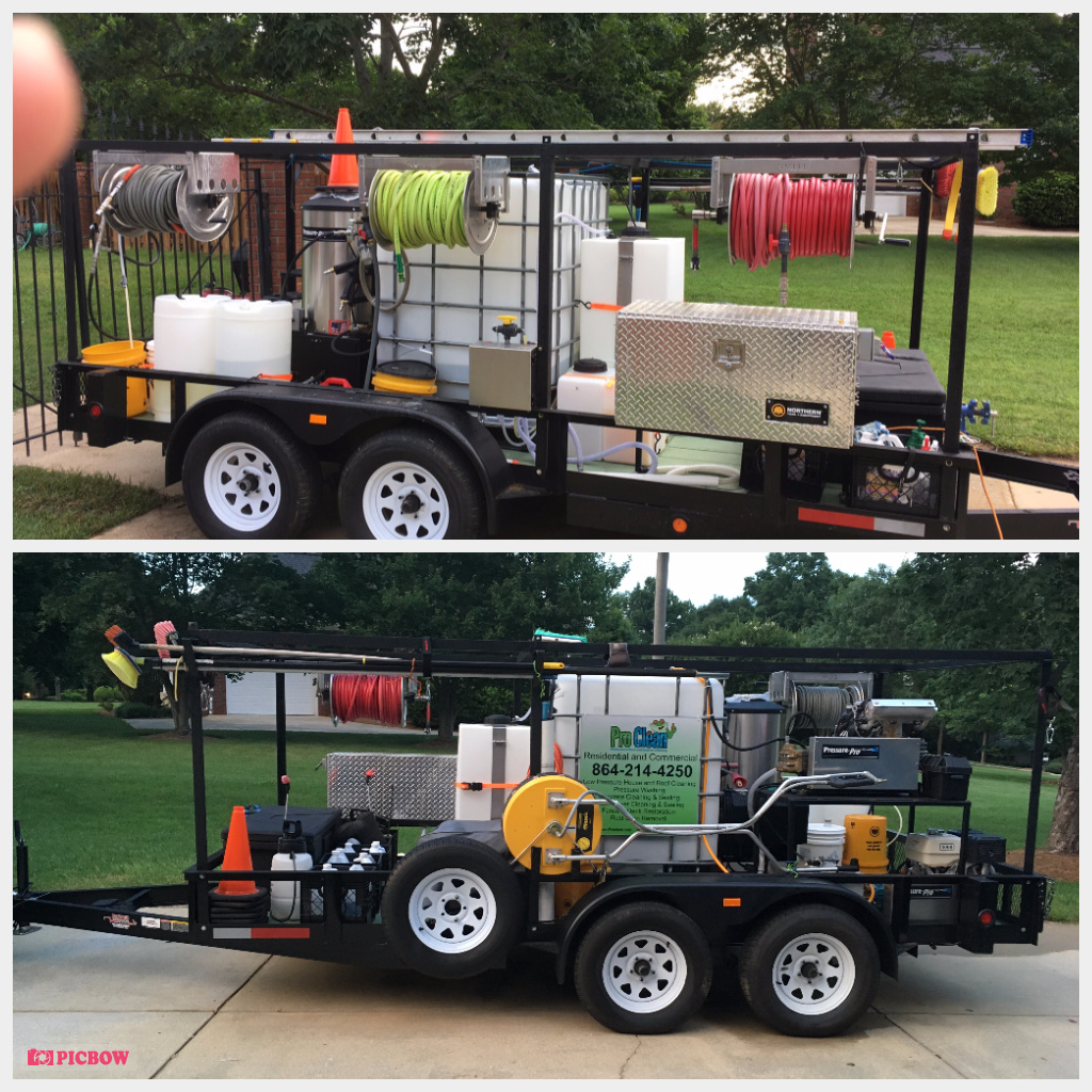

I’m mounting my hot water reels facing out the rear of the trailer for sidewalks and with my vac system they’d have to sitting about 4 1/2 feet from the trailer floor. I’m not sure how that’d work. I may have to figure something else out. I’ve got a 16 foot trailer and will have very little floor space once I get it completed. How far up are yours
That’s a good looking rig. I know you’re proud of it. I can tell you have a lot of thought and work in it.
What size trailer is that? Great looking setup.
It won’t mess the machines up. By idling down it will pull a stronger mix. Also. If you run a 1.8 (1-3gpm injector) on a 4gpm or 5.5 gpm idled down it will pull chems like a freight train. Good if you don’t have a 12V or just don’t feel like using it.
14’ There’s a video up on the build - trailer 2

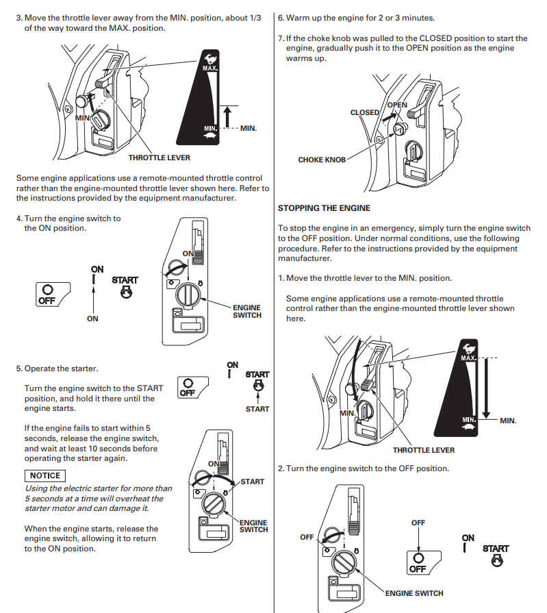

Guys I’m taking @Alabama’s side on this. There are a lot of air cooled engines out there including a Porsche.
Per my Honda GX690 owner’s manual page 5 - see below
I was surprised you don’t idle down @squidskc when shutting down. Do you get many backfires when you do it that way?
See my post below, long as you keep engine in power band which is pretty wide you’re not hurting it. I rarely ever run mine at full power, usually just 80-90% unless I’m surface cleaning.
