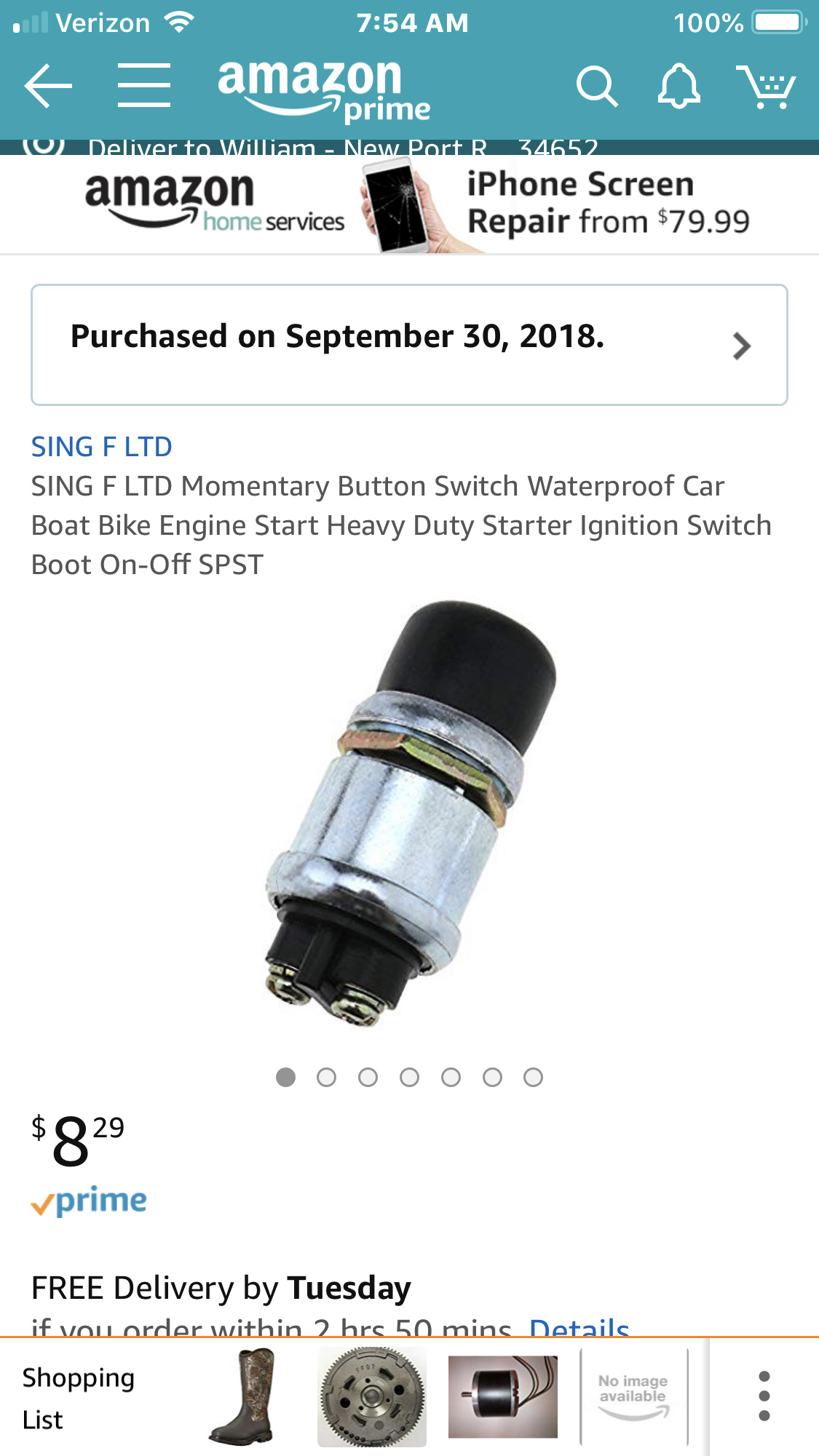

I ditched the selinoids and 15 amp switch. Mine have one 50 amp button on them and that’s it. They last between 6 months and a year. I keep a few extra on the truck. Takes less than 2 minutes to change.
I worked for Fairway Lawns for 9 years when i was younger, and we used hannay electric reels without any solonoids, just a 60A button. had mayb one failure a year on 20+ reels.
I assume a better switch would last longer. I feel like I get my $8 worth out of them
Forgive me if this is a dumb question but I am assuming that positive goes to one terminal and negative to the other. What is the purpose of the solenoid if you can just upgrade to a higher capacity switch?
Sounds to me like the way to go though.
Selinoids are designed for more cycles than a switch. I really good selinoid with a really good switch will last a long time. But will cost you about $200. The ones that come standard are cheap crappy $30 selinoid and $10 switch
