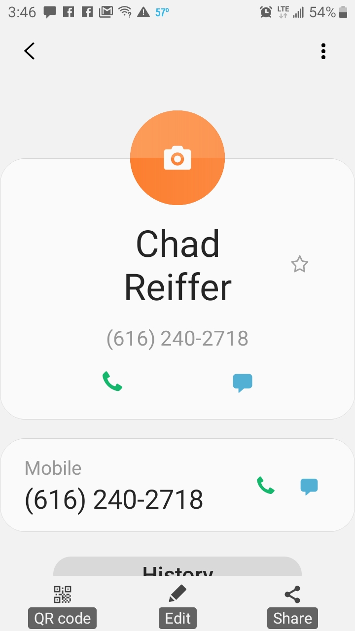

Where can I order this?

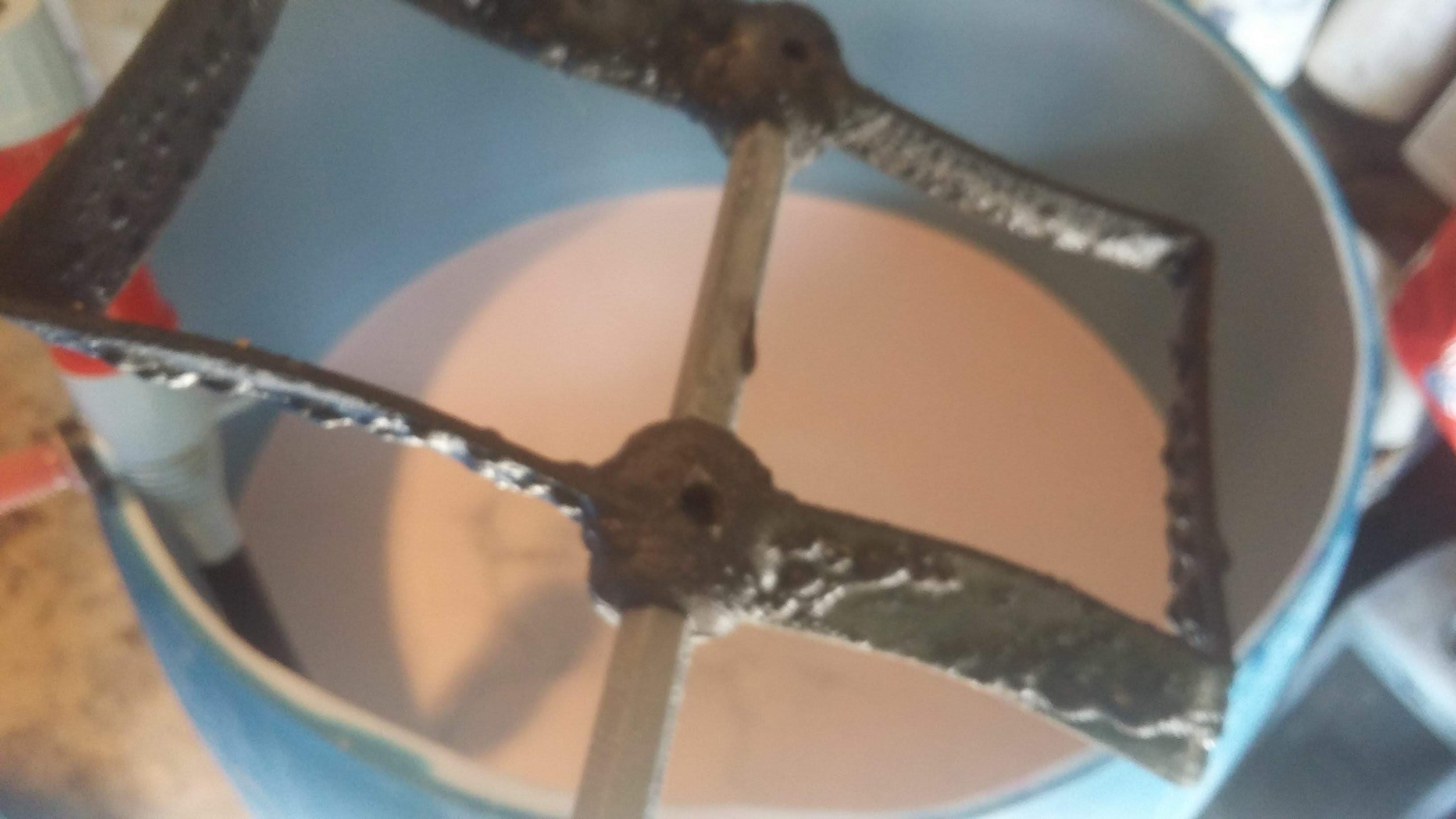

Its super hot @Harold, Remember to mix it cold , comes in 2 pails ,1 liquid, 1 powder. And don’t mix it with anything galvanized coated like a bucket mixer at Home Depot or alike lol, Ask me how I know.
Stick to your purple stuff and LA Awesome ya Daisy SH slinger, Use big rubber scrubber fellers got the good stuff
How do you know?
