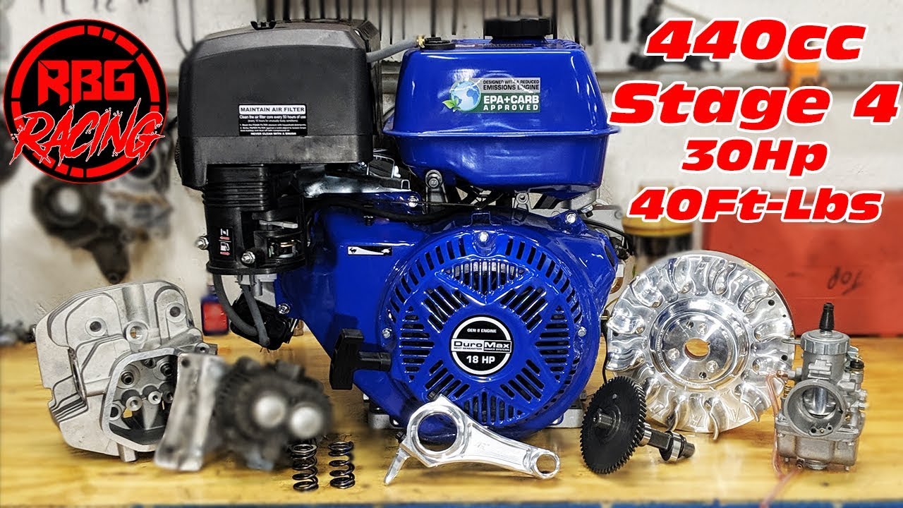

20% off coupon in description cheaper and bigger than 420 predator. 1/2 price of a Honda 390. extra 50cc will turn pump easier.
video is a build, but you can see the internals simple engines.
30 horse seems kind of low for built 440
I dont see a dyno, so its all guessing hp. Torque is more important for pressure washing and other tools i use.
But 440 cc for $263 delivered…should have more grunt @3600.
