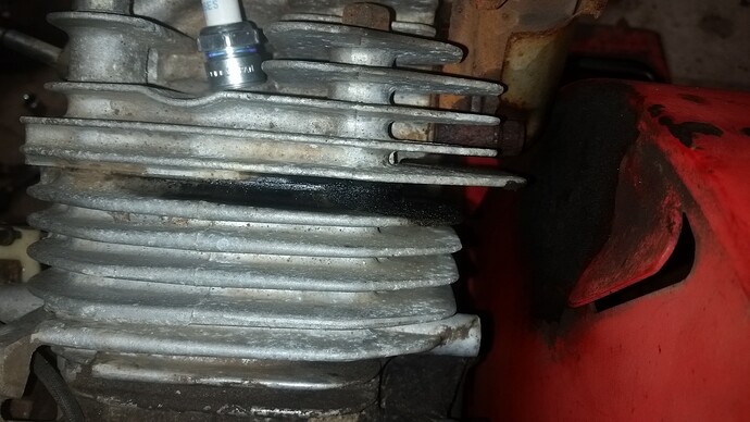

Hey guys…i may have figured another problem on my 390. The coil may have been installed backwards by previous owner.
This the right way? Im thinking this affected timing…andexplains no rpm.
I cant find anything else…been through it all… 20200216_155229|281x500

Well…i took the engine pretty much apart,except for crank and rod and piston.
Cam looked ok.lifters worn…but not enough to cause the issue.
Went over the coil again, and reinstalled it the proper way. Slapped it all together…runs and rpms.
Most likely it was the coil. Funny thing,the previous owner TOLD ME its probably the coil. Lol. It did have a blown head gasket.

Most likely coil was installed backwards by previous owner, then i just followed his error.
Had plenty wrong,including blown head gasket, which could have been caused by coil
