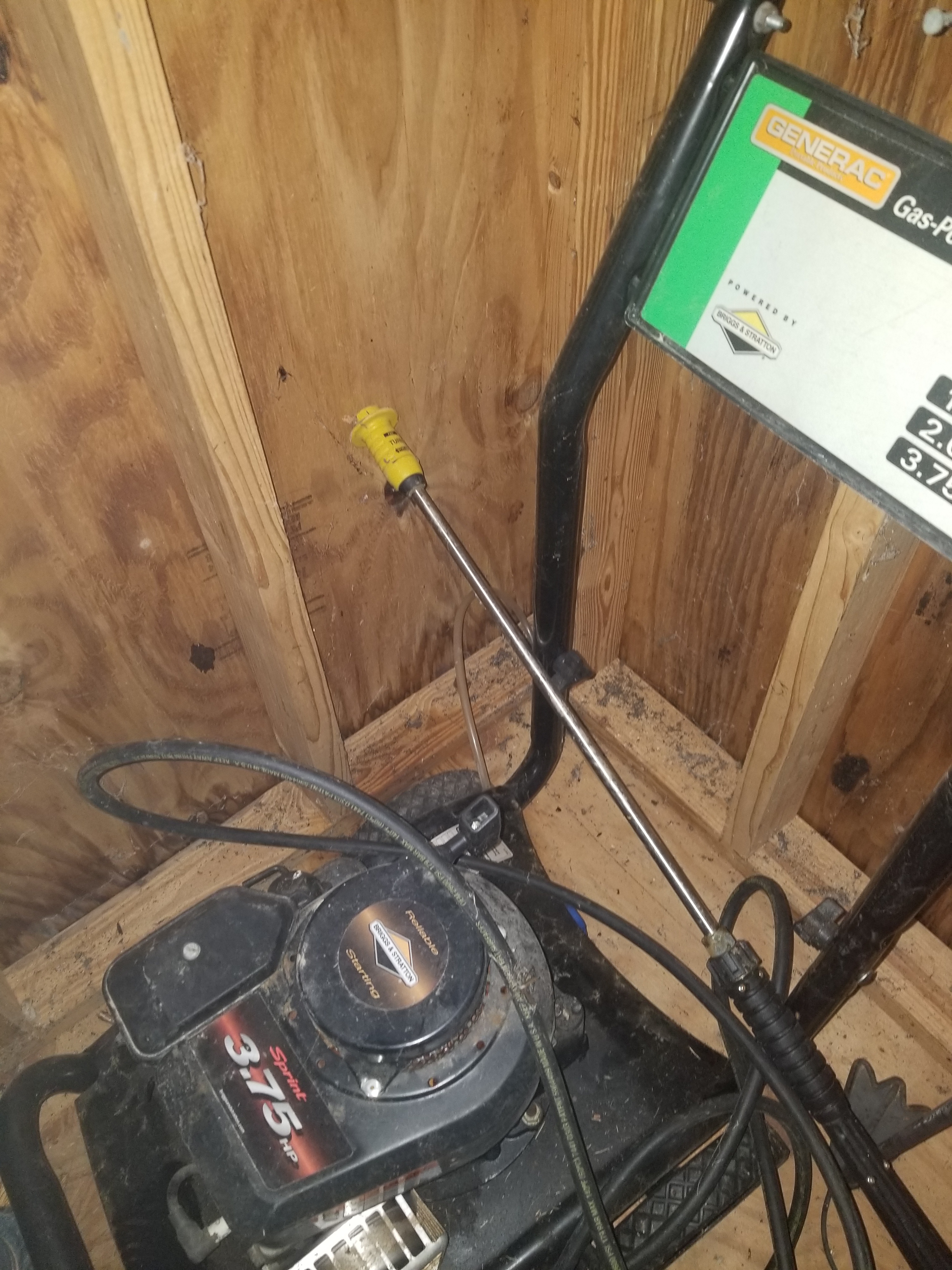

I forgot my homeowner unit has the wonky wand and needs to be plugged where the stock pickup tube stripped out. You’ll have to test it for us @Racer
O lord here we go, yall made @DisplacedTexan pull out ole trusty trixie
The old B&S man! She’s a beast!
