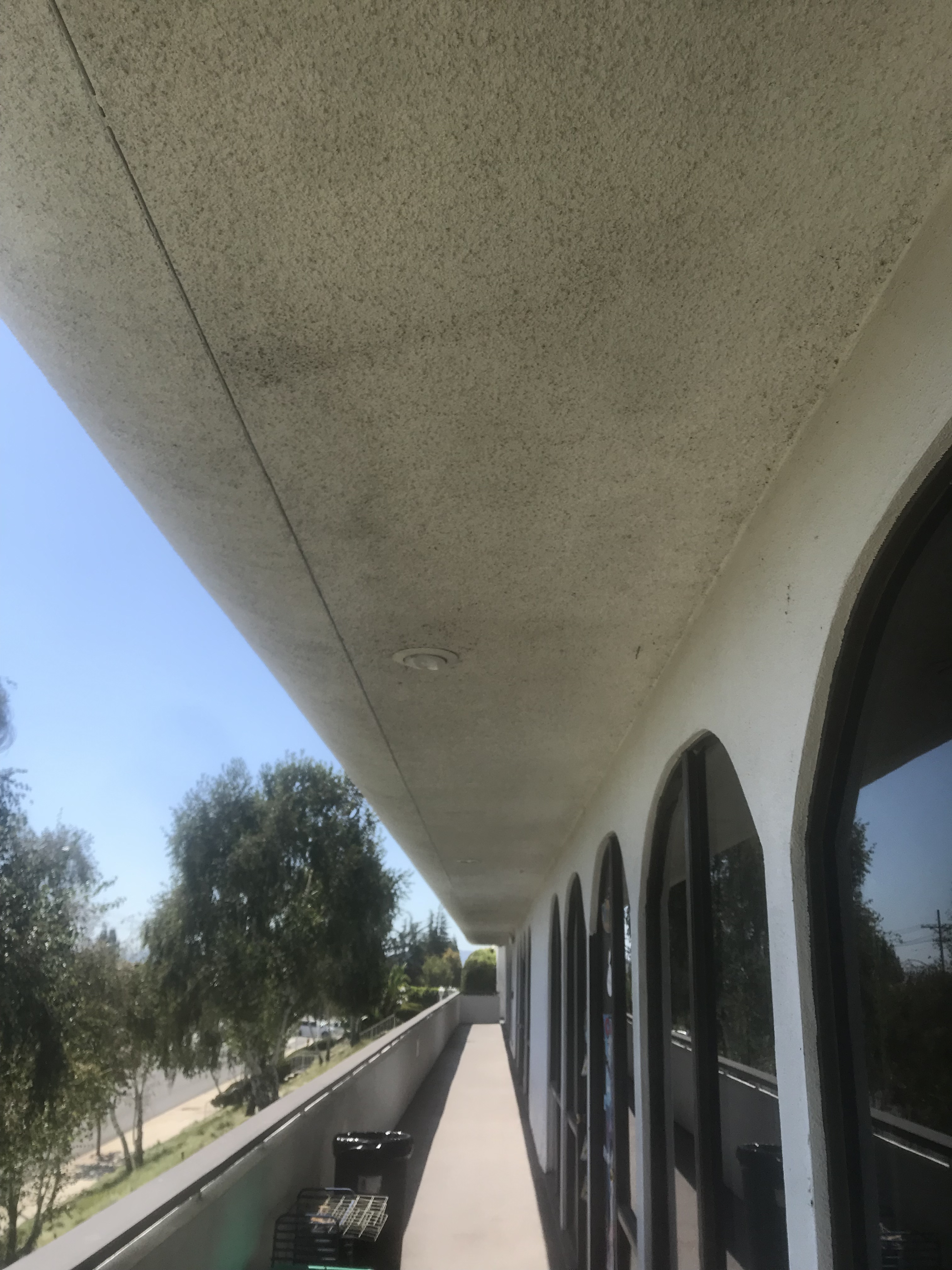

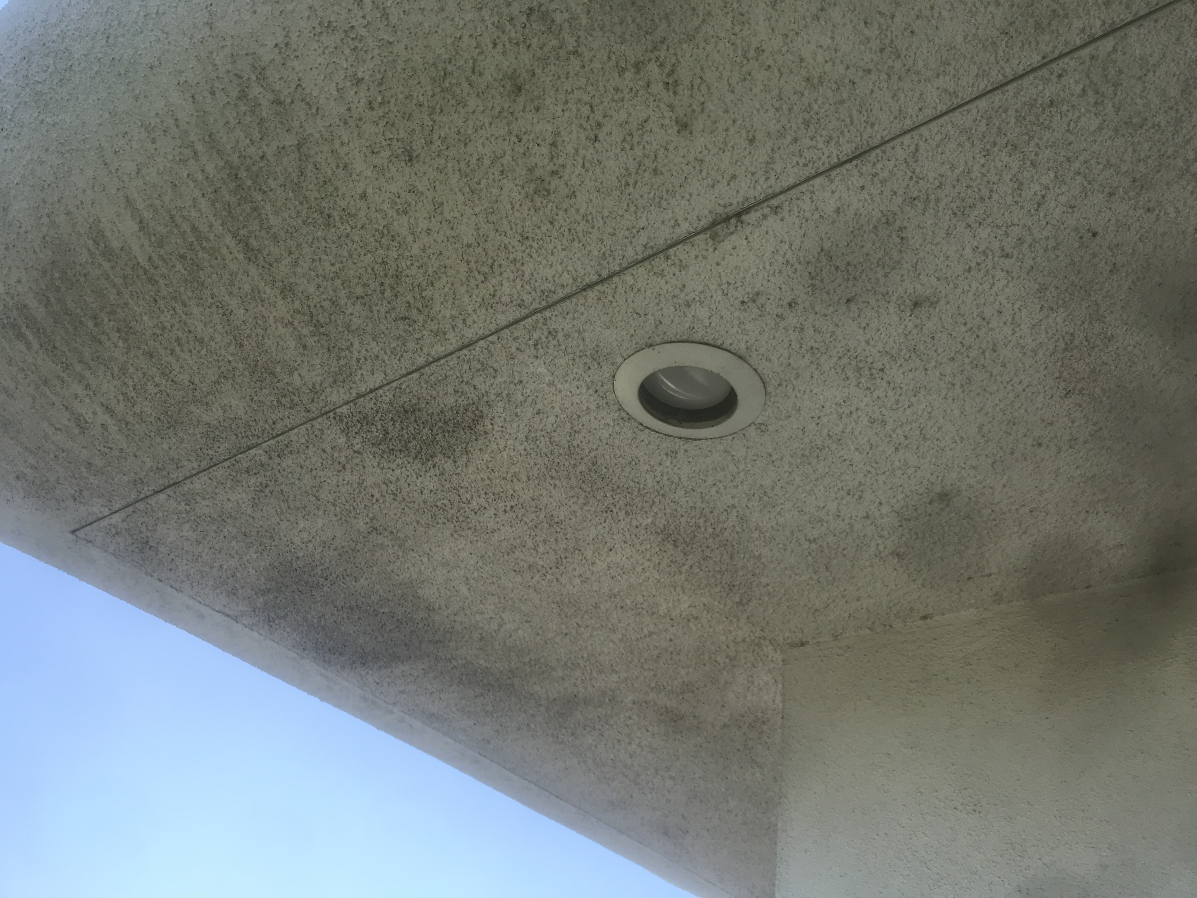

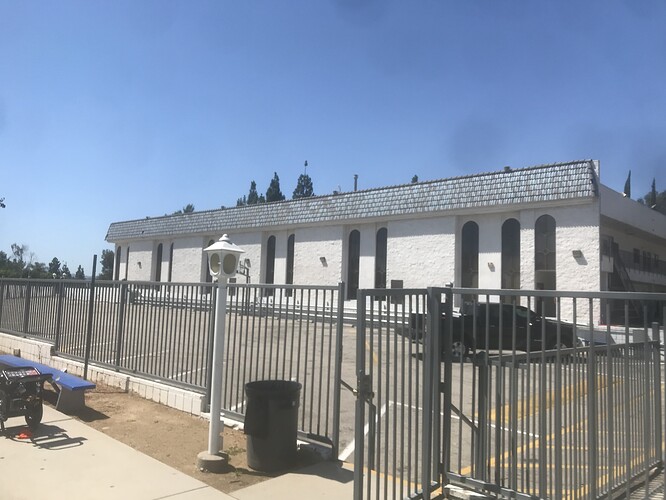

Hey bill my name isRonnie I am just starting out in CA and am trying to get my calculations down. I am trying to do a wash at my kids school for experience it is stucco. I did a 50/50 mix and downstreamed it did nothing so trying to figure out my mixtures. just read you comment above and your figures are very detailed so thought I would ask. I have a 4400 4gpm unit with a downstream of 7-1 with my calculations if I did straight 10% that would give me roughly like a .78 of bleach on the wall right. Seems everyone is saying.8 to 1% on wall is what you want. Could you help me out sir
Except for brick and stucco. For those you’ll need 2-4% actually hitting the wall. If you don’t have a 12v you’ll want to use a 2 gal pump up sprayer.
Thanks for the response Sasquatch. Ok a 12v would be something I would have to build or can I buy prebuilt? I have seen setups people have built not sure I know enough yet. I can use a pump sprayer on one but the others are 2-3 stories
Do you have any more pictures of the exterior walls? You can built a 12v setup for a decent price or buy a x-jet for even cheaper for the time being.
You can build one for about $400-$600. Prebuilt ones are around $1300.

This is one of the taller ones.
@RonnieM, listen to @anon37135677 and @Sasquatch. I am on the east coast of Canada, Nova Scotia to be precise.No stucco homes where I am at, but I would go with an X-jet for starters. If you are going to be doing a lot of stucco, get a dedicated pump. Good luck, let us know how you make out.
Yes, that would be tough with a pump up but possible if you put enough time into it. A 12v would be much much better!

Yea it’s pretty bad but the paint looks good just needs a strong cleaning
