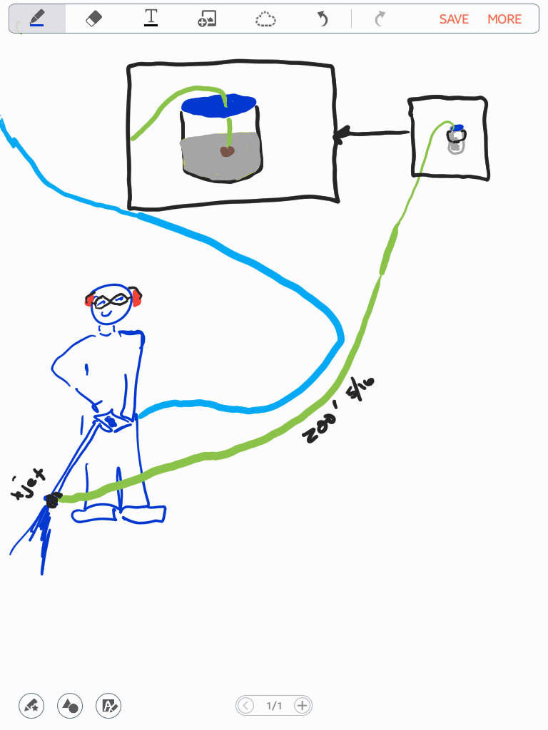

Just wondering if anyone runs 100 ft or more of line from their bucket to xjet so they dont have to carry it around.

I use the x-jet as little as possible. I have a love hate relationship with it.
For stucco it’s beautiful. Stubborn gutters that I need stronger mix on. Wonderful.
Everything else, carrying a bucket and a 2nd hose is such a pain in derrière I try to avoid it at all cost. I made the video above about pulling on 100 feet of hose, but then I cut it into a 50’, 35’, and 15’ foot piece. At 100’ of hose you can lose sight of your bucket and pull it over if it’s not strapped in or weighted down. Or you can pull the hose off the bucket and 100’ of bleach will pour out behind as you drag it.
It can be done, but I’m not willing to try it anymore.
