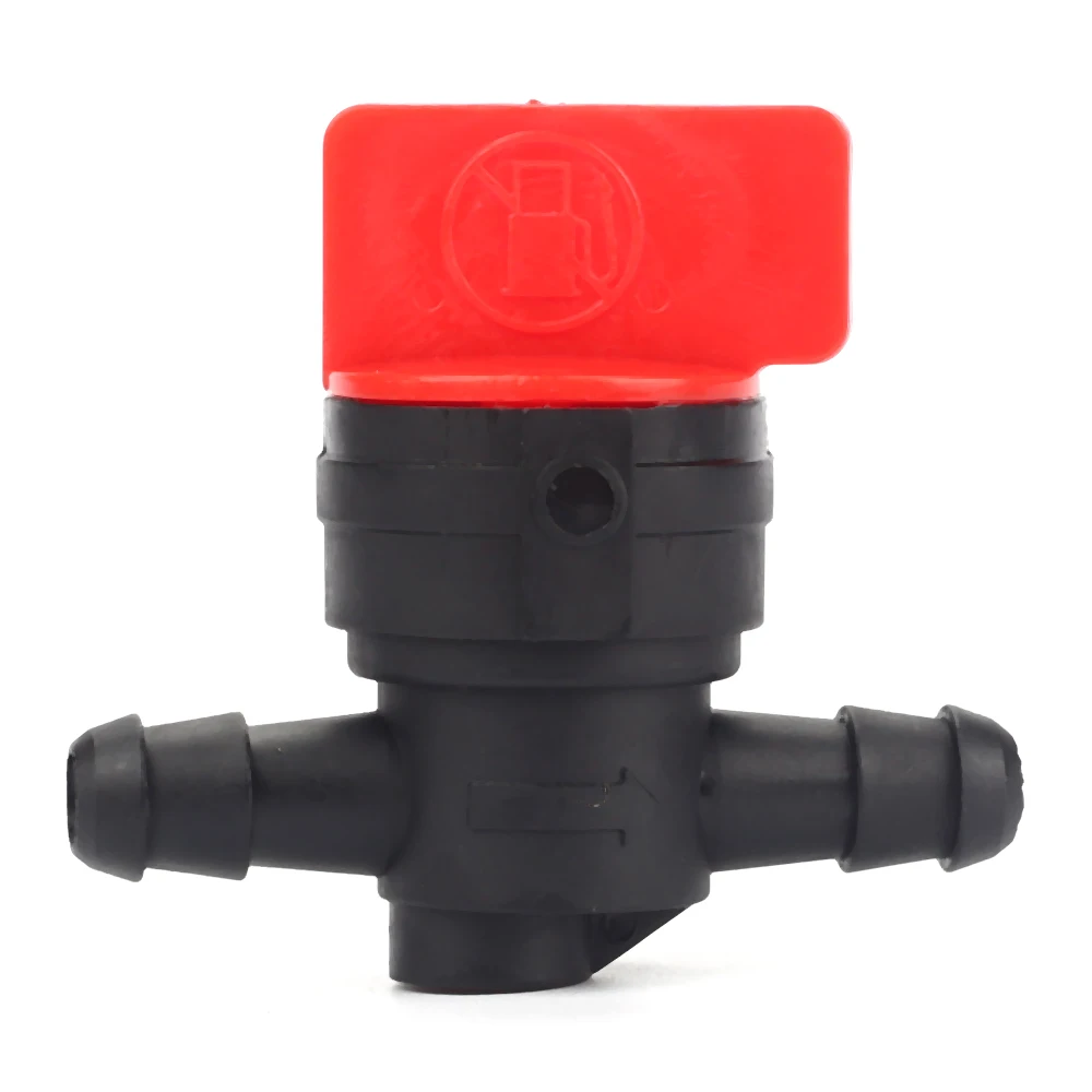

from injector/hose/fuel valve/hose/strainer into bucket.
when you dont want chems, shut it off. when you finish washing house, fill bucket with water and let it run for a couple of minutes.
i have a Y going to my injector, one with the above config. the other straight from the SH tank with an extra Y going to the buffer tank, where it just feeds water that has a valve as well.
