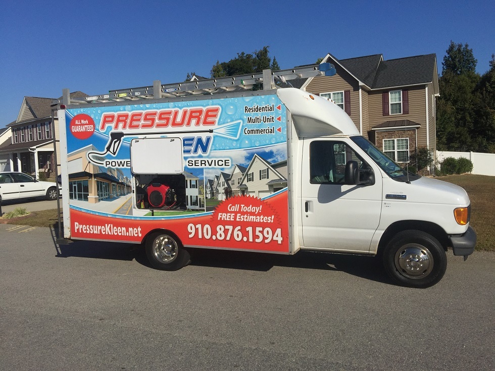

10’ Box would be perfect for a residential unit…Love my box truck!!!

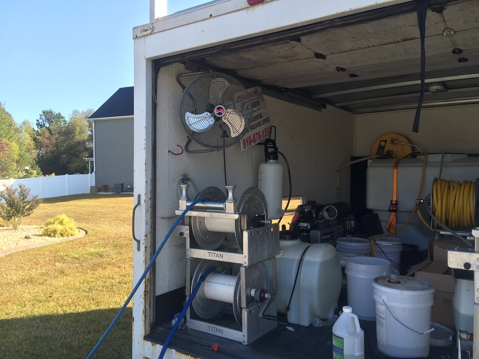

GuyB do you have any trouble with airflow (as far as exhaust is concerned) or do you have it piped outside the box (I can’t tell from the pictures)

No upper left hand corner (not pictured) is a 110v fan powered by a inverter, that draws power from reel battery, that’s charged from PW’er…boy that’s a lot of powered by…lol.
Really no problem with exhaust because of side doors. Motors breath fresh air, and side doors provide air flow out the back.
Ok…That makes perfect sense! Sounds like you put a lot of thought into that setup…Thanks for the info!

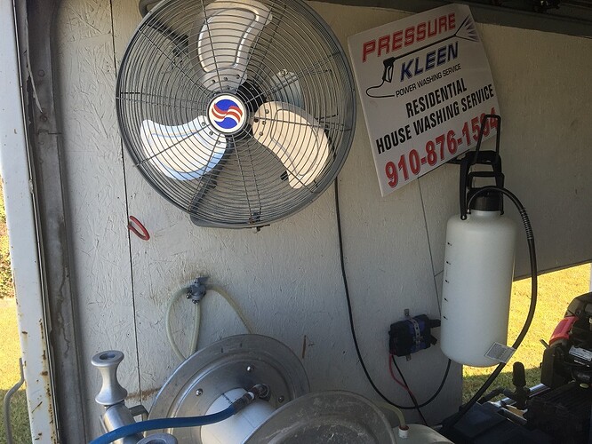

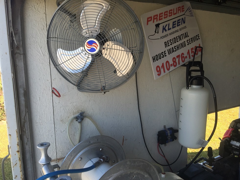

GuyB would you mind posting a picture or two of the fan you installed? That sounds like a great ventilation system, and I’d like to get a closer look at it…I’m thinking of going with a box truck as well.

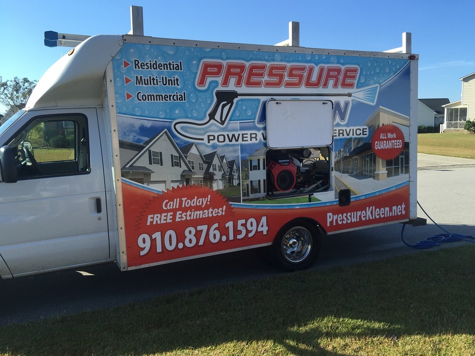

No problem Jesse, I’d like to say that this was all my design, truth is my good Friend William Page gave me a lot of input on building this truck…With Many Thanks From Me.
Hope this helps…
Thank you so much for posting those pictures…that helps a lot! Not trouble running the inverter off of your power washer’s charging system? Looks like I may have to copy your copied idea!

It’s actually powered by the reel battery…that’s charged by the PW’er…and no, no problems…just make sure it’s a deep cycle marine type battery.
