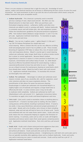

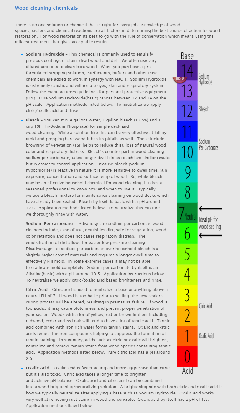

@Amirii - Maybe this will help. SM not on there but it’s ph is about 12.5%

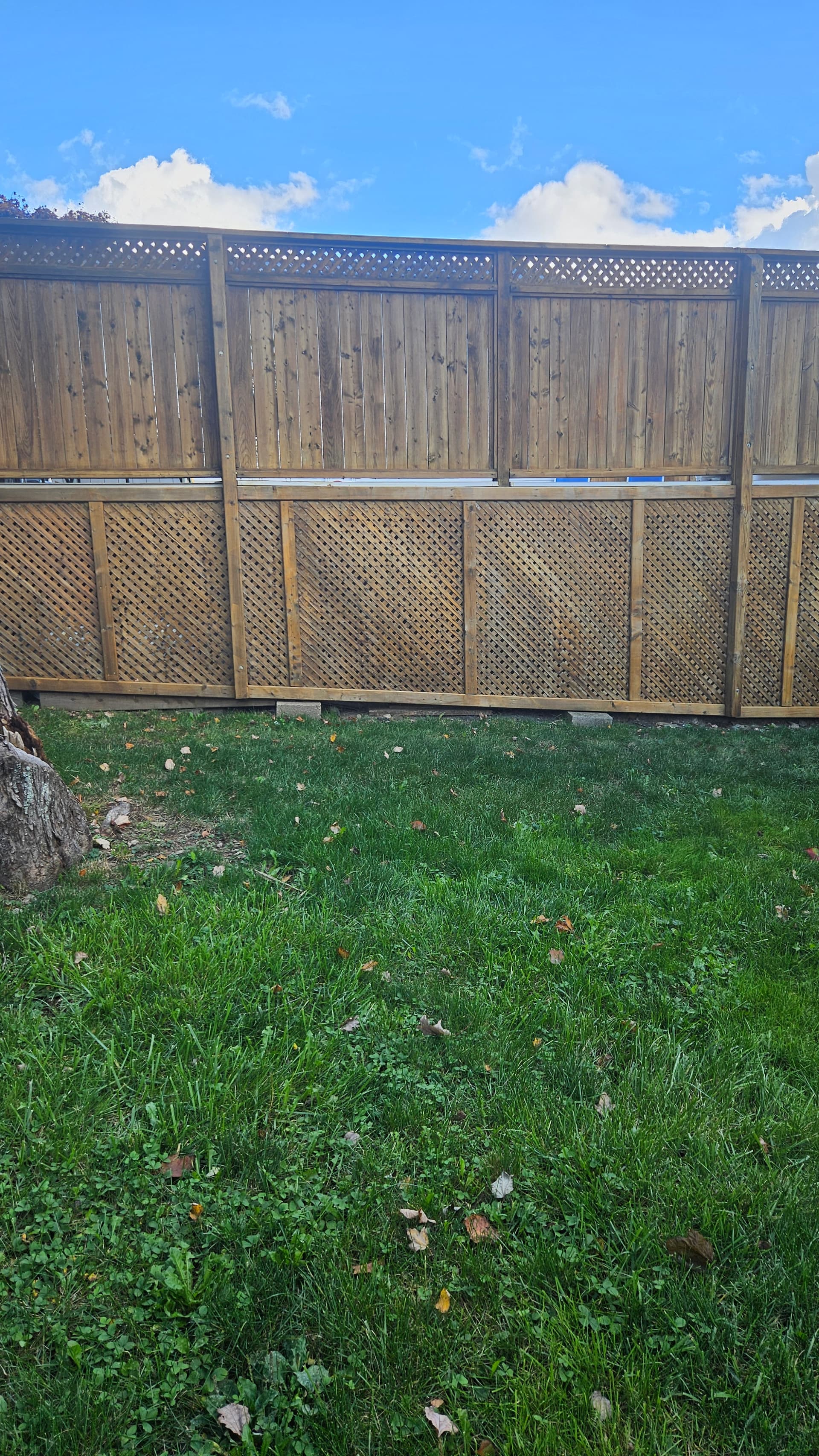

After staining - pool deck siding one of the wood projects I did this summer.

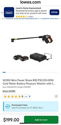

I realize this post is a little old, but regarding the Ryobi 18v sprayer, I got a nice spot sale price at Lowes on the 40v Worx Nitro power pressure washer/sprayer setup. This is really a nice quality and versatile unit especially for applying OA, Strong SH, SP etc. Dial selection of spray patterns and a low/high pressure setting.
Saved a bunch of time vs pump up sprayer!
It retails for $199 but I got it for $149 including 2 lithium batteries, dual charger, reinforced poly hose, assorted attachments and main head unit/wand. It’ll spray about 1 gallon/minute on low and about 1.5 on high.
With holidays coming it may be back on sale!
Hope this helps!!

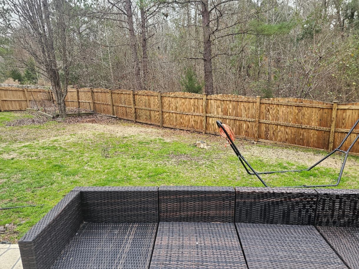

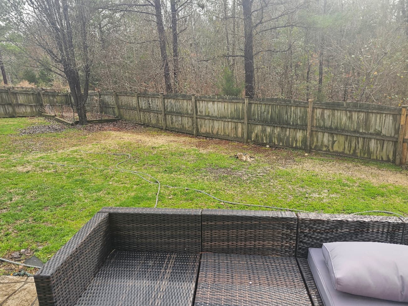

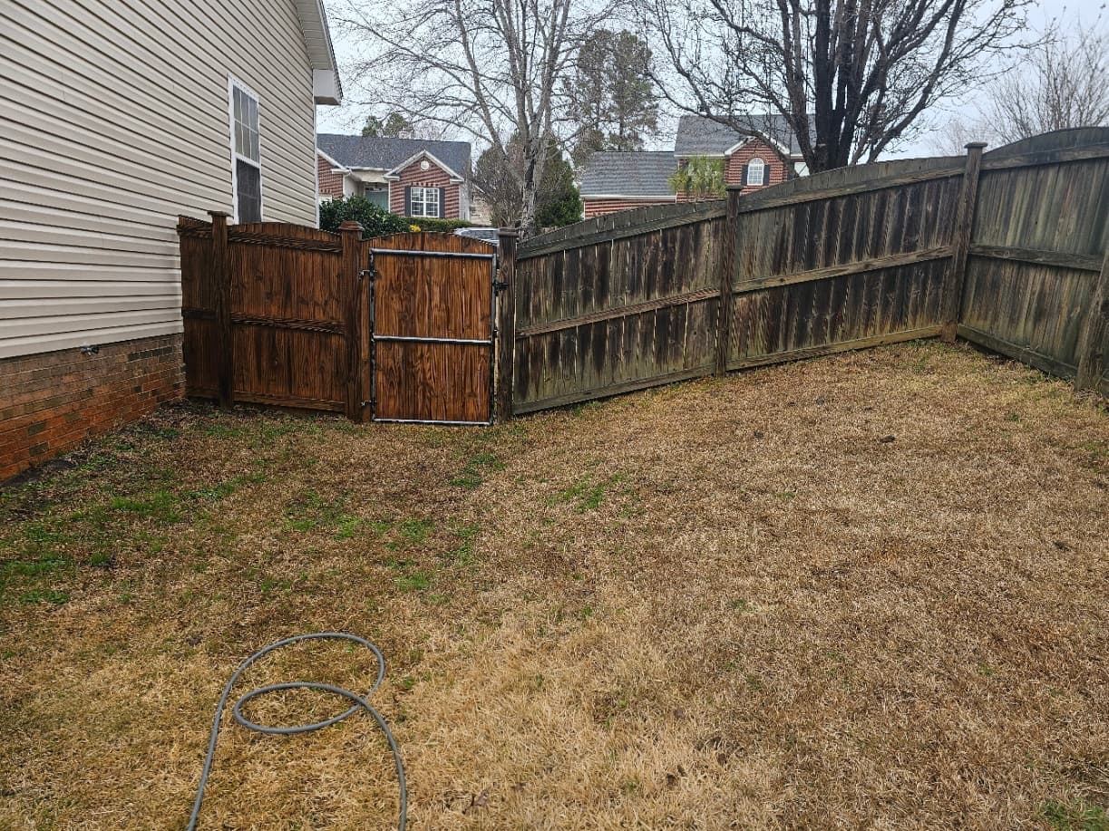

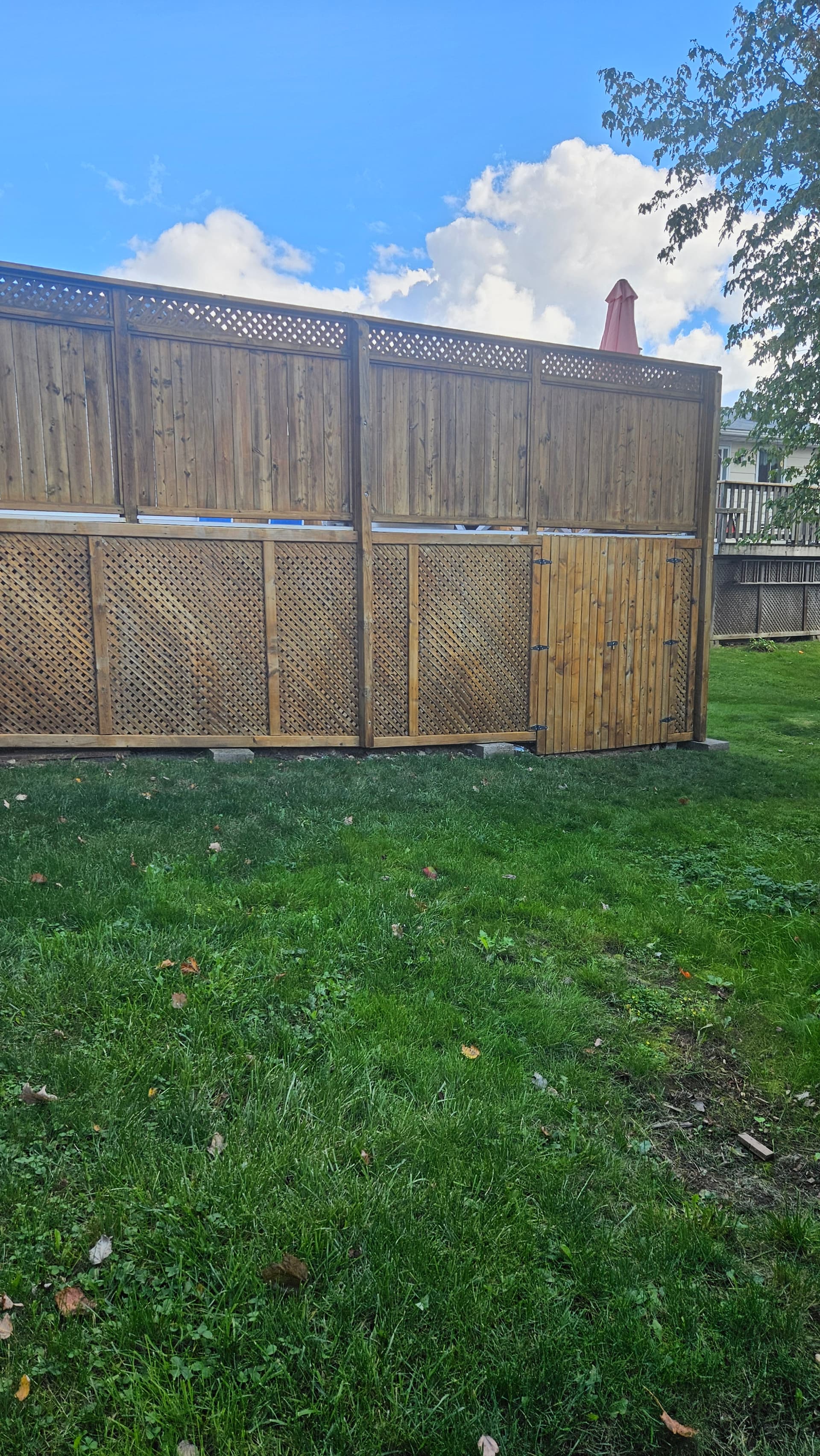

Haven’t posted in a long while but was on here brushing up on my knowledge/techniques for the upcoming season. Here’s a couple of pics from a recent fence I did. They were prepping their house for sale and were thrilled with the results. HW mix, 15-to-20-minute
dwell, medium pressure wash and rinse.

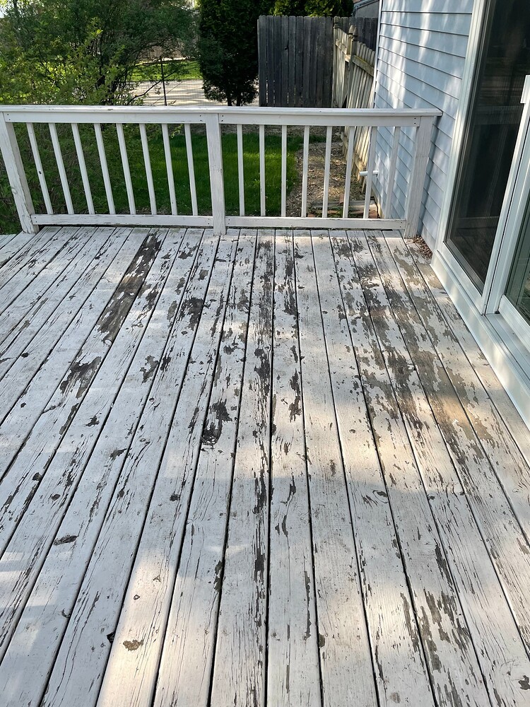

This is an old post to reply to but I see zero reason to strip this. I get these all the time and what I do is simple. You clean with around 1,000 PSI and go away for the day (woohoo off at 1pm!). Come back next day and sand failing areas and feather sand out into good. This is the manual labor part of the gig. Then apply coating (solid stain, deck correct, paint, etc). Collect check.
Edit - added the photo of the deck they were talking about. PS I know how ridiculous it is to restart a conversation from 3 years ago but I wanted to compare notes because I would never use chemicals in this situation.
