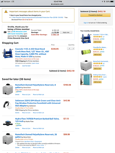

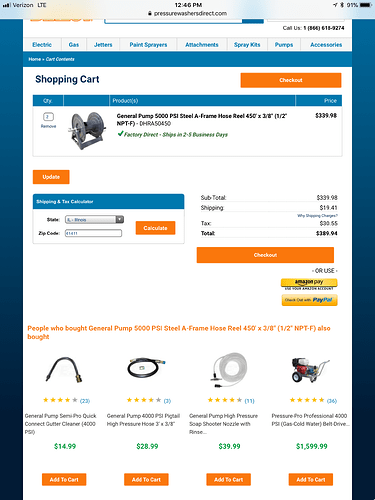

Got them both added to cart. Here’s my quagmire.
The GP is 5,000 psi
The COX is 3,000 psi
I’m running 8.5 gpm at 3,600 psi
Will the cox handle this? The 2 cox will cost me about $80 more than the GP on Amazon’s with my free prime shipping.
If people thing the GP is a decent reel then I will go with that.
I don’t want or need anything more expensive or electric. Maybe down the road but not needed at this time.

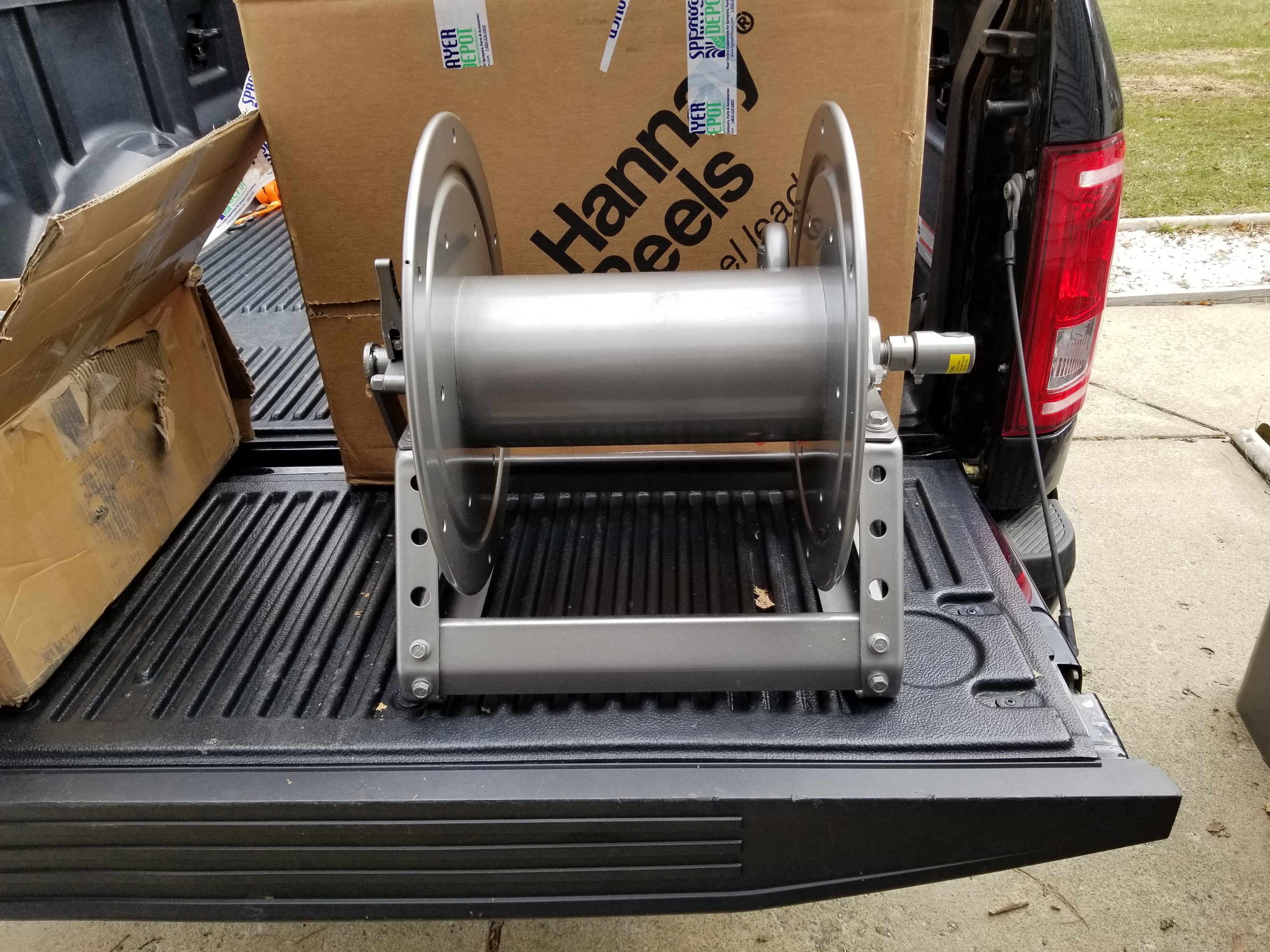

I just ordered a Hannay with a 5000psi bar for less then the GP you’re looking at. The way I look at it is that I would rather spend good money once and have the quality over trying to save a few bucks and end up spending more in the long run.

I thought you said it was less than the GP shipped? Confused now I guess.
Doesn’t that say $389.94? Either way I’d go with the quality of Hannay.
Edit: I see now that’s for 2, my mistake.

I personally wouldn’t get one that big. I only run 250 foot hoses. That one is for 400 feet, but yes, I’d buy a Hannay over any other reel on the market.
Word, I just ordered four 1514’s and four 1526’s from SD. I dig the new machine grey metallic they are using now even though Hannay’s paint prep is so horrible now and it chips very easily. I just need to color match it for touch ups and strip my other reels down to freshen them up after I do the manifolds and bearings on them.
