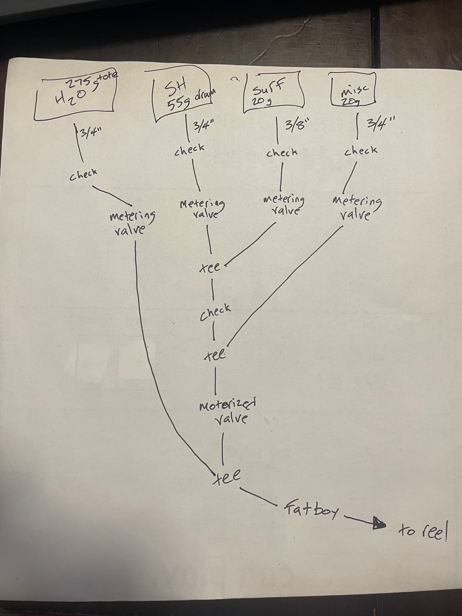

Can you double check my 12v soft wash system I'm designing?
Soft wash blend system I’m building — running ¾″ plumbing to future-proof for a bigger system (AR30 maybe or possibly dual 12v or 24v not sure really). 275 gallon water tote, 55 gallon SH drum, 20 gallon surfactant tank, 20 gallon misc tank all metered; sodium thiosulfate and acids will go through the misc line. Motorized valve shuts off chems for remote rinse. Final tee joins with water into 7GPM FatBoy. Top-draw sticks w/ checks on every line. Looking for any final suggestions from you guys before I plumb it in.
Diagram isn’t laid out exactly how its going to be routed on flatbed. Its more just to show the logical flow of the plumbing. Next up for me is to plan exactly how its going to sit on the flatbed. I have a pretty good idea but I want to make sure I’m future-proof for expanding a couple things around it (like adding another machine or hot water burner or whatever I figure out I need).

That is going to be very slow. Like 3 times more time then using a gas powered unit. a fat boy will only output about 2.5 to3 gallon per minutes at the gun. And you will need to keep a backup pump on the truck. If you are wanting to do a true soft wash setup you might as well do a cheap shot style set up. What you have will work for doing roofs but a whole house I would not use it.
Hmm that’s something then. Is there anything in particular wrong with my setup to slow it down or are you just saying you’re not a fan of 12v pump soft wash systems in general?
If I need a backup on hand then what are your thoughts about running a dual 7gpm 12v pump system? That way I have the backup but I’m using it to boost flow too.
You have to remember that on 12v systems that what they are rated for is with no restriction. So when you add hose and any elevation in the system you lose flow. I have tried dual 7gpm 12v pumps did not see a change from running one or both at the same time. When time is money the faster you can get something done is more money in your pocket.
If I were to sub an AR30 gas powered system in place of the Fatboy would my diagram work ok still? I would have to run a 25’ bypass loop that returns to the pump? Is that standard? The only AR/comet gas systems I’ve seen in person were farm sprayers and they had bypass back to the tank but obviously we’re not batch mixing like they are here so that won’t work.
I appreciate your advice a lot
I agree, my 7gpm 100psi MAYBE puts out 3.5-4gpm after 170’ of AG hose. It barely reaches gutters on a second story. I’ve considered the 24v system but not worth it to me.
I’m more interested in any feedback on my plumbing diagram but I appreciate the feedback on the GPM of the 12v pump. Its definitely an issue but again I’m really focused on making sure I’m on the right track with the plumbing.
This will eliminate a lot of those tees in you drawing. And will keep you fom having air leaks.
how would that manifold reduce air leaks? The tee fittings in my system will be barb ends so they require worm clamps on the hose to connect to the barb. With this manifold wouldn’t I require NPT thread x barb fittings and clamps also to secure to the manifold? I don’t see how I would gain anything, both would have potential to air leak and as you can see according to my diagram I have a motorized valve on the SH line after I merge surfactant and misc to the line before I merge water. If I run everything into a manifold I lose the ability to remote switch between water and SH/surfactant (or misc if I have SH/surf turned off manually and I’m doing a deck with misc tank line on). Unless I just tee surfactant and misc into SH anyway and then run a 2 port manifold for water and SH/chem but that kind of defeats the purpose because I only delete one tee fitting out and a 2 port manifold seems stupid given it literally is just a tee. I absolutely need remote switch for toggling between chem/water.

What do you plan on using your system for primarily? What I don’t see is how you’re going to flush your system unless you’ve got a 3 way valve on the input side of each.
So far the vast majority of my jobs have been vinyl house washes and stucco house wash and a TON of concrete driveways. I have been doing decks for 10+ years and (reading from you) refined my techniques this year and really elevated things. I need the 12v to dispense chemicals on decks and also to dispense hotter mixes on really dirty stucco/brick and also I’d like to be able to pre-treat and post-treat at a hotter mix than downstream house wash mix which I think will really speed up my driveway cleaning process. I also want to siamese another 5GPM pressure washer into my system but that’s just so I can surface clean at 10GPM but no doubt will speed up house wash too.

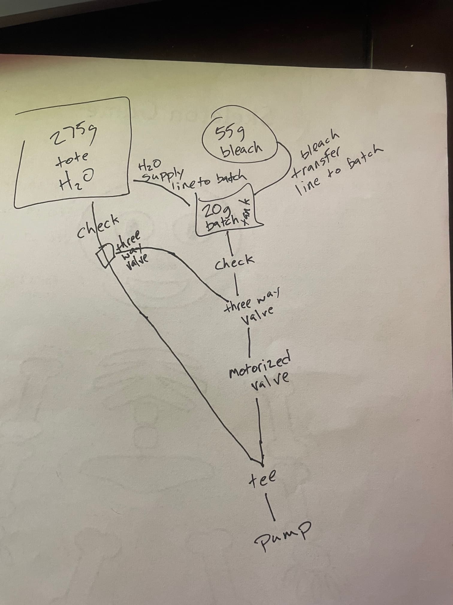

Writing out answer to you I wonder if it would just be a lot simpler to set up a batch mixing system for pre/post treating and mixing up chem for decks. I’m trying to think hard about what I would lose and would I really regret going that direction. I guess worst case scenario is I found it miserable and I could just cannabilize the batch system and pursue the proportioner system then with no loss. Do you think setting up a batch mix system I have the best chance at getting good performance out of a 12v pump like the remco fatboy?
PS so I need to run a three way valve from water line (after check valve) on a three way valve and three way valve into SH line AFTER check valve for rinse?
if I set up a batch mix system, do you think its smart to run some kind of 2-3GPM bleach pump as a transfer pump. The big pain in the ■■■ with batch mix as far as I can tell is actually making the batches…lol. I’d want to speed that up and smooth out that process. I can use gravity to feed water from bottom of tote into 15-20 gallon mix tanks but for bleach I’d want the ability to pump it and setting up a little bleach pump mounted to the drum with an outlet hose to reach (camlocked fitting?) mix tank would be crucial I think…
here’s what I came up with back at the drawing board ha
Its not exactly a simple batch mix system but it addresses what I want out of a system (thank you for the question as obvious as it is to think about your use case its easy to get lost in the forest for the trees). I want something I can toggle between chem/water for sure and I also want something I can spray hot mixes with. This lets me do max 6% (if I put straight bleach in the batch tank since it will mix 50/50 with water from the water line). I could do 3% by adding as much water as bleach to the batch tank giving me 6% in batch tank and 3% output which is perfect for pre/post treating. It also gives me ability to rinse entire system out past the batch mix tank check valve (so three way valves, motorized valve, PUMP get rinsed).
I lose ability to dial mixes on the fly and I lose the ability to cut surfactant in/out. I think if I plan ahead smart enough it will be fine. I also solve a separate problem I’m wrestling with about transferring bleach drums at the chemical supply place I am using. I can just run my bleach tank down to around 20 gallons then transfer it into the batch mix tank and run to the supply place with the empty bleach drum and swap it out with a new one. So now I don’t need a blank spot on my flatbed to transport a full drum back to home to transfer out thus conserving space on rig and also simplifying the transfer process. Only possible problem I see is it kind of ties me to doing that errand down to 1-2 day window unless I guess I keep a 20-30 gallon bleach backup at home which I guess I could.
