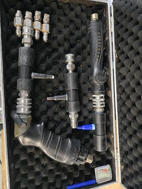

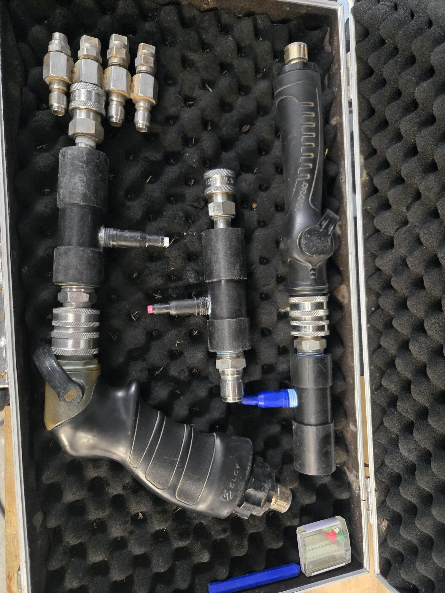

If it’s for infrequent use and your not planning to do roofs then just get an x-jet.

Correct me if I’m wrong but the overspray is real on the xjet, no? I work on multi million dollar homes, I need something that is low PSI and won’t mist. I was thinking a 12v 60 PSI ish maybe 5.5gpm max
I mean, there is some overspray, one of the reasons I wouldn’t use it on a roof, but it’s not unusable. I think it sprays a tighter pattern then the M5DS… regardless, you’ll be able to see where it’s hitting and stop before you get too close to the edge of whatever you’re spraying. I have yet to have a multimillion dollar homeowner bat an eye when I’m using it.
