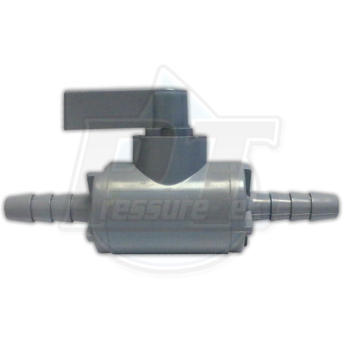

SH loses it’s punch pretty quick & temperature also plays a huge factor - which pretty much tosses all the math out the window when the rubber hits the road. I don’t own an X Jet, but if I did I would run it wide open through a bucket of straight SH with one of these ball valves in line so you can adjust the mix as needed by turning the knob a bit. No need to carry around water in the bucket unless you are looking for a workout. I downstream the same way with these valves on the chemical tubes & they are fabulous. No more batch mixing.
