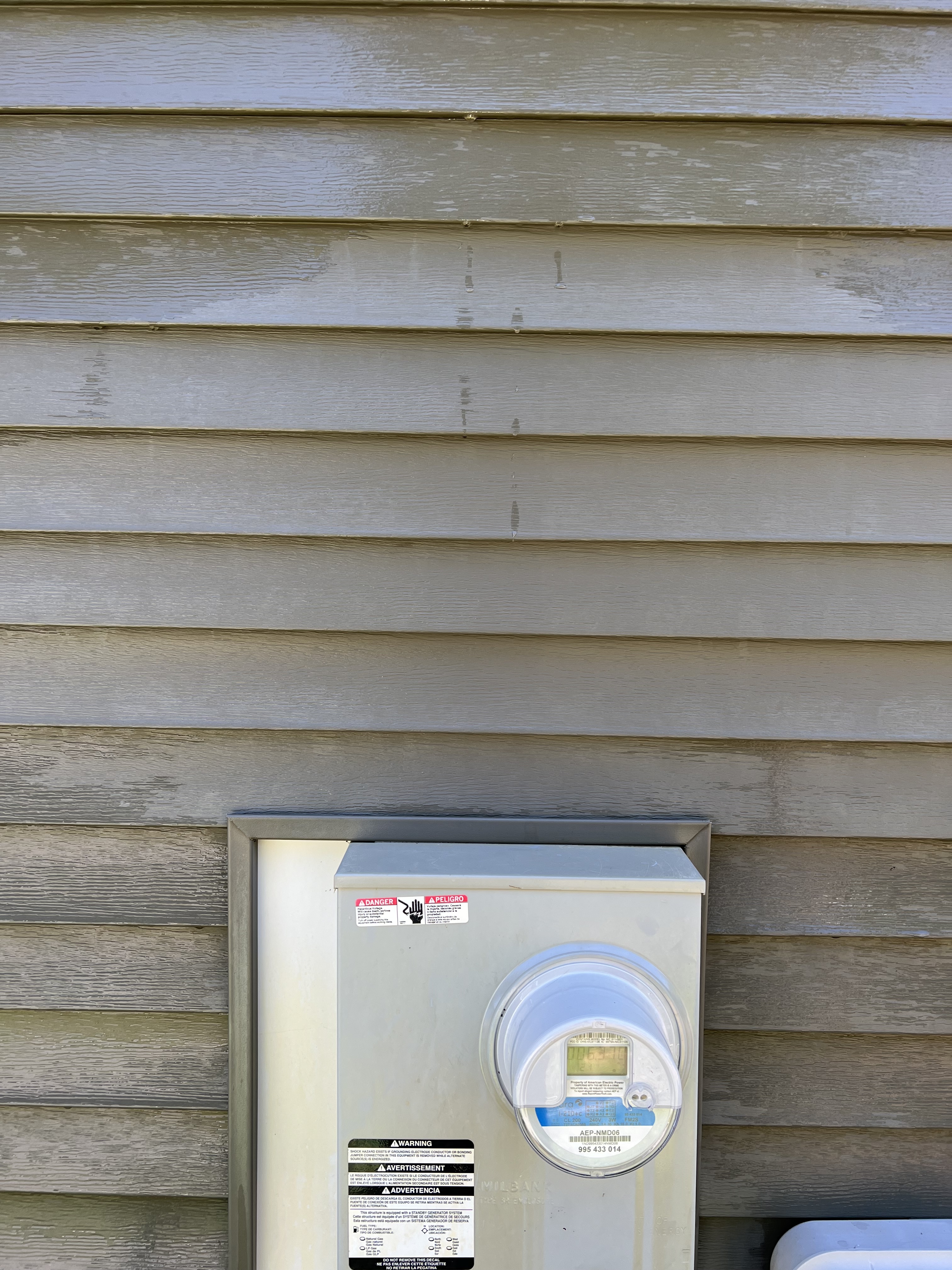

Would it be worth giving oxalic acid a go to neutralize the bleach? Will that white wash the areas that I use it in?

Wow, what a thread! Before you used SH on this dark siding did you do a color swatch test?
I suspect what has happened is the SH has actually hurt/burned the color. Now you are going to say but it comes off with purple power and a magic eraser……are you aware that magic eraser is basically like a piece of sand paper? So you added a caustic solution to the surface and then did a sanding and it came “clean”. Did it really though, or did you just do a mini paint stripping of sorts?
If you really think any of these chemicals will work please run a dang test. Get a pack of plastic cups and a huge pack of toothbrushes. Fill up each cup with the correct mixture then use a toothbrush to apply it to the siding on a trouble spot. Apply, leave on for the recommended dwell time, then rinse off with a water spray bottle. Also try different strengths of the same solution. Out of curiosity, I would also run a test on an undamaged piece of siding with the original SH conditions and see if you are actually burning the color.
The fact is, you need to find something that will work without manually touching each piece of siding. So you need a chemical solution, not an elbow grease solution. If none of this works you should probably just file an insurance claim.
Hey there, thanks for the bat signal :slight_smile: . I really think he burned the siding. This is why chemical compatibility testing is so important. A surfactant will help clean. A surfactant will help water slick away. A surfactant will not stop a chemical reaction between color and SH.

Thank you for the post. I washed this whole house with the same mixture and everything else looks good. I believe I may have forgot to rinse this side altogether because there was also a plant that was withering, and I had to remove orange stains off of their white window sills on that side. Brushing also worked good but it took a ton of scrubbing. Here’s a test spot where I scrubbed these panels super super good with purple power and a soft bristled brush. It took scrubbing and drying 3x to get these results. No magic eraser was used in this spot.
Absolutely you have been one of the ones I look up and see past replies and posts! Your the bomb!
This is basically the equivalent of sanding off the burn in my opinion. Again, just an opinion, it’s possible that these super sanded areas will not weather and age well.
Please run the toothbrush test with SH. Also, you may want to contact the siding manufacturer to ask about the siding issue you are having. It’s likely not their first call about this type of thing.
I totally see what you mean about sanding it down. What do you mean by doing the toothbrush test with SH? Like a really hot mix? Because I’ve already put SH on this side twice more and it doesn’t change anything. How could I find out the manufacturer, should I just ask the homeowner?
She essentially is saying what you will find on here 100x… “do a test spot”. She’s suggesting that you do a test spot of everything, including SH on an unaffected area which may confirm what she suspects you did in the area you’re struggling with.
