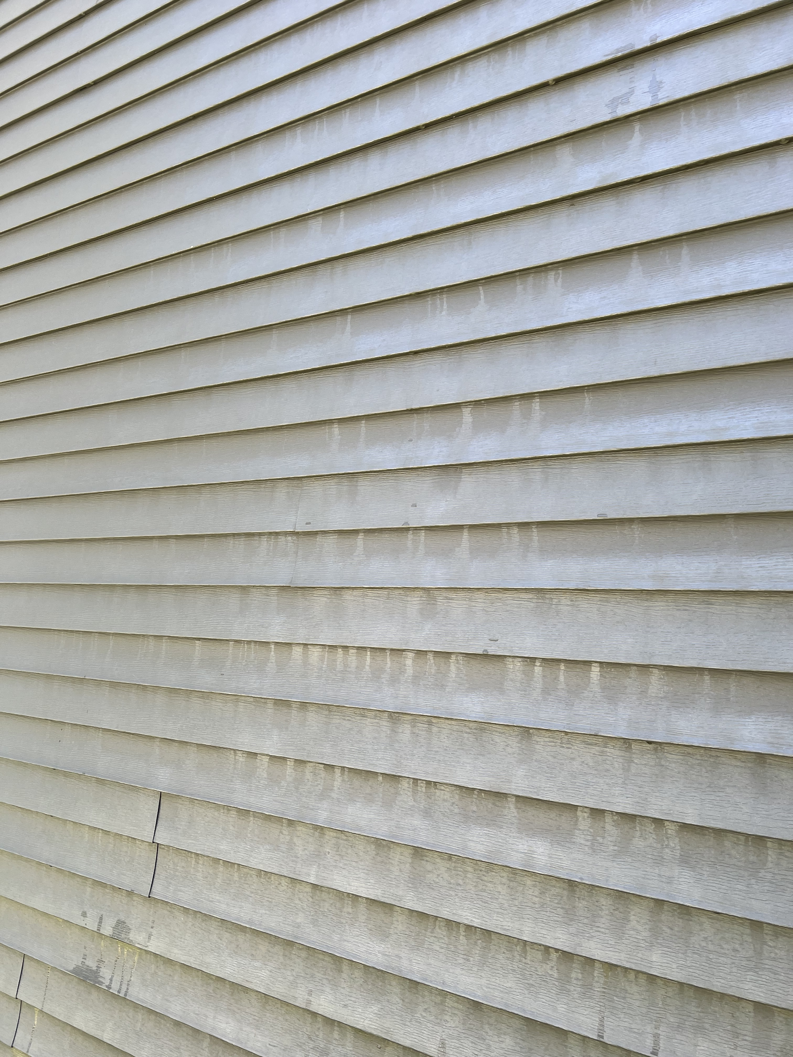

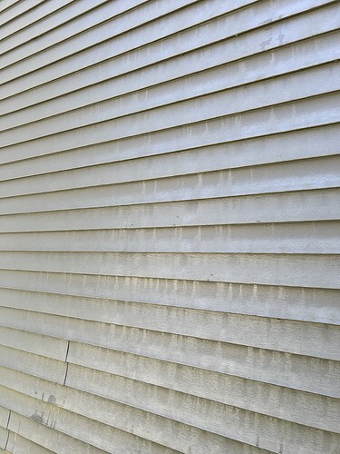

Thank you. I know it’s a fixable issue because it can just be wiped off with my finger when I lick my finger. When I went back out I just rinsed it with a garden hose. Didn’t even bring my rig. I’ll go back out with my rig and resoap the whole thing, rinse really good, let it dry, and mist so that any drip out of the siding will fall away

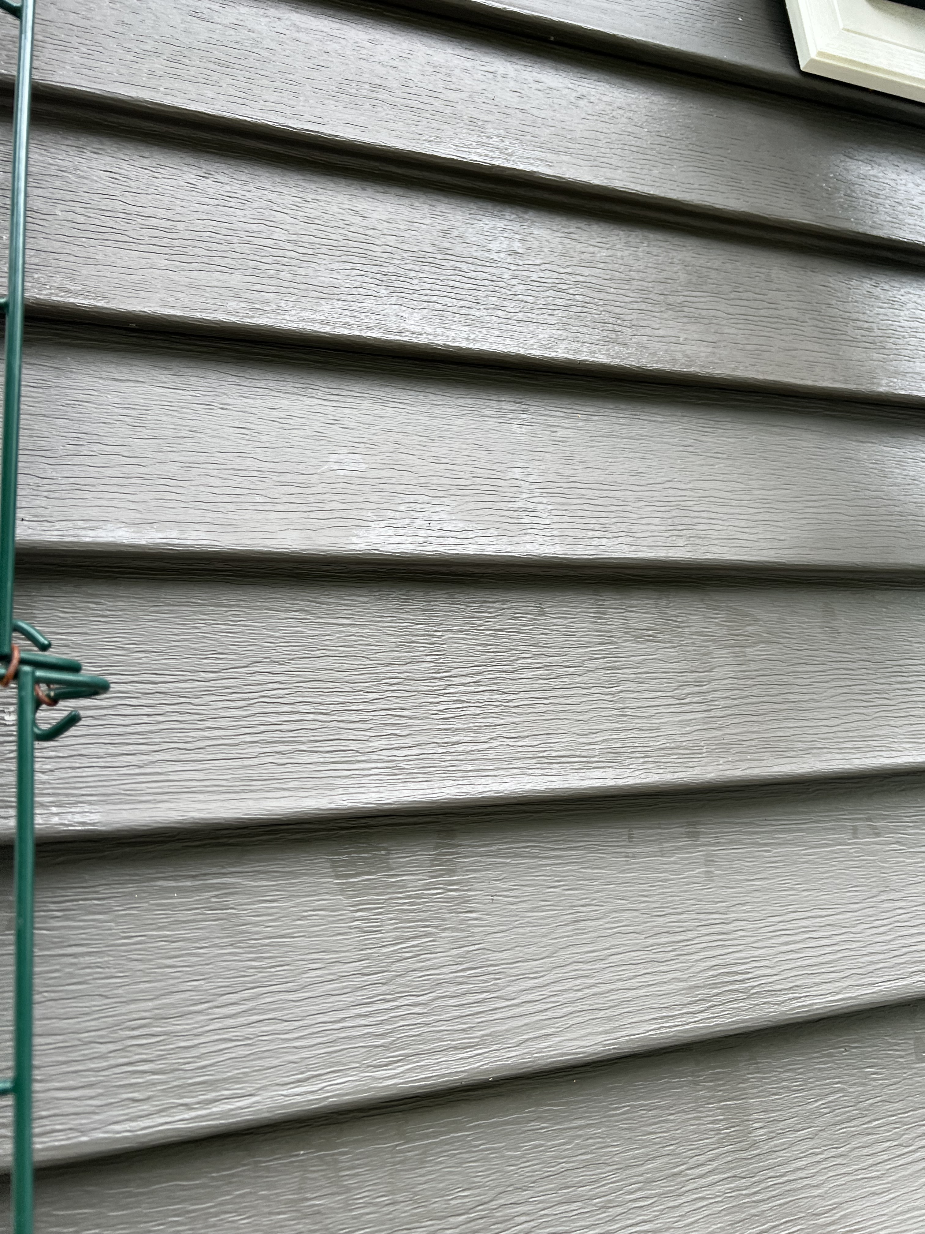

Maybe it’s an optical illusion because of the color of the siding, but I’ve never seen water runoff or dirt leave a white residue.
One thought I had though, based on the water in the background of one of the pictures and being in Michigan (I think I read that somewhere)… is this a lake house? Do they have hard water? If they use a water softener the white residue could be from the salt and if that’s the case continuing to use their water will just repeat the cycle… just a thought.

You’re like Sherlock Holmes with these photos :joy: haha yes it’s a Michigan lake house and the water around here is sooooo hard. The big white streaks underneath the window and on the siding went away with a rinse, my only problem now is these little lines

It’s probably the hard water. You could try rinsing a section with purified water. Wouldn’t be that expensive to test. Just buy a gallon of distilled water from Walmart and use a pump-up to apply.
I’d do a section without wiping it down and a section with wiping it down. Let dry. See how it looks.
Let the rain care for it….like @Racer said. I’ve seen this so many times. We actually have it in our terms and conditions….just for the customer to wait for a good rain. I’ve never had an issue with it.

Since the last post I’ve learned that the problem I’m facing is 2 different problems. On part of the home it was just seepage from the weep holes that had to be wiped. Now only one problem remains and it’s this streaking in the photo. I’m pretty confident at this point that the cause is SH that dried onto the siding. It was super hot on the day I washed and I admittedly let it sit longer than I should have. I’ve tried straight purple power and scrubbing with brushes but it didn’t seem to do much other than maybe dull it a little. In some spots we used magic eraser with the purple power and it seemed to work pretty good if scrubbed well. I’m thinking about ordering some red raider or gutter grenade to help get it up. What do you guys think will get this up? It has to be done extremely well because it’s dark siding so EVERYTHING stands out like a sore thumb
Scrubbing supppeerrr intensively with brushes and straight purple power did work pretty well in some spots but it took absolutely forever and tons of force. Plus this side is on a hill so the stains are as high of a reach as like 15 feet at the lowest point of the hill, so it would be super nice to find a chemical that would help melt it off so that not as much abrasiveness is needed
