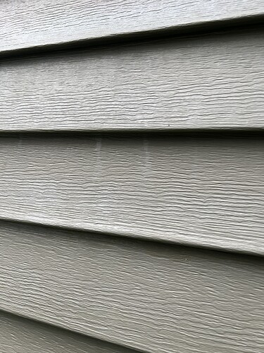

Some of you probably saw my first post with these photos my customer sent me
Well, I went out there and rinsed wbeeyrhjng really good and the overall big streaking from those photos went away, but another issue that the customer pointed out when I was there was these little streaks, and they didn’t come off with just a rinse. How did I cause this and what should I try to fix it?
Your situation is reminding me of a similar home were nothing would clean up the siding, it always looked dirty. Find out from the home owner if this is Nailite siding.
I’d probably redo the whole thing and this time rinse the snot out of it.
I didn’t check your application method, are you using an xjet, downstreaming…what is your SH and soap percentage?
Tell him to call you back in a month after it rains 4-5 times hard.
If he won’t go for that, you may have to re-wash. The problem you have is you may have rinsed too much. That’s just where water, probably somewhat dirty has dripped. Next time stand further back and rinse on diagonal with the overlap, thoroughly but lightly. 9 times out of 10, most the drip marks come from the lower 1/2 the house or wall. Do like William told you and come back with a light mist coat once it’s dried a little.
Down streaming 12.5% so I’m at roughly 1.25%.
