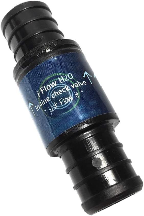

I’m currently using a couple of these on my proportioner.
This is the second time one has failed, causing my bleach tank to get diluted. Are there any other higher quality versions you all have found? Also what measures can be taken to prevent this in the first place?
Do you know for a fact what spring material you got in those? Lots of vendors selling blend manifolds using those SMC valves that have Stainless steel springs rather than the more expensive Hastelloy springs.
My wife ordered off Amazon, description says hastelloy. The spring isn’t broken but for some reason it has no resistance when blowing into the ‘in’ side like a new one does.
The spring provides the resistance (cracking pressure). Which style was the one to fail on yours? Some have a thin elastomer disc (Viton) supported by a poppet that seals on the seat, the other style has a Teflon ball and spring. As far as better alternatives that’s going to be it until I have the time to do mine. Hard to say if it will actually come to fruition when they’ll likely retail for $60 each. Sure, everyone ones better alternatives but they also want it for nothing
It has the spring and viton disc with a thin, black washer between.
Guess I’ll have to replace these on a preventative basis from now on.
It happened again, put in a brand new valve and somehow my bleach got diluted. I took the valve off and could blow both ways into it. A few minutes later it started working again.

EDIT: I just now took it apart and there was a big wad of blue plastic in the valve. Guess that explains things.
Do you run filters on your lines? That will help prevent debris getting in the valves. I use filters on my lines….never had a problem with debris in my valves. Just a thought.
Looks like I need to. Ouch.
