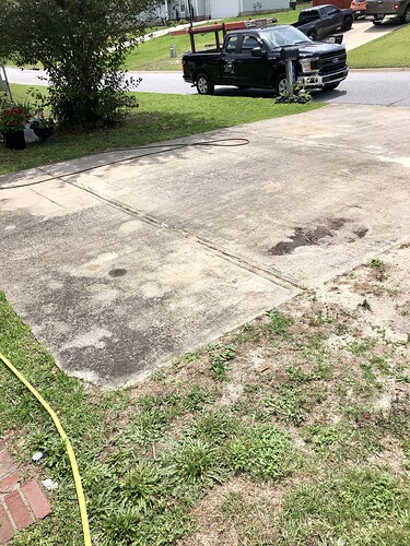

i went out earlier and it’s dried off ant it looks A LOT cleaner, looks really nice. it was one of the dirtiest areas of my patio too. i want to go over it a little bit more putting a little more shoulder into it to get a few remaining spots, but overall i am very happy with the results. going to take a while to do the whole patio though.

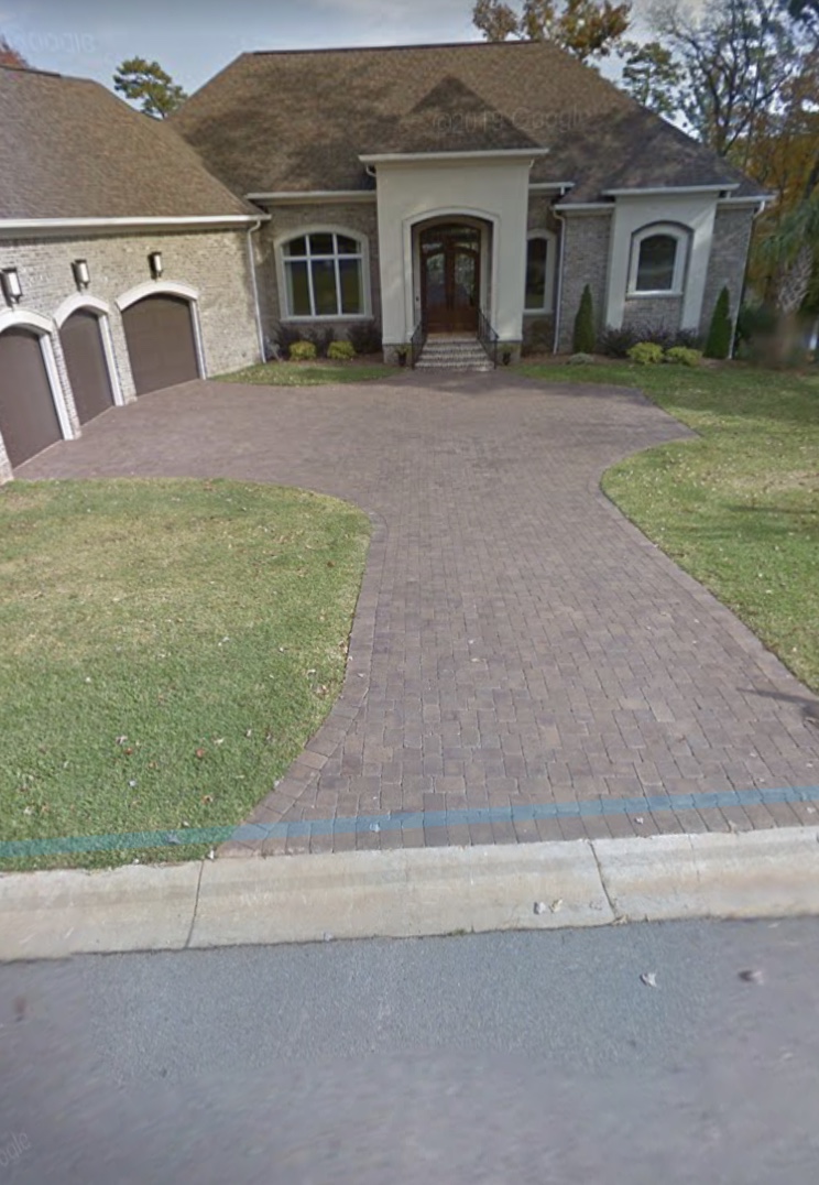

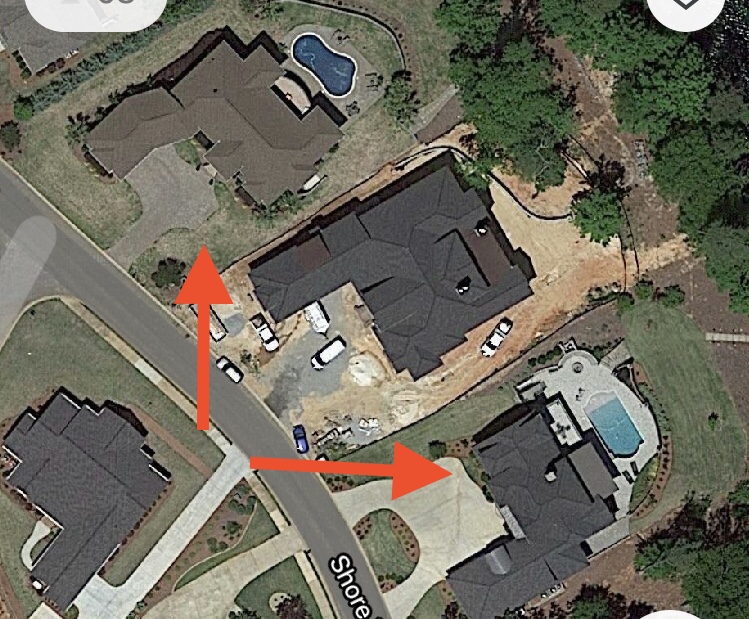

I’ve been asked to clean some flat work at two separate houses. The houses are on the same side of the street but have a house in between them that I have not been called to do. The houses themselves are WAY out of my league to be cleaning, and I’m thinking that the amount of flat work may be as well.
All flat work to be cleaned are pavers. Both jobs are being resanded by a landscaper contractor. Same contractor reached out to me to clean these pavers.

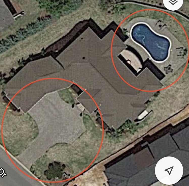

House one has two areas to be cleaned: paver driveway as well as paver patio surrounding pool. Landscaper is extending current pool patio area with identical pavers, but wants original pavers to be cleaned so as to match new ones. Once cleaned, landscaper will install new sand. Rough measurement is 3,700 sq ft. (1,700 in front and 2,000 in rear).

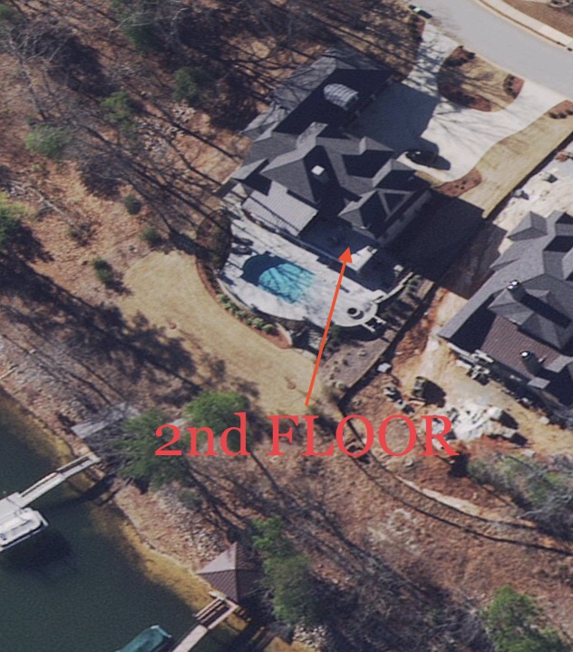

House two also has two areas to be cleaned: paver patio surrounding pool area as well as a second story balcony with pavers. There will be no installation of new pavers at this house, but landscaper will resand. Rough measurement is 4,000 sq ft. (700 up top and 3,300 below).
I know these are from the best photos. I had done three house washes Saturday before getting caught in an afternoon rainstorm and headed over to check these two out. When I hopped out of the truck to check these out in person I foolishly left my phone in my truck.
In my opinion, the areas don’t look horrible, but it was already wet when I got there. Second house has some very minor grass/moss growth in small areas. If I were to get this job, I would utilize my surface cleaner (very basic surface maxx pro 15") and likely just that if I could (other then having to use a tip to clean around corners, etc). If I have to, I do have the ability to torture myself and use a 2 gallon pump sprayer and pre-treat with 50/50 SH.
I’ve never done flatwork this large before, nor have I cleaned this magnitude of pavers. It’s one thing to mess it up and to take my lumping, but it’s another thing to possibly tarnish the name of a landscaper who is asking me to quote the jobs.

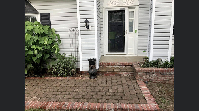

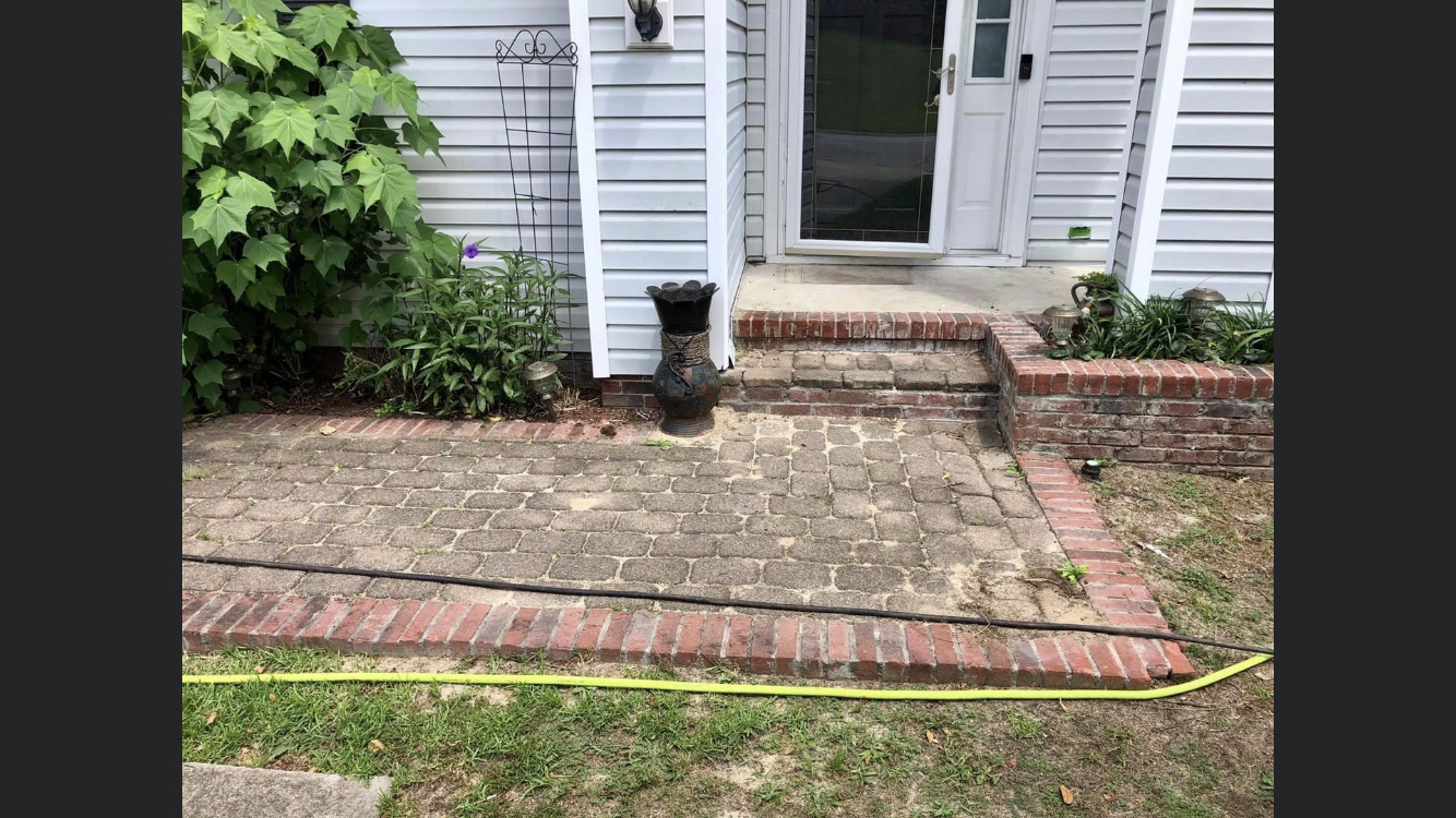

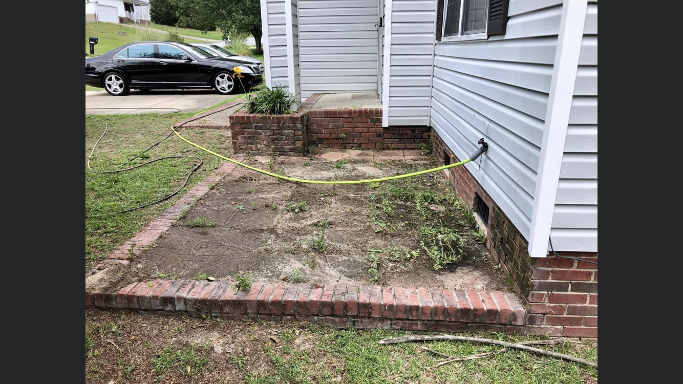

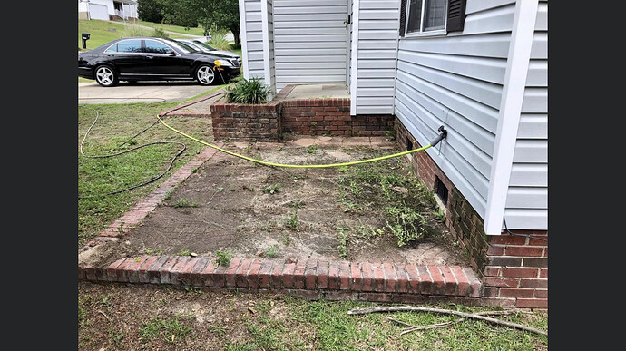

I did have a smaller paver job for someone in my neighborhood shortly after that, the customer did not want to pay for resanding or for weed removal so I just did a basic cleaning on it. I’m sure I’ll get one that I’ll have to resand one of these days.
Edit- I apologize for the pics being out of order
Did you pre treat and surface clean it?
Just HW mix and surface cleaner. Nothing fancy at all.
I would have taken care of the weeds for free just for a better before and after pics and to get a good reputation going. Looks like you should have went stronger on your pretreat, they are still black in spots.
Yeah HW mix won’t touch that. I usually hit those with 3-4% and turbo the bad spots.
I agree with all of y’all’s comments, but I couldn’t get the homeowner on board. This was a smokin deal I cut for a guy in my neighborhood. They were primarily focused on the home, and with good reason. image|690x387
