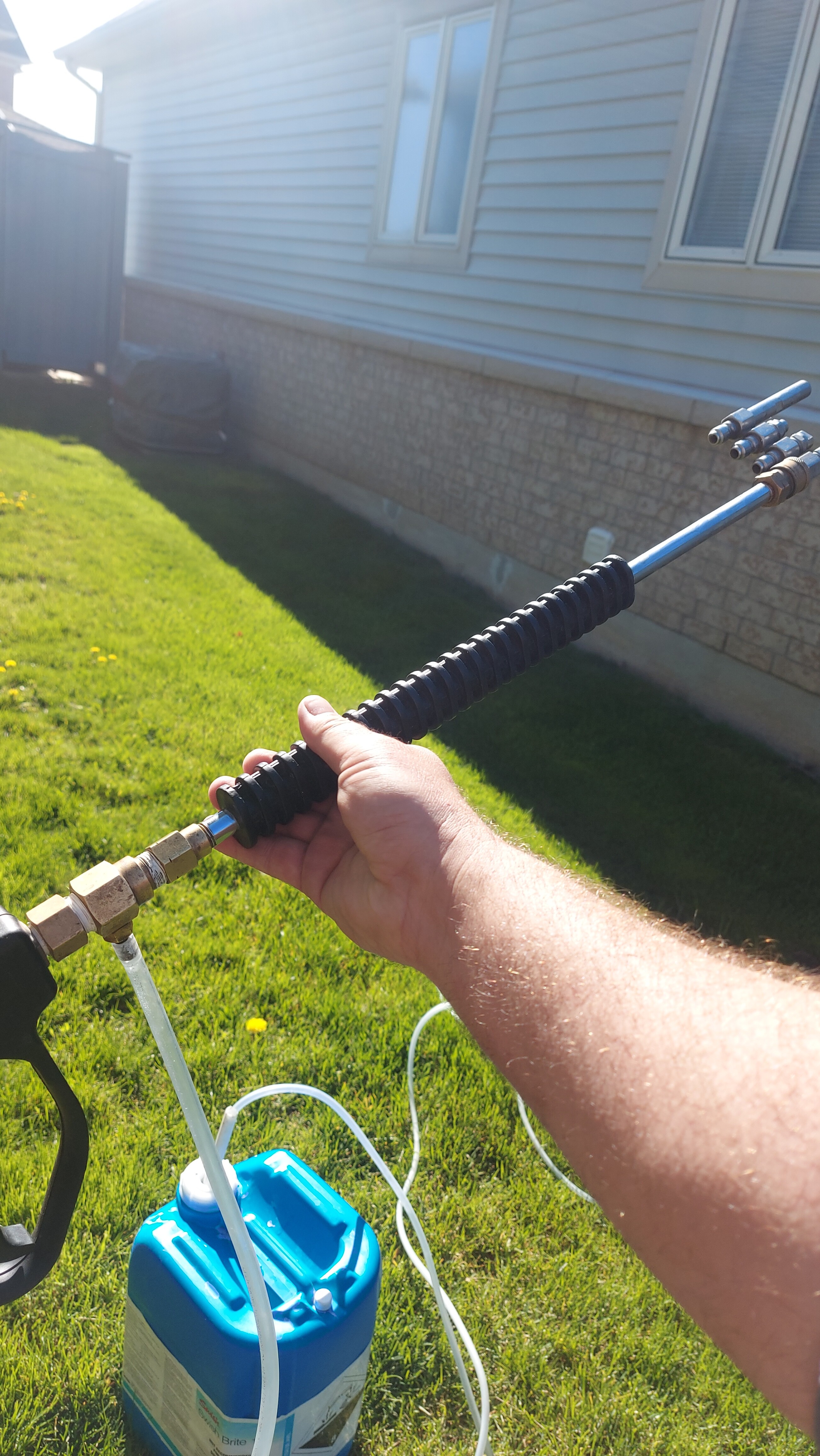

I think I’m similar to you, but with a 12v booster setup. I simply take spigot pressure and boost to 100 psi and use these guns to apply SH & elemonator. The gun connects to gallon jugs and I only use 2-3 per house
If you are willing to accept the roasting you will receive, I would love to know the details of your set up with those guns.

Here is a link to my post. I boost typical spigot pressure and use the gun I showed in that pic. I do this part time and can’t carry permanently mounted pressure washers or tanks, so I came up with this.
I have a 4 gpm pressure washer, but this is night and day better, faster, and more efficient

@Nickski actually has a pretty ingenious setup. Different from the typical 12v setup. He boosts the customer’s tap pressure with it, and uses an xjet style injector for the soap. So he doesn’t have the issues of poor flow, or running bleach through a pump.
He does have the drawbacks of needing to cart around the machine and his soap, but it’s easier than someone with a 4gpm wheeled machine and an xjet pail.
I don’t have the same 12v as anyone else. No need for me to lug around a heavy gas powered machine capable of 4200 psi when I only need 100. Plus, my system puts out 50% more volume than my pressure washer, so it’s much faster for me.

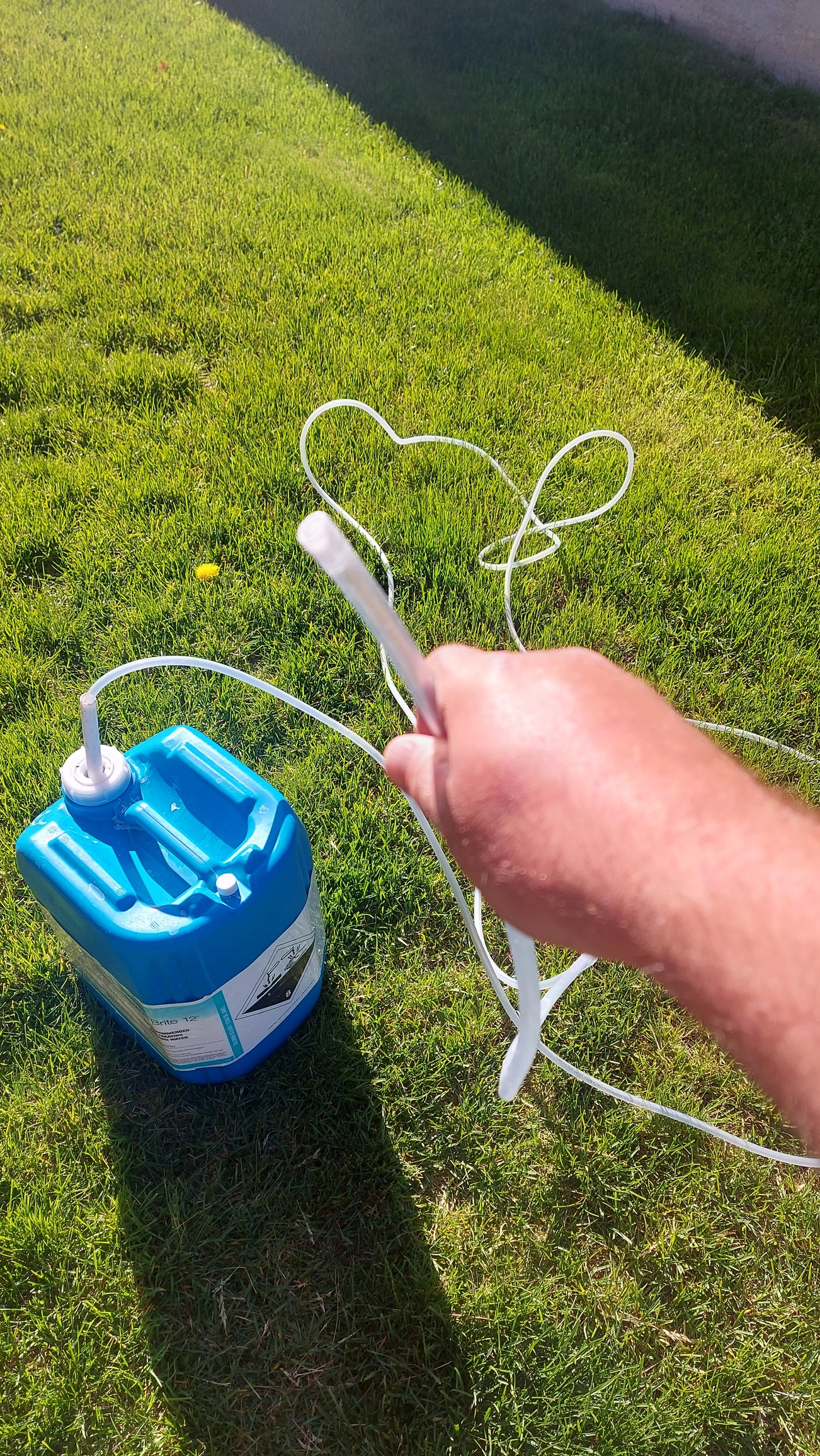

Does yours continue siphon out if you set the gun down? First time I used mine I found that out right away, luckily I set it down on a driveway and not the grass. I added a $6 fuel shut off valve right at the gun so when I’m not using it I can shut that and set the gun down and not worry about chemical leaking out.
We do this basically the same, but I’m just much lower pressure. Since I don’t need 2 hands on my gun, I went for a shorter hose and gallon jugs and just hold it down by my side. I’m more mobile that way and don’t have to worry about running out of hose or tripping over it. I do have a larger jug like you show in your pic for jobs that require a lot but I’m not moving around as much like pretreating driveways.
No, mine doesn’t do that
If my gun gets lower than the level in the bottle it will continue to come out through the gun. Now that I think about it, those injectors have a sort of check valve in them don’t they? A ball and small spring right? My gun doesn’t have that so I can’t set it down without shutting off the line.
I took the guts out of mine so I don’t have that ball and spring, and I still don’t have that problem.
I can’t understand how you don’t, physics say it should keep siphoning out…
So, how does it not spray water out the barb
