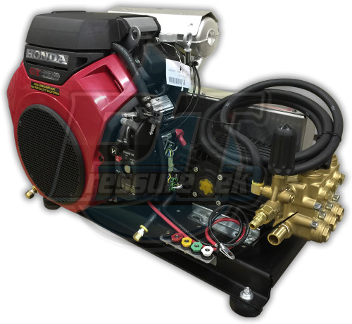

I ran a 4gpm @4K for my first year in business (last year) and want to upgrade my equipment for the start of this season. I have a 275 gallon buffer tank on a 6x12 single axle trailer so upgrading to an 8gpm machine should be fine. Trying to sort through the multiple options available for a bigger machine and trying to make sure I get the best equipment for the money. I can get an 8gpm @ 3500 from PressureTek for $3900…which is a General Pump / GX690 setup that includes a battery. Any other machines I should consider?

@Innocentbystander is the Water Dragon unit that is linked above (gx690 with Udor 30/24) closer to the advertised output of 8@3500? Or is it the engine output that makes it impossible? Trying to understand what causing the limitations.
The engine is not big enough to give both 8 and 3500. It can do either or. The one frequently advertised are 8 and 3000
Request a 25 or 27hp kohler and problem solved. The Honda gx690 is only 22.5 hp . The 25 hp kohler has the same torque @3600 as the 27hp does so they both work.
The down side is there is about $1000 different in motors . Between Honda and kohler
I have verified my 25 kohlers put out 8.1@3500 psi .
The kohlers have a 3750 high idle and run at 3550 under full load .
Psi was measured at the reel . I also run k7 unloaders the divert .5 gallon bypass at all times is set correctly
