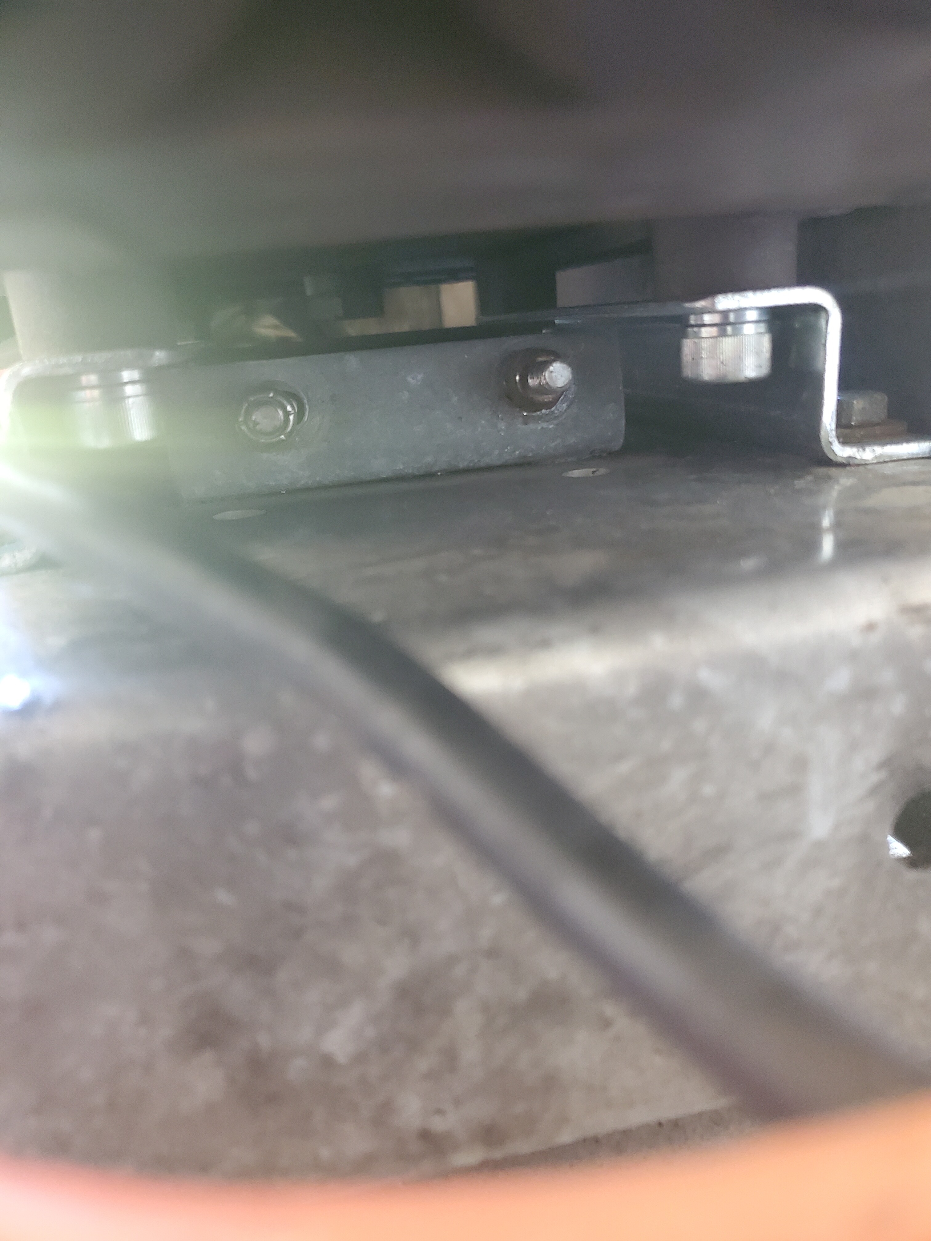

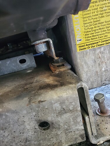

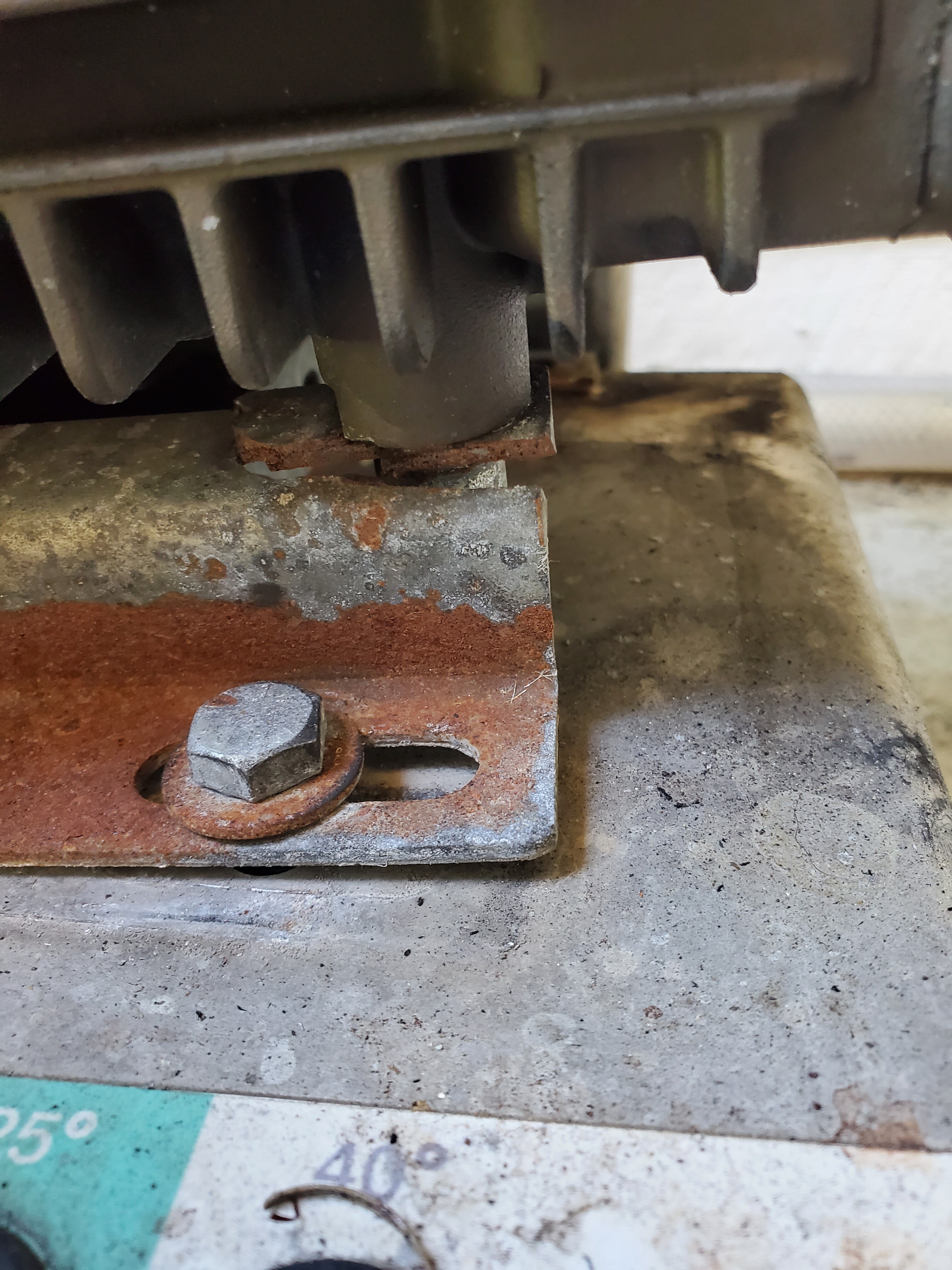

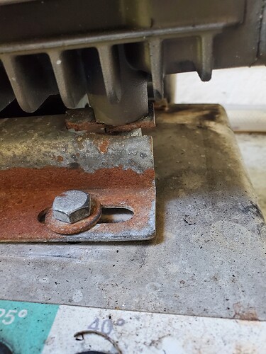

Hey guys. So the belt arrived and I wen to install it. When I loosened the bolts it wouldn’t slide. I realized the rails were torn. Completely shredded. Hindsight, the machine was rattling (but not crazy) the week before the belts went out. Sounded like the belt cover had lost some screws. What else could have been screwed during this oversight? What should I be checking on while waiting for new rails? Thanks in advance!
Upgrade to a geardrive while it’s apart. All that steel, rust, corrosion and fatigue to keep a belt tight will go away with the 4 bolts that hold a gearbox. It’s hard to watch you belt drive guys suffer like this lol.

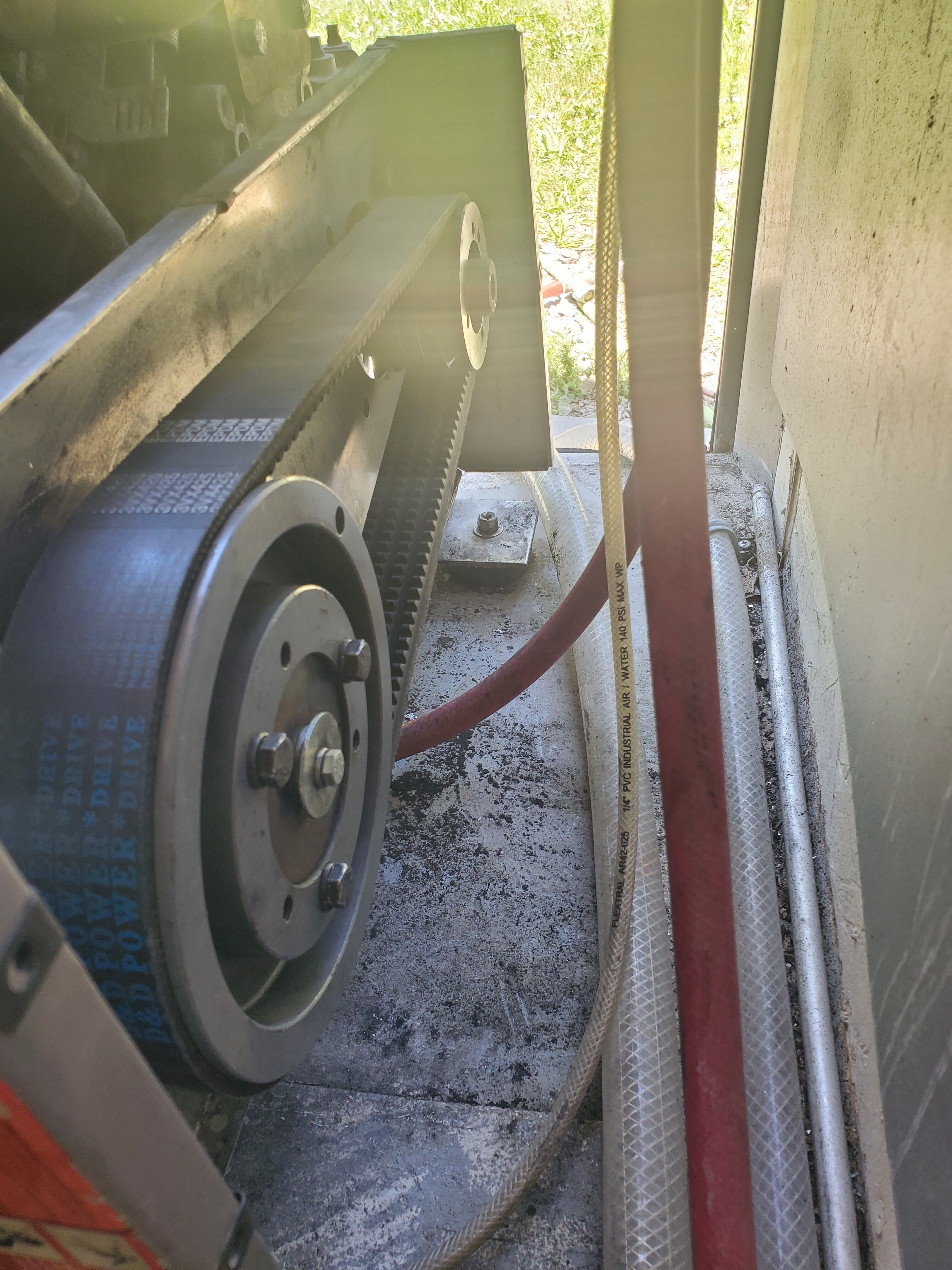

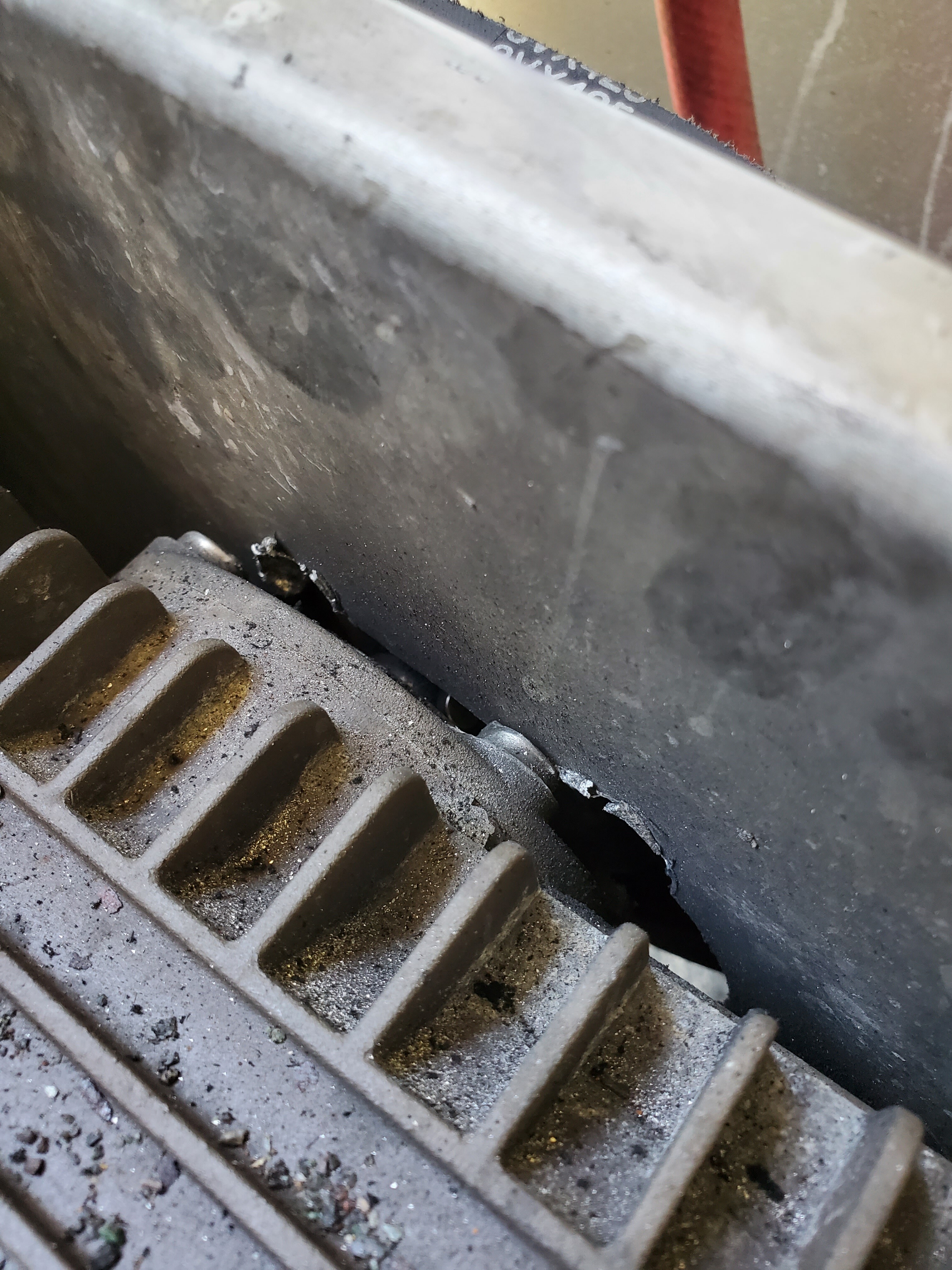

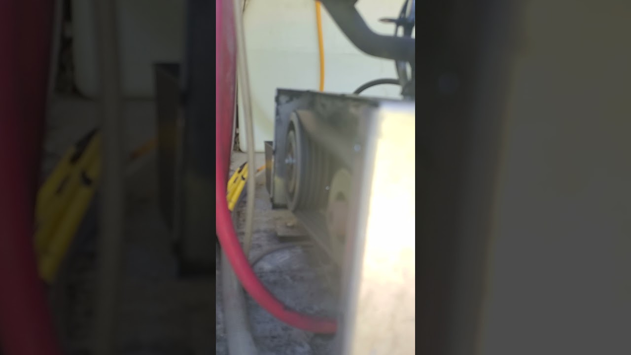

Ok. Now a week down. Ordering a Landa. In the meantime, I need to get this thing working. The rails were cracked. I pulled the pulley, the bushing and pump off. Replaced the rails, put in new tensioning bolts. Now, the back of the belt guard had no space to slide the pump so I drilled open some room for it to work forward and back (looks awful but I’m in a pinch). Put pump on leaving bolts loose, installed bushing and pulley. Next was belt. Keeping the pump square was not easy and I’m not certain it is. Adjusted the tensioner, locked down pump bolts.
Seemed to work fine but decided to test it washing my house. The belt slips after its hot and I work the gun then, smokes something terrible. Am I out of line on the pulleys? Open to any constructive help guys, thanks!
When I let off the gun there is a chirp sound.
Way to loose. It should barley deflect even tightened. Maybe you need a slight smaller length belt.
