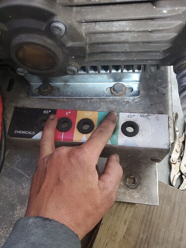

I will tighten as much as I can. The holes in the darn aluminum skid are wallowed out a bit making the pump impossible to get straight. The tighter it gets the more cadywampus the pump gets.
Get two pieces of angle iron and bolt on both sides of pump rails so when you tighten the pump can only pull straight. Aluminium has no business trying to be a skid
Thank you! I thought about that but i have no room on the belt side. Can I just 180 the rail and make new holes?

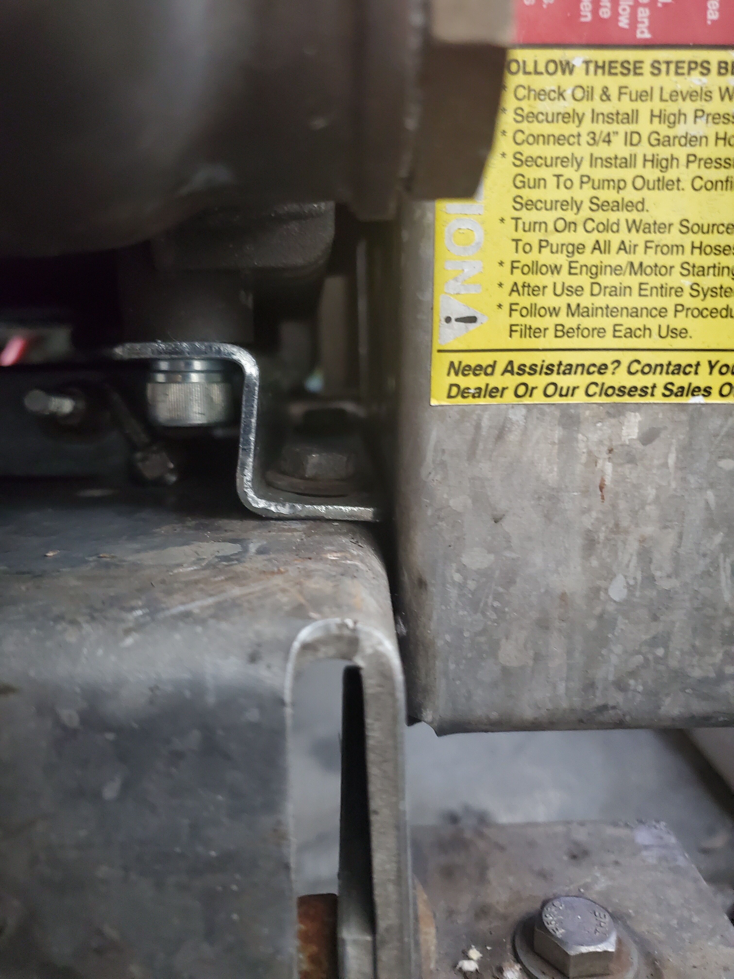

These pics show how bad its off as well as how much the bolt holes have wallowed.
How tuff is it to swap out for a steel skid @Innocentbystander
Call MVP, tell them you want a skid also when you go get your new machine :slight_smile: 8 holes to drill. That’s it
