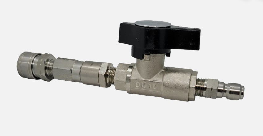

Im about to buy a quality ball valve but i need some advice. Ive read the debate on how to set them up, male at the end nice for rinsing female at the end so if the o ring fails it blows away from you. Ive also seen on youtube someone with a male in and male out which makes the most sense but then id have to change my tools to have female couplers instead of a male plug. I guess my question is, why doesnt everyone go male male? Is it worth the hassles of changing my gun and surface cleaner from male to female qc. Especially given theyre done with lock tite

if your bv looks like that with that handle, get a real dn10 with the stubby handle. easy turning.
Here is a link to some ball valves sold by a company that does a fair bit of business in the U.S. I think you are overseas, maybe an aussie, so look for something similar. Just make sure it is rated for your pressure (obviously) and that it can handle heat if you use heat. Not all ball valves are designed to handle both. There is a grumpy fella on here that will tell you just use your gun and plum everything through it with the male leading.

This is the one i thinking if getting
Ohhh so male out of the gun, then female with a tip screwed into it or female with and extention ?then what does he get rid of the gun on his surface cleaner and replace it with a female coupler ? Is that a bit dangerours ? Wouldnt he still have to shut down and release pressure to de couple?

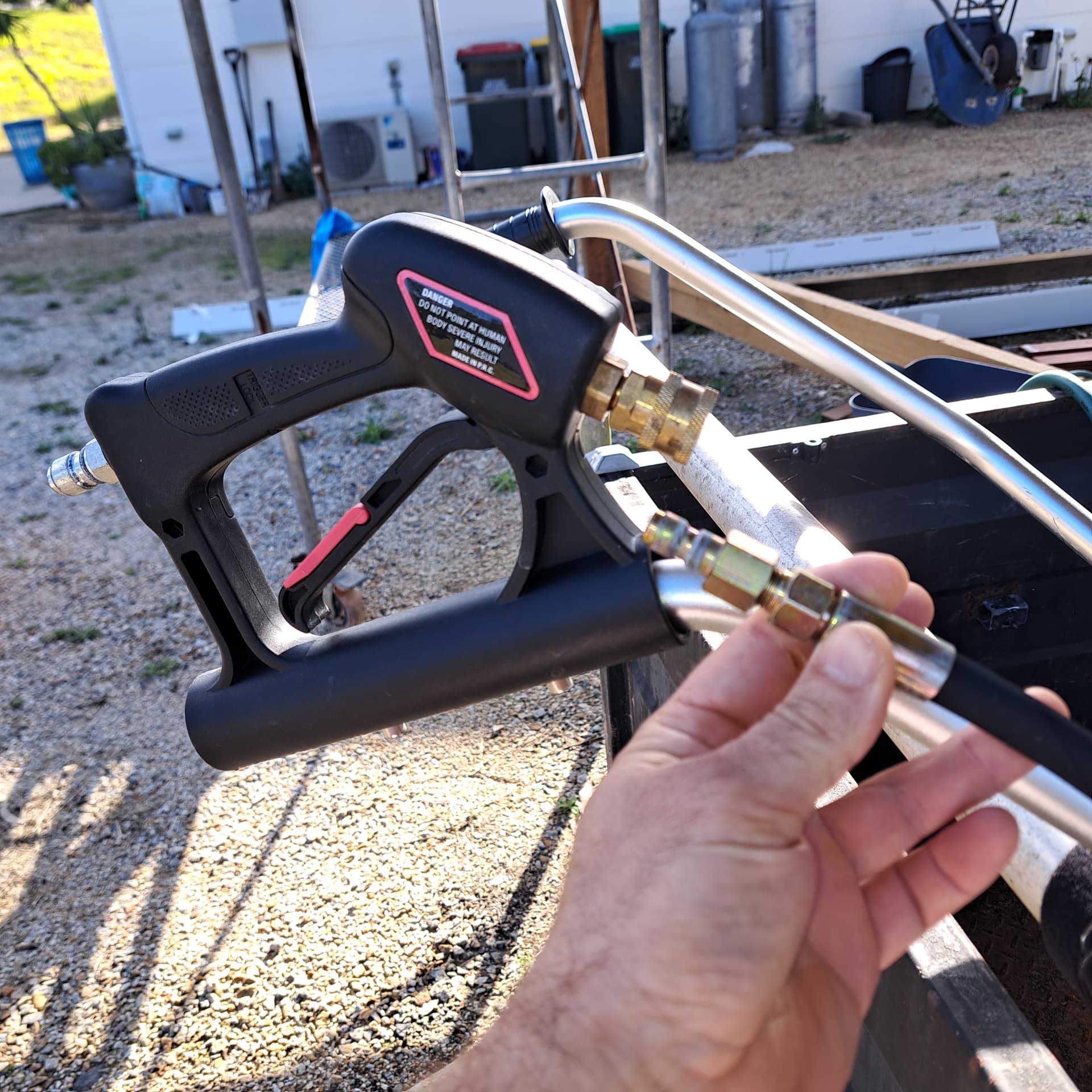

No, you don’t turn the machine off. The gun stays on the pressure hose, so if you need to change wands, or add a turbo nozzle, or snap on a jrod, the gun trigger isn’t being pulled so it lets you do that.
Once you get a Whisper Wash Ultra Clean or the like, take the gun already on there off and throw it in a bin, then add a male quick connect. Voila, snap the gun into the surface cleaner. @Innocentbystander taught me that.
When you REALLY get in with the cool kids you’ll install a K1 unloader and a remote bypass😆
Wow i just assumed the qc at the end of the gun wouldnt release, i just gave it a go thats so easy!
My next question is how to I attach my gun to the SC ? I already disconnected the qc from the original, and removing the gun is just a few screws.
EDIT :- I can see some of the high end SC have the male plug comming out of the handle i guess thats why it works :sweat_smile:

AUSTRALIA. I can buy a whisper at somepoint and run everything off the gun but at the moment i can swap nozzles at the gun but unless i retro fit the gun to the sc ill need to buy a ball valve or turn the machine off which is a bummer cause the amount ill spend on a nice mtm valve and swivel i could have added to my sc budget and got a whisper 16 oh well

ALSO, get a Mosmatic 3/8" high pressure swivel to put before the ball valve. I promise it is 100% worth the added cost!
There is absolutely a wrong direction. Male end leads. Period. Friction loss. Every hose in the world leads with the male end for a reason, from garden hoses to fire hoses. There is also no good reason to own a ball valve. Every wand and surface cleaner you use should quick connect to your trigger gun. If your surface cleaner doesn’t, then you don’t have a good surface cleaner.
But without a ball valve, you have to turn the machine off, switch tools, and turn it back on. That’s a ton of wasted time and energy. With a ball valve, you simply close it, release the pressure from your wand or surface cleaner, switch tools, open the ball valve, and keep working. No walking back to your rig, even if its portable unit.
