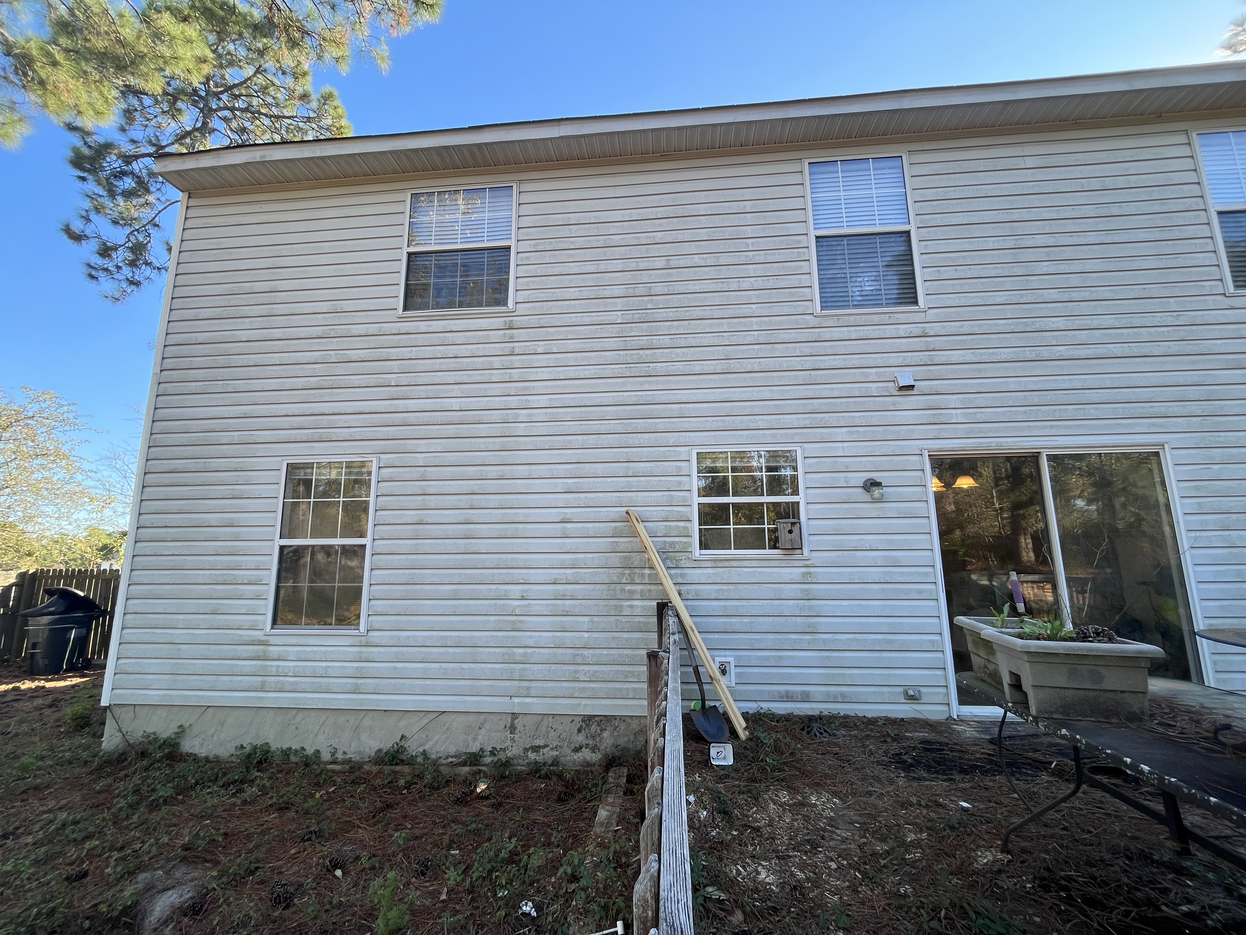

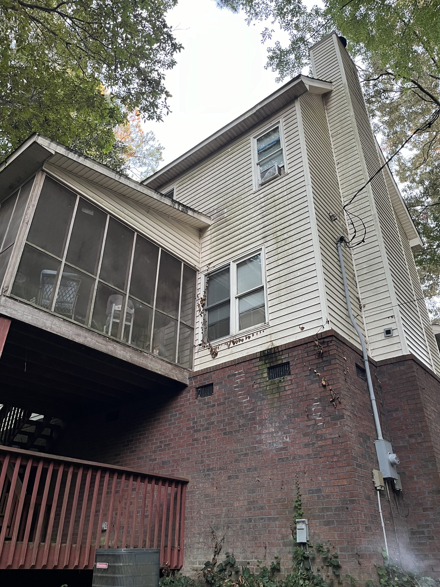

A 24’ ladder got me up to this roof line, leaning against the roof.
But not this one

Most roofs I don’t need any more than a 16’ ladder to access. I typically put the ladder on the front walkway by the front door and go up there then just move about the roof as needed. However, my terrain is considerably different than most I would guess. Nothing unusual about seeing a “single story” home here with a 40’ drop from the roof in the backyard. I’ve turned down a couple that gave me the heebie jeebies just looking at the drop in the back from the ground lol

Stabilizer arms at the top, good to know! Aluminum - yes… Some daunting pics. lol

That’s the majority of roofs in my area. I’m in the Ozark mountains so houses are quite literally built onto mountainsides. They will build them to be basically street level at the front of the house but the backyards are essentially just dropoffs into valleys. Biggest ladder I carry is 32’ and that doesn’t come close to reaching the roof line on most of the houses I wash.
