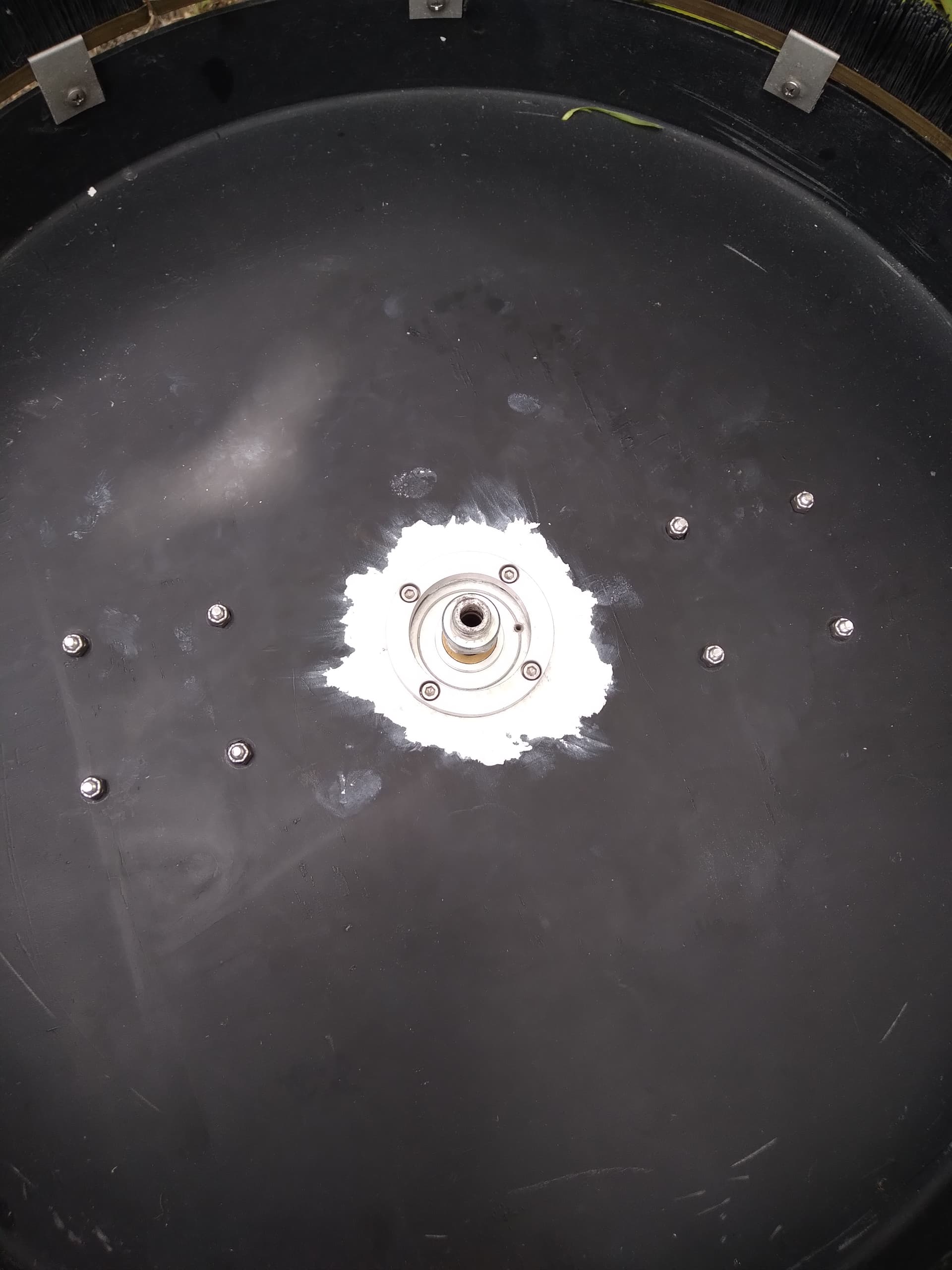

Here’s some of the repair:
That’s one reason why it’s a firing offense with me to lift a surface cleaner before it has stopped spinning
You should have a steel or aluminum plate made to tie the handle mounting holes and union mounting together instead of relying on JB weld.

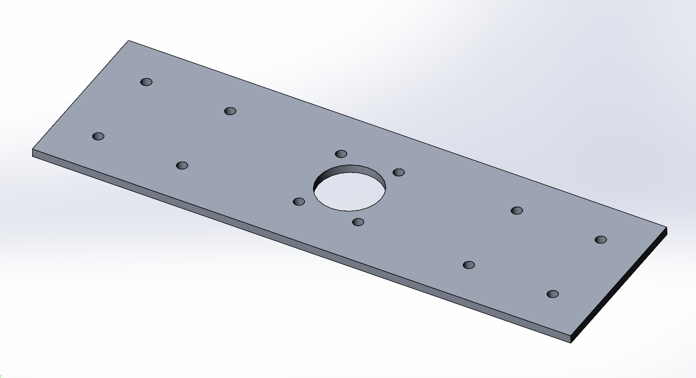

Yeah I was actually thinking about that. Is this plate a thing or just a drawing?

I just threw together a quick CAD model for reference
If you use a plate, be sure to pick up longer bolts.
The strength of the JB weld is 4370 psi so hoping it will hold but may look into getting a plate constructed.
Just got to home Depot or Lowe’s and get a thin piece of tin or something the size of a license plate. Doesn’t have to be thick. Pop rivit it in, drill holes and mount your swivel and bar. Just need to distribute the stress.
Hell, just use a license plate. If it’s good enough for patch panels on your going to town car then it’s good enough for a surface cleaner.

It’s heavier now but it’s sturdy.
One thing I noticed is that on the 16" Ultra there’s a plate on it as part of the design. So I don’t understand why WW wouldn’t put one on the bigger unit especially when there’s a heavier bar and larger cover. Drilling the hole the right size for the swivel on the plates was important because if not, there won’t be room for the drill holes for the swivel itself. I went with 2 1/8" on the cutout.
