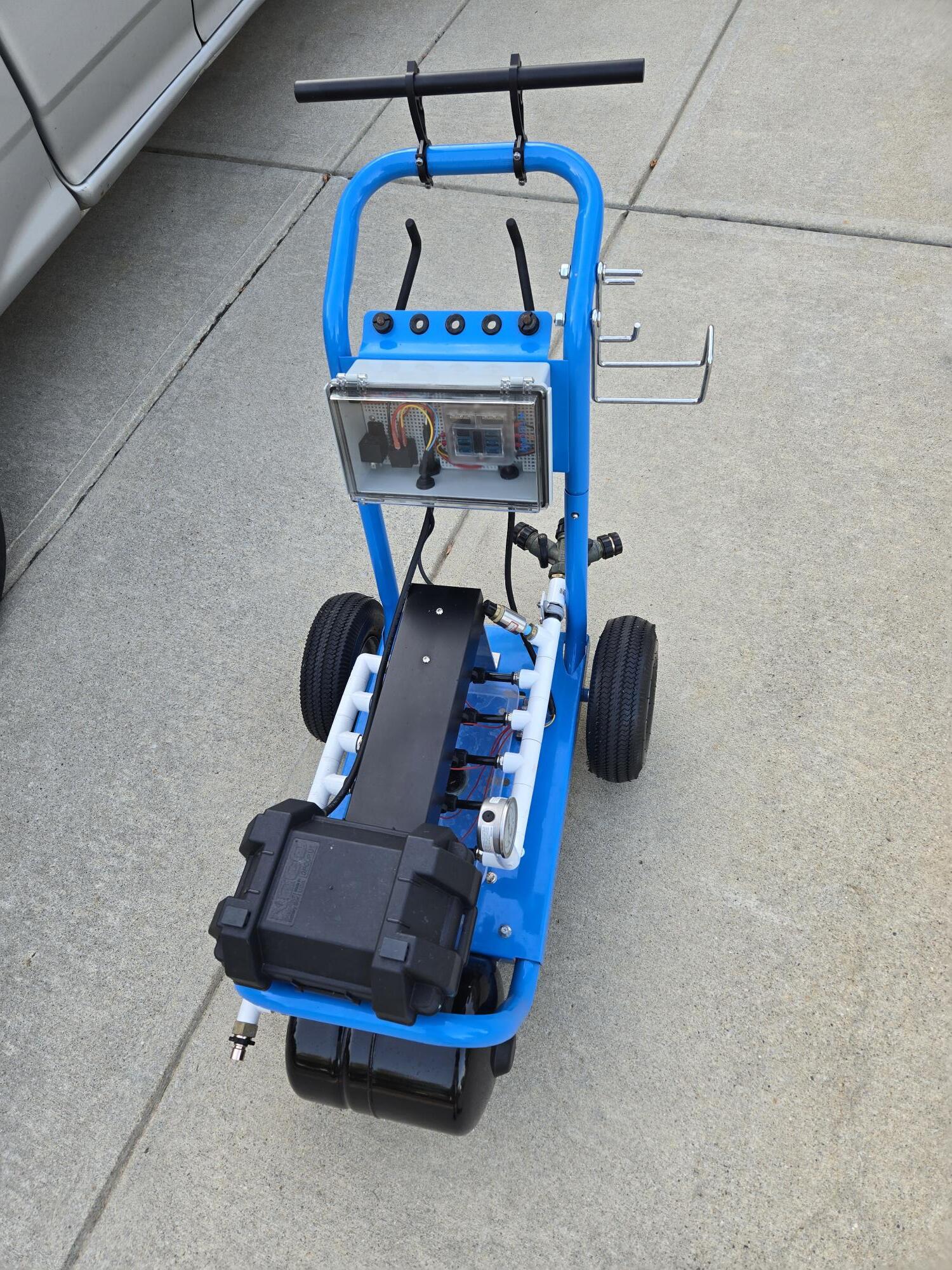

Noise, weight, heavy/expensive pressure hose, unloaders, tanks, reels, etc. All of these are reasons I do my house washing so differently by not using a pressure washer. Having a way to apply cleaner and rinse with a simple on-demand booster system is exactly what I set out build and feel my current design does that well.
My system seems odd, maybe even cheap, unprofessional or inefficient. I’ve found it the best option for my being part time with no dedicated truck or trailer. The little bit of inefficiency I have with volume and pressure is made up for with efficiency in size, weight, cost, maintenance and speed of setting up and putting away.

Every time I see that I think to myself I should make one like that for the jobs with no concrete to clean or the smaller houses. I could just put it in the bed of the pickup and watch my gas mileage double without the trailer.
This unit is why I can take the “HOA notice” just clean the north side jobs. I just toss this in the back of the truck and go. It has a lithium battery in it, so it’s light enough to just lift up over the bedside and I have a little mount screwed to the bedliner so it doesn’t move around. My guns and hoses are in the toolbox of the truck. Since it’s only about 90 psi, I just use those light expandable hoses. Just doing one side I only need the 25’ hose which shrinks down to like 8’. Easy peasy, 15 minutes from roll up to roll out.

The problem with those pumps is that they need to draw from a tank. I tried to use a better pump like that as just a booster and they can’t handle high inlet pressure from hooking straight to a spigot. That’s why I use a series of small, cheap diaphragm pumps.

Yeah, but you have to think on how you would plumb that. It gets pretty ugly trying to fit a Hudson valve (or some other on/off fill valve), pickup for the pump, pump, battery, wiring, etc.
That’s why I kept it simplified a bit and just found pumps that could take 50-60 psi of incoming pressure. Small accumulator tank on the inlet for when someone flushes a toilet inside, very small tank on the outlet to keep the pulses down and the flow smooth. No tanks, no valves and all fitting nice and compact onto a cart. No matter what the spigot pressure is, it builds to a consistent 90 psi. The gun for applying hw mix uses a #50 nozzle and my system maintains about 70 psi while spraying, netting about a 7 gpm actual output flow at the gun. Better than what a rated 7 gpm pump would do.
A Jobe valve with a garden hose fitting and a bulkhead to the pump would be easy enough. I’d have to double check but I thought most 12V pumps (or at least the ones most of us use) can handle up to 100 psi incoming.
