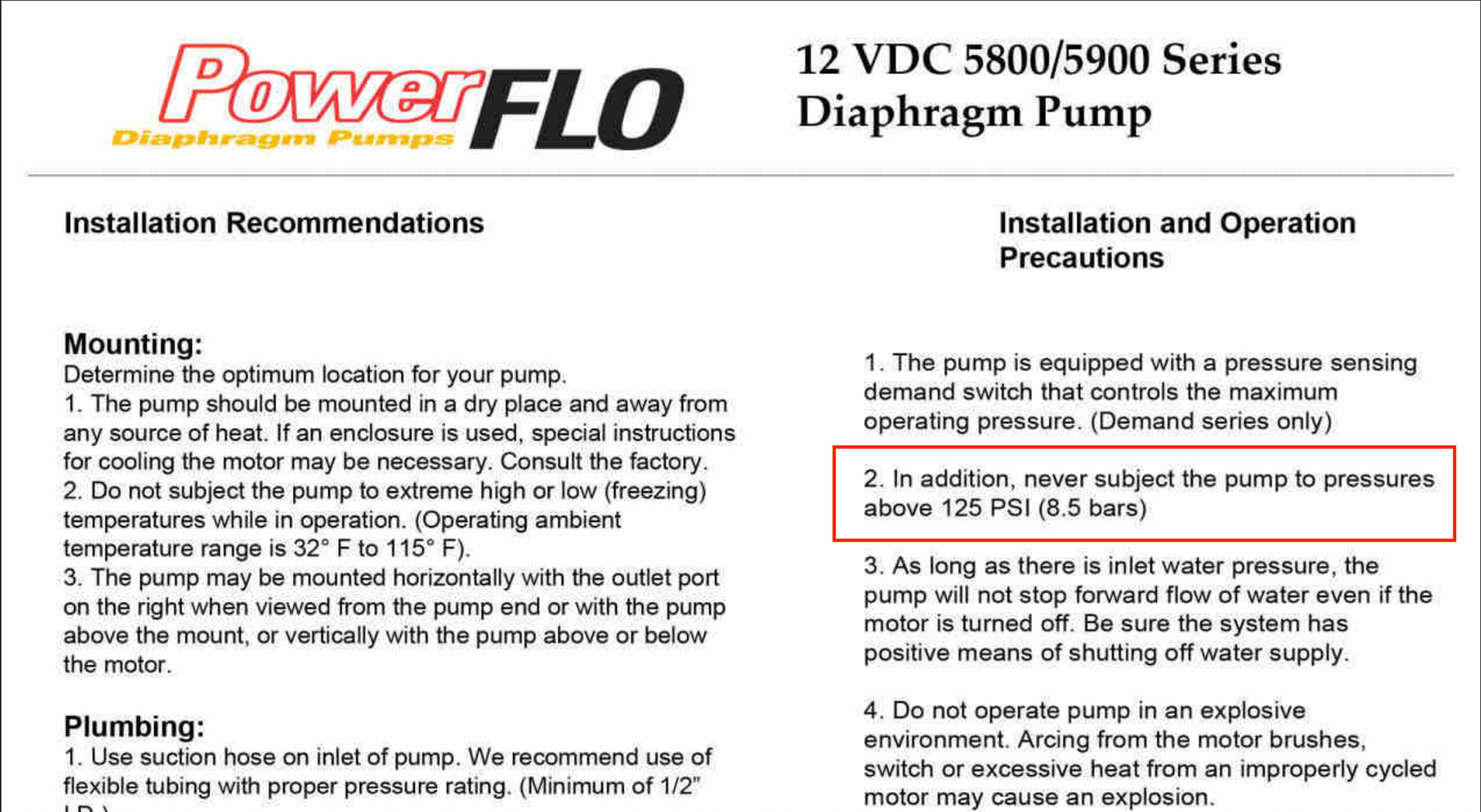

I thought I’d read that some Delavan pumps (maybe the Remco Fatboy as well) shouldn’t exceed 125 psi inlet pressure, but now that I think about it, that might have applied to their lower-GPM models or been referring to open flow conditions.
Edit: Only literature I’m finding is for their 5800/5900 (2 - 5 GPM) series pumps. I might be misunderstanding what they claim here, but that seems to imply it can be force feed.
You can….i have a fat boy.
