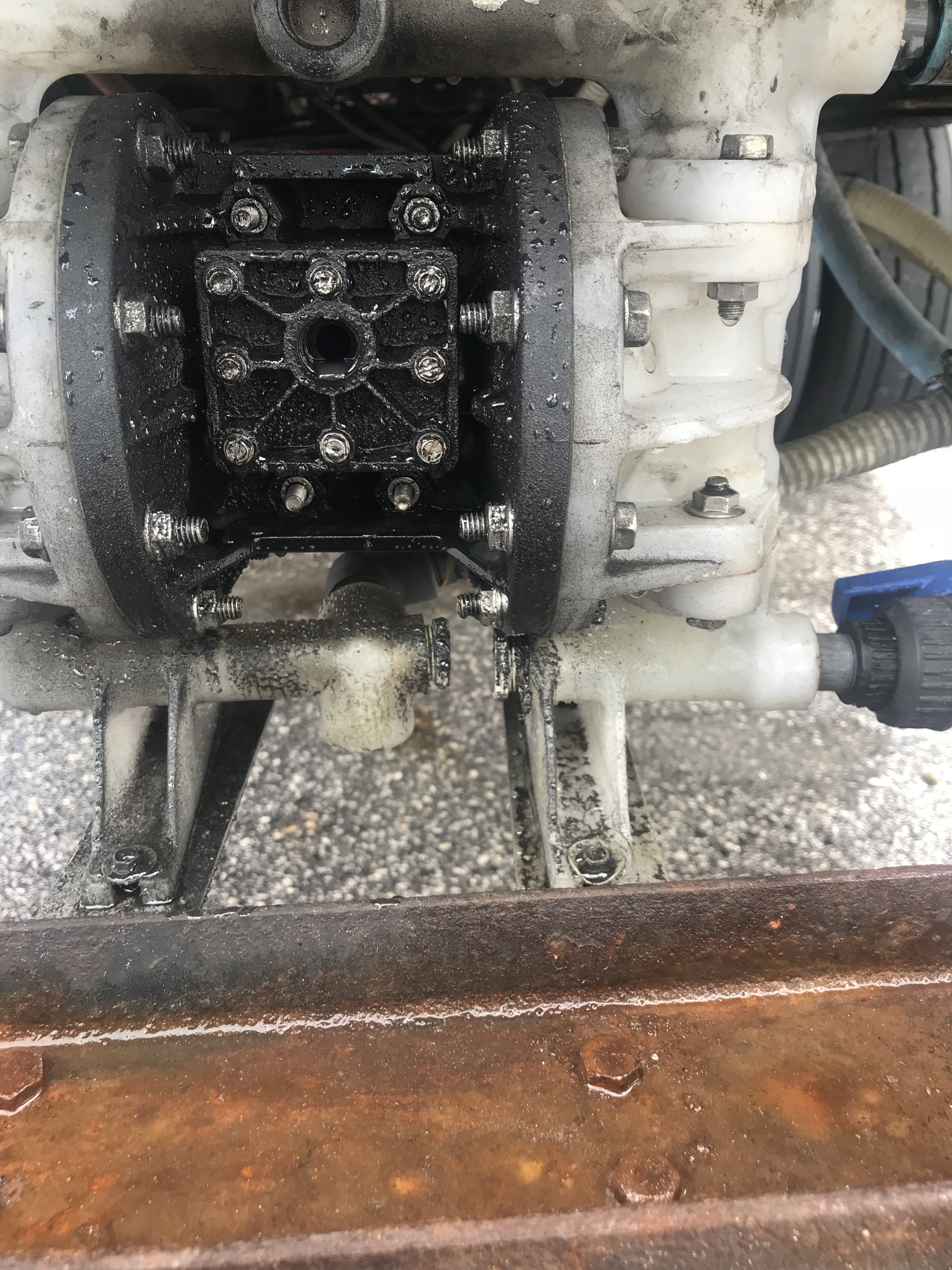

I have a Allflo 1/2” air Pump. I am on my Third air valve in 8 months! First one replaced after 30 days, last one replaced about 1 month ago. Just the other day I’ve now got a small leak coming out of the exhaust. Regulator set to 85ish psi. Pump runs “ok” with a small nozzle. But when you put on a #30,40,50 or no nozzle at all, after about 1-2 min the pump seizes up.
Hoping to see if others have had the same issue, what they have done to fix it since the dealer is of no help to me. I was sold a lemon pump and had nothing but excuses.
Pump only has about 150 hours on it.
Do you have a good water separator?
Air pumps do not like moisture what so ever, some more then others.
I just bought a tsunami, my other one was letting in a lot of water. My pump would start making a horrible high pitch sound once it started letting too much water by.
You may have got a lemon, i dont know too much about the aodd pumps expect they dont like water on the air side. Post in the roof cleaning forum, a lot of them run these pumps and know a lot more on them.
Spoke with tsunami engineer. Basically I need a dryer for my air compressor. The air charge needs to cool down to like 0 degrees to remove all moisture and droplets.
A lot of it has to do with the pump consuming 15cfm of air every cycle. The psi goes from 60-85 every cycle. So it’s screwing up the air flow, not giving it enough time to cool down some.
Right now when I put my hand against my muffler, I’ve got small pieces of dry ice pelting my hand. Looks like very small rock salt.
