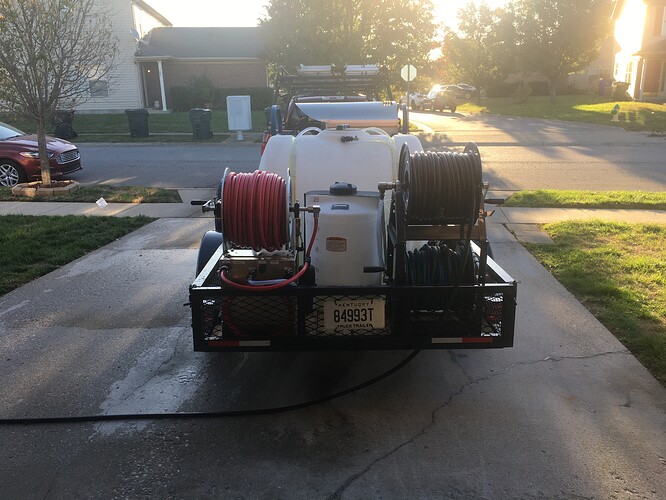

So i’ve had my 5x10 PJ trailer for a little over 2 years and i love how tiny it is. I can go through drive thus and get in anywhere without a problem. The only problem is that it is tiny and i have outgrown it pretty much the day i got it. I have a few issues and i need input. I have my ideas, but i want to hear yours. I’m very anal about things being as neat as possible and very efficient. I’m willing to drop some money into this as well.
  1. I want somewhere to hang 2 surface cleaners and my wands. I’m thinking similar to a landscapers rack that holds weed wackers and stuff
  2. I need somewhere to put my 12v and enclosure it’s going to go in. It has to be small and compact because i have no room. This is priority right now.
  3. I don’t like my reel set up. It looks messy, mismatchy and unorganized but i dont know where i could stack them.
I was thinking of taking the small black toolbox off, under the cheap garden hose reel, putting that reel on the deck of the trailer and weld up a “platform” which would give me lots of space. I tried to draw it out the best i could.

I really do need to take it to the scales. I try to run with as little water as possible, I was just messing around in the garage, i usually dont have that much water. Are you talking this style ladder rack?
I was thinking if i went with my amateur drawing style of modification, I could line up all 3 reels on the curbside right next to each other and mount some toolboxes on the rear of the platform, to include the box for my 12v

Depending on your current weight you could do something like this like @SESclean did, granted he’s in a 5x9 trailer but it’s close:
Pic from his thread
ooooo theres some good stuff there. I like the upside down reels. And the hanging of the surface cleaner is just what I was thinking of. Now i need to convince my wife to let me get a new welder!

I have 5x10, double stacked water and pressure lines. Have compact Gen 2 12v from power wash store. It has a small footprint, you can build one obviously a little cheaper but liked that it had all you need in a small package. Of course you could turn the stack to the side if you like them coming off the side. I have vertical chem tank too. I’ve outgrown mine too already, end of this year going to a flatbed style system, use trailer for other jobs. Anyways…
I like the way the reels like, but i think i would turn them to work off the curbside. I like to be able to pull the hose out as i’m walking to their backyard or something

No build the rack on the the trailer it will keep it lower in short so it helps
Then hang your reels off of it. On the curbside like the orange trailer
I was going to mention the ladder rack out of square tubing for reels too. You can store all sorts of equipment off of it. Try and find Racer’s old trailer build video on here. Same idea as the orange trailer above but some other ideas might catch your eye. His is a 14’ dual but shouldn’t matter.
