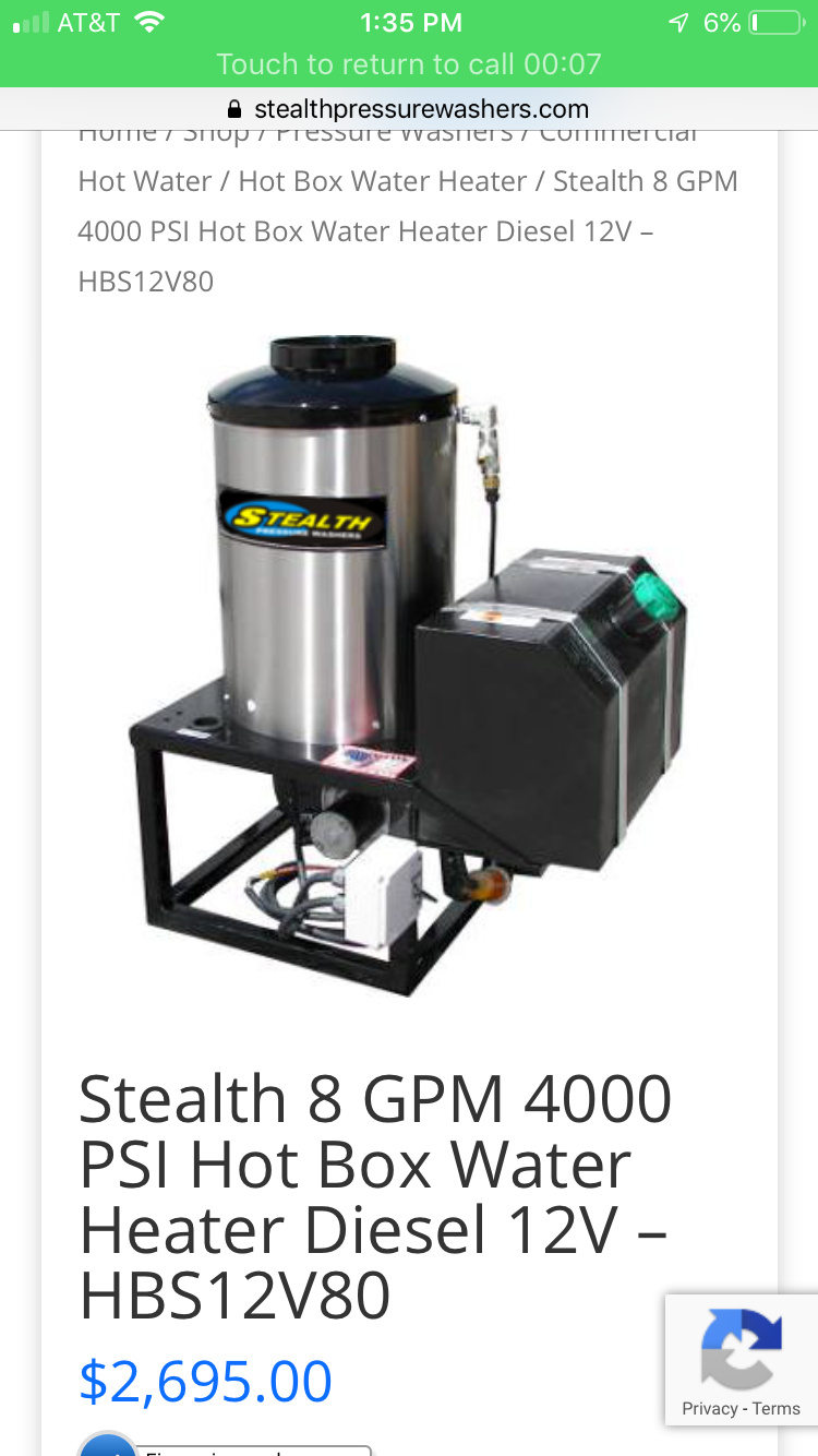

I am building this unit now.
I was about to buy this hot water unit below to feed out of two gx390 units making 8gpm…
I am thinking of now buying this unit below.
I would then be able to run my 2 - gx390 cold and a dedicated hot water skid at the same time form my 275 gal buffer (obviously we would need to be mindful of use time while working together but still good)
So plumb two machines into one line, feed it to the heater, seperate the exit line into two hoses and wash.

Okay okay so my plan is to just send the two machines through the hot water unit and then normally out of the hose.
So you are gonna send two machines to one heater and keep one gun at the end like a simease kit.
If you are not running this full time than it might work for you. Keep a spaire simease kit. If you are running it full time than get the 8 and don’t mess around with a setup like this.
Also, keep in mind you are most likely gonna have lots of problems down the road. I see this being a once a month setup at best. Just to many things that can go wrong.
I am surprised I spoke on the phone with some guys that build these and they said Siamese joining of two 4gpm works like a charm…
It does work like a charm until something fails. If you are going to be using this full time order two of the kits from russ.
or better yet get the 8gpm. This is your money maker. The thing you don’t cheap out on if possible is your equipment.
If your gonna go PP ,midas well save yourself some Benjamins and free shipping. But if you got the coin ,I’d go Landa,Hotsy,Hydro Tek or Alkota… And get a dbl axle trailer.
My 2 cents.
