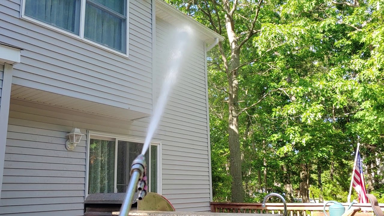

My 8 gpm, 3k psi with a K7 is surging. It only happens after the machine has been running for an hour. The machine surges with a weird noise and looses pressure. It also does it in bypass when I’m off the trigger. When that happens no water bypasses for a second. Same sound from the machine. First video you can’t see loss of pressure but you can hear it. 2nd video you can see a little better the loss of flow/pressure.
Its seems like it’s not getting water the way it loses pressure/flow but the buffer is full and the filter isn’t clogged.
