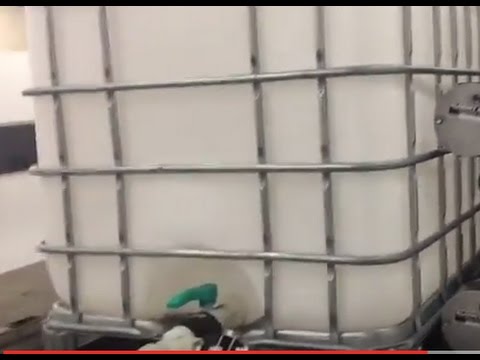

Iā€™ve seen a lot of guys say that black corrugated drain pipe works good for a baffle. Also the orange construction netting. Cram as much of either as you can get in your tank, and it is supposed to make a pretty big difference.
You can also buy special baffle balls, but they are more expensive than these methods.
Hereā€™s a video @Jason_Geiman1 made on the drain pipe:
