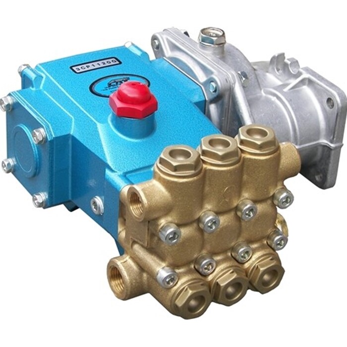

I’m not real familiar with cat pumps except they are noticeable when you see them b/c of their unique color. Are they in a category by themselves since they don’t appear to be gear or belt?
No, not at all. They have direct, gear and belt. Can you upload a picture of the one you saw that was weird? Is it like this one?
1000003036
Yeah, that light blue to me screams out “cat pump” whenever I see it. But I’ve never seen one with a belt or gear so I just assumed direct drive or in a category of its own.

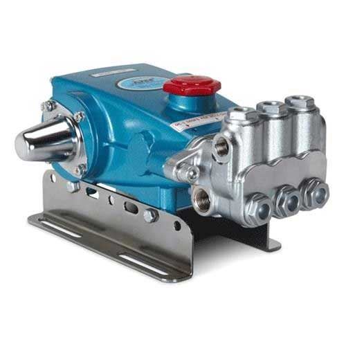

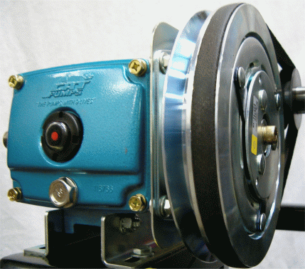

Gotcha, here you go. Now you’ve seen em :grin:
1000003038
Definitely never seen the belt one before. And I don’t even think I’ve seen the gear drive. Usually I see them on nicer homeowner machines so I’ve probably been seeing the direct drive.

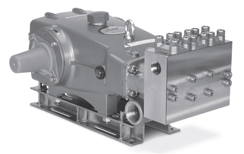

@qons Cat pumps are HUGE in the car wash industry!!! I’ve been in numerous car wash coin bay pump rooms and have seen pump rack after pump rack and its Cat after Cat. Their tag line is “the pump with 9 lives” and it’s the truth. They also have some really sweet INDUSTRIAL offerings 40-50gpm. They don’t mess around, they need to just leave the direct drive market alone lol
1000003040
1000003042
1000003041
Notice all those pumps have lifting eyes lol
