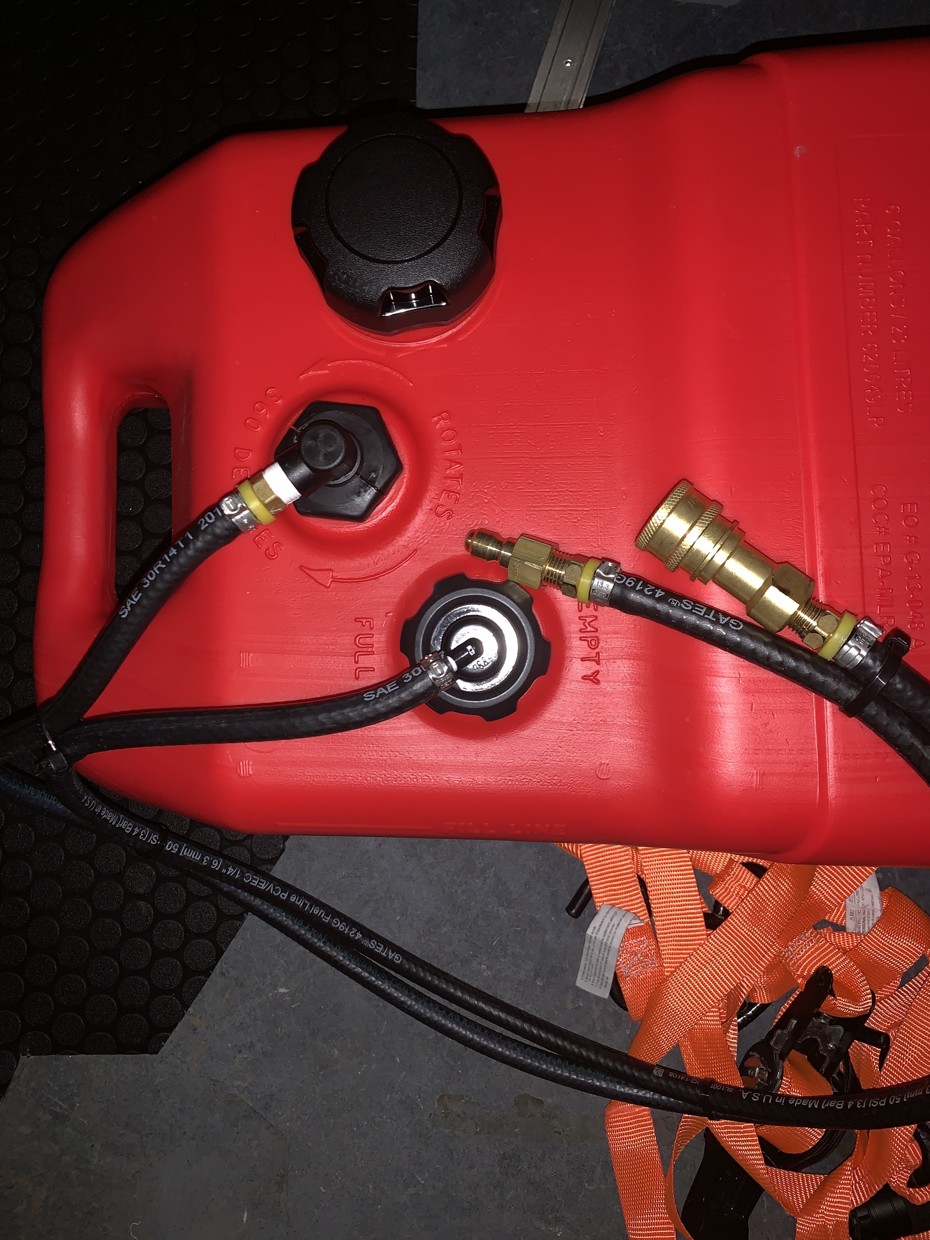

You can put a T on the one block coming from the gas tank and feed two machines. I’ll snap a pic for you tomorrow

Red circle used to be your fuel gauge so I bet it’s a vent line. The green circle with the swivel is actually your pickup line and the one that matters
As long as green arrow goes to green circle, you could likely just put a fuel gauge back in or just cap the red circle side.

Just connect the green side QC and you’re ready to roll. On a bigger tank you can use a barbed tee for the two “green side” fuel lines. The 690’s will pull all the fuel they need.

We’re you able to get that picture
