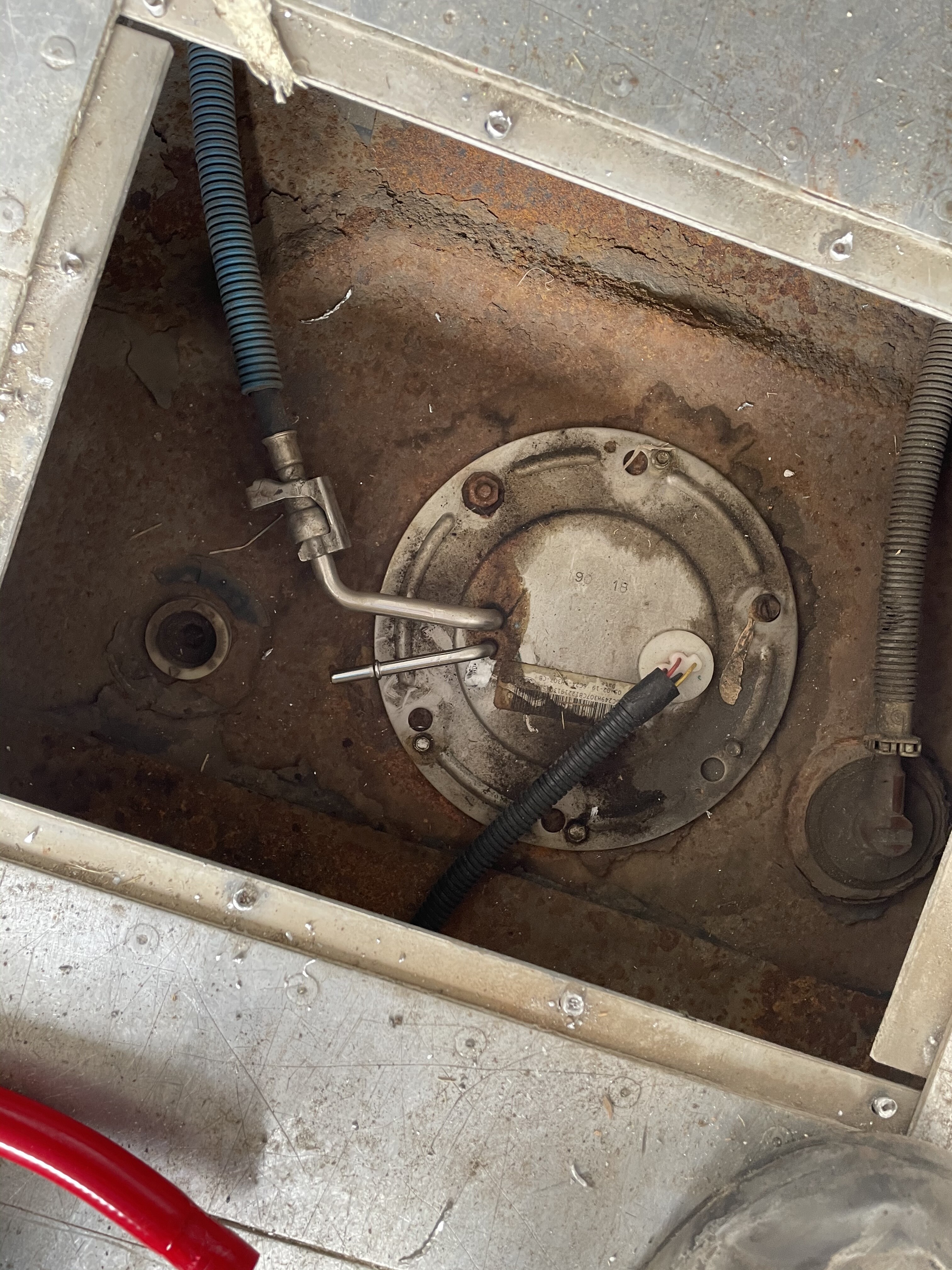

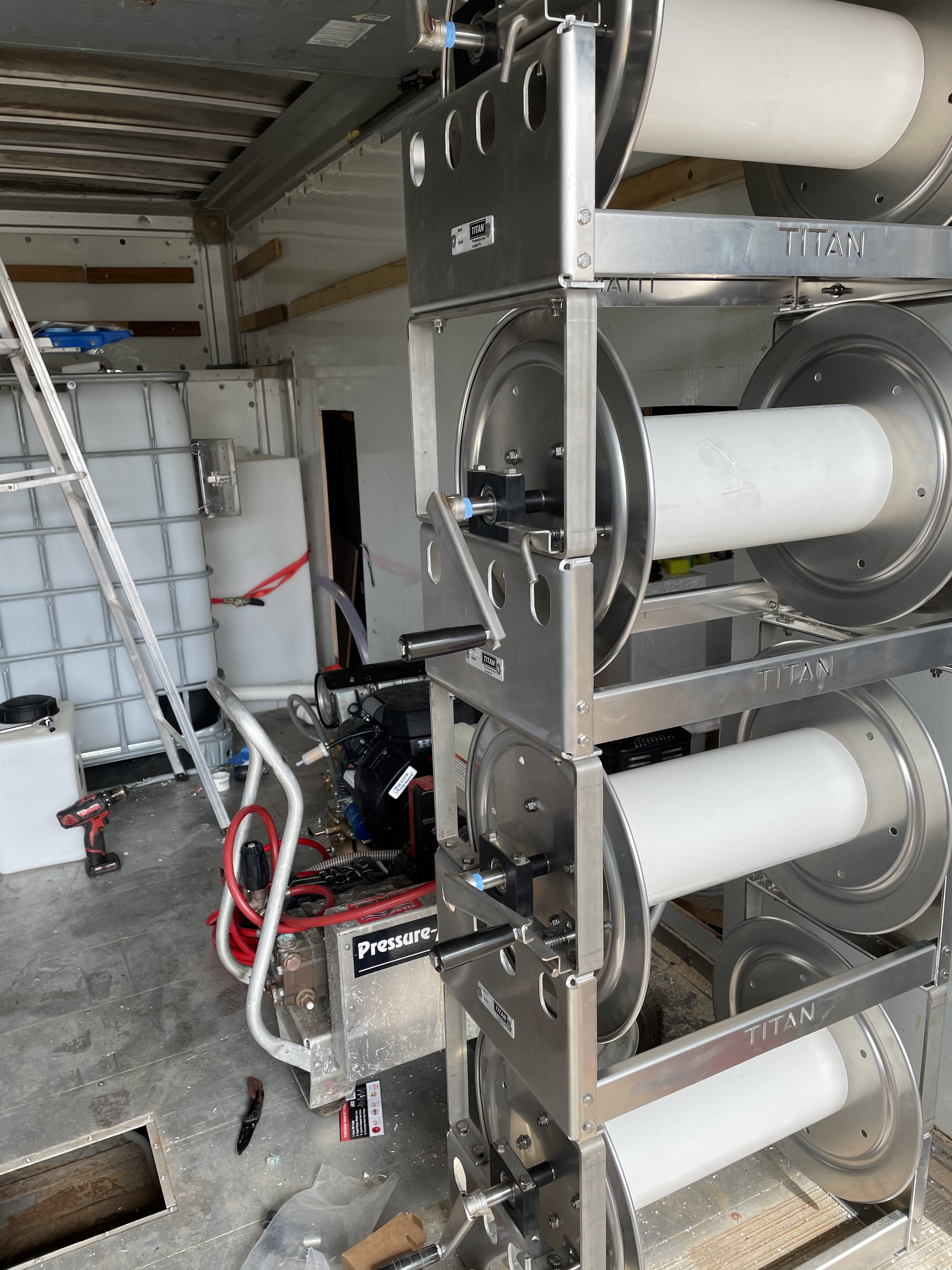

Working on building out these trucks, I’ll probably post a couple pics of my progress tomorrow. Anyone try running your pw fuel line into the truck fuel tank?? Sounds convenient and would save me a little room
@dperez does that, I believe?
Edit: or at least he used to
I sell jetters for Easy-Kleen and I recently spoke with a Mr Rooter Plumber that has his jetter’s fuel line plumbed to the van fuel tank and his machine wired to his van battery as well. So, it’s totally possible but unfortunately I don’t have any firsthand experience to help you.
You sure that’s not a return or a vent?
Oops. Didn’t see the other port on the left. If that’s what that is anyhow. Hard to tell. Looks like it has a hex plug in it
Yea there other one is for the vent

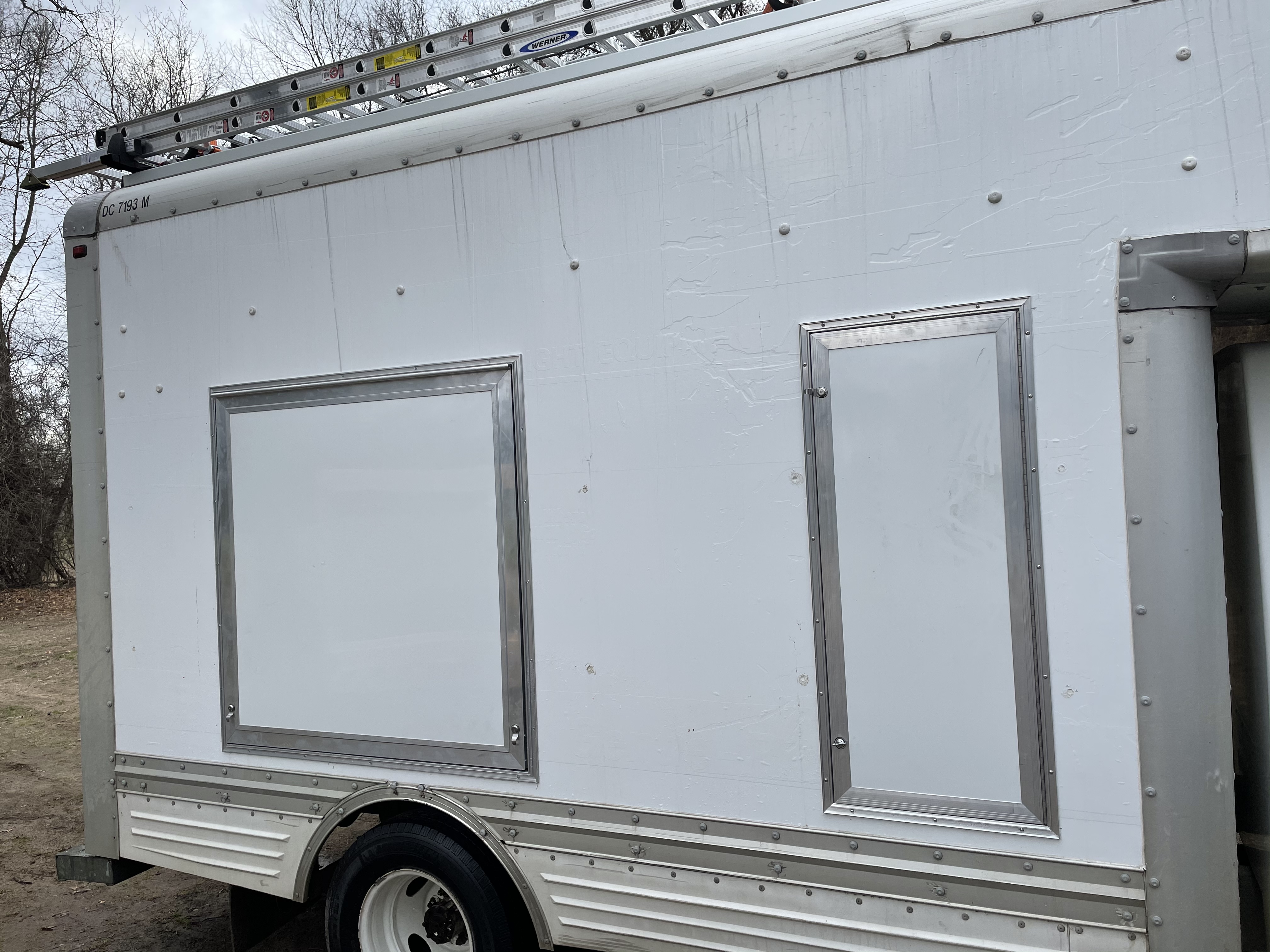

More woried about the freezing right now here in Michigan lol. But thats why we have the side doors on it and for easy access. Weve had an enclosed trailer b4 this and honestly never had a problem with it. I guess it doesn’t get as hot here
Very nice. Great job!
Nice! Not sure where you’re at in MI but I’m across from Detroit and today was a wild change in the weather… supposed to warm back up again and be really nice next week.
Looking forward to it we are just north of Detroit in Oakland county
Where did you get your side doors?
We had them made custom sized but they took about a month and a half to get them tho. Paid about $500 for both so not bad.
